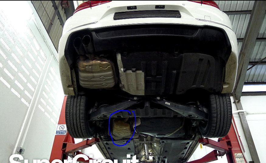

I wonder if the close proximity of the exhaust to one of the rear wheels have something to do with this.
You might have changed the resonant frequency of the car so the drone is more noticeable now. I know exhaust manufacturers are now measuring the cars acoustics and tuning the exhaust to avoid drone. But those are on the higher end of the market not flowmaster cherry bombs.

Stock exhaust?
Yes Stock exhaust. That picture is for illustration only.
Btw, the drone I'm talking about is nowhere as serious as those aftermarket setup but at certain engine rpm and at idle you can "perceive" more boominess in the cabin. You know that surround , bassy , echoish kind of sound.

Do the rear seat backs fold down? If so, is it worse with them down?
I'l try to out it back again and simulate it again, this time I'll take some noise and FFT measurement.
