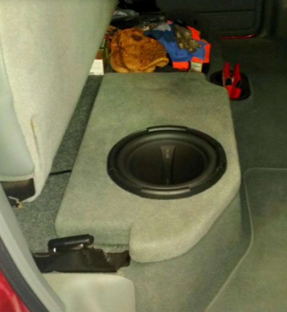

As far as the enclosure, I'll be ordering an underseat enclosure from a company called Net Audio here in Texas.  Its constructed of a fiberglass section molded to the floor and an MDF top.  They have a variety of sizes available, but the particular one I'm looking at provides 0.8 cubic feet.
They also make a slightly taller and longer enclosure that has 1.4 cubic feet of gross space which I would imagine would work well with a 12" ICON, but it puts the sub right up against the bottom of the seat so Im assuming I'd only be able to use the sub when the seat is folded up.

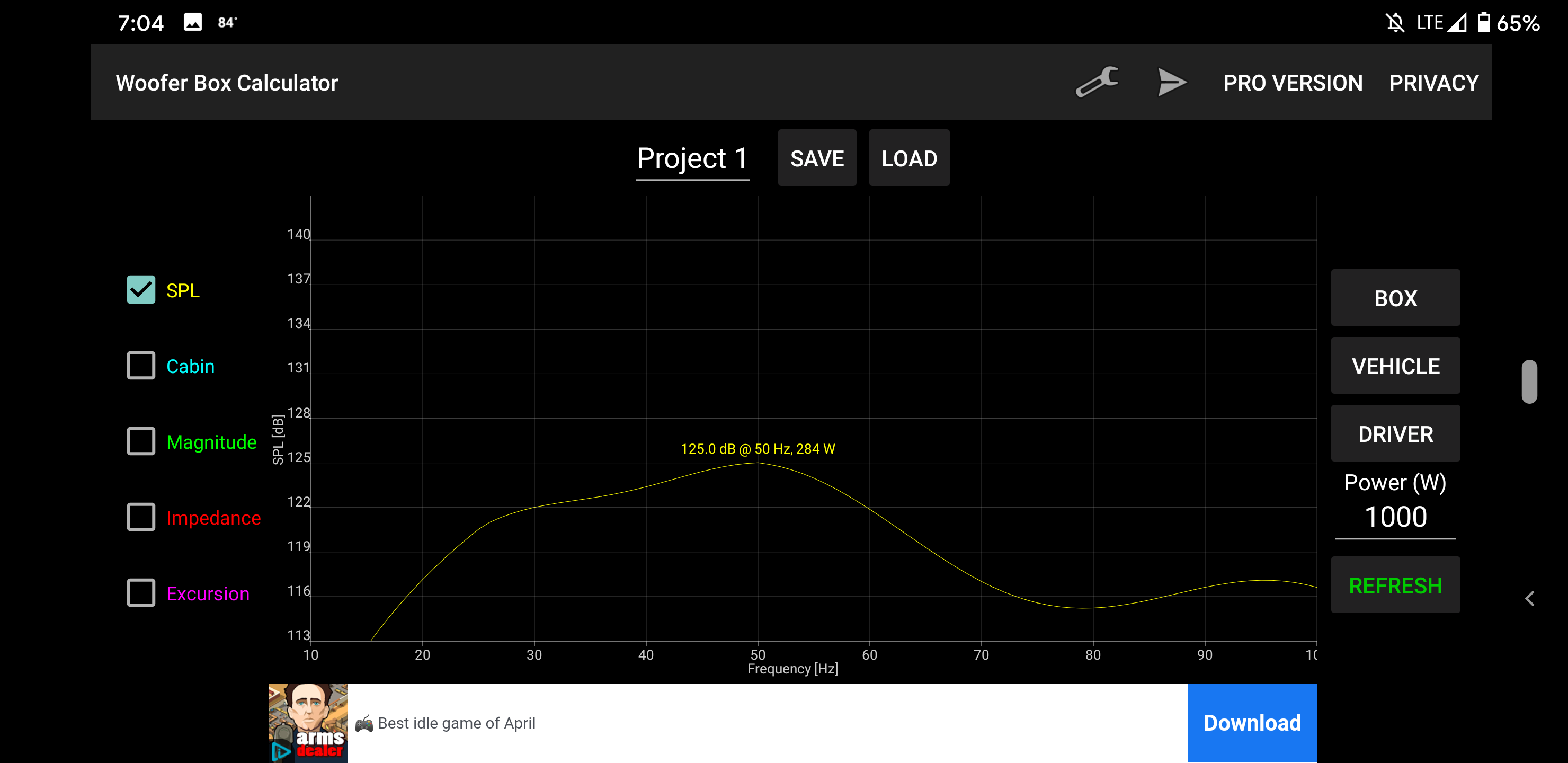

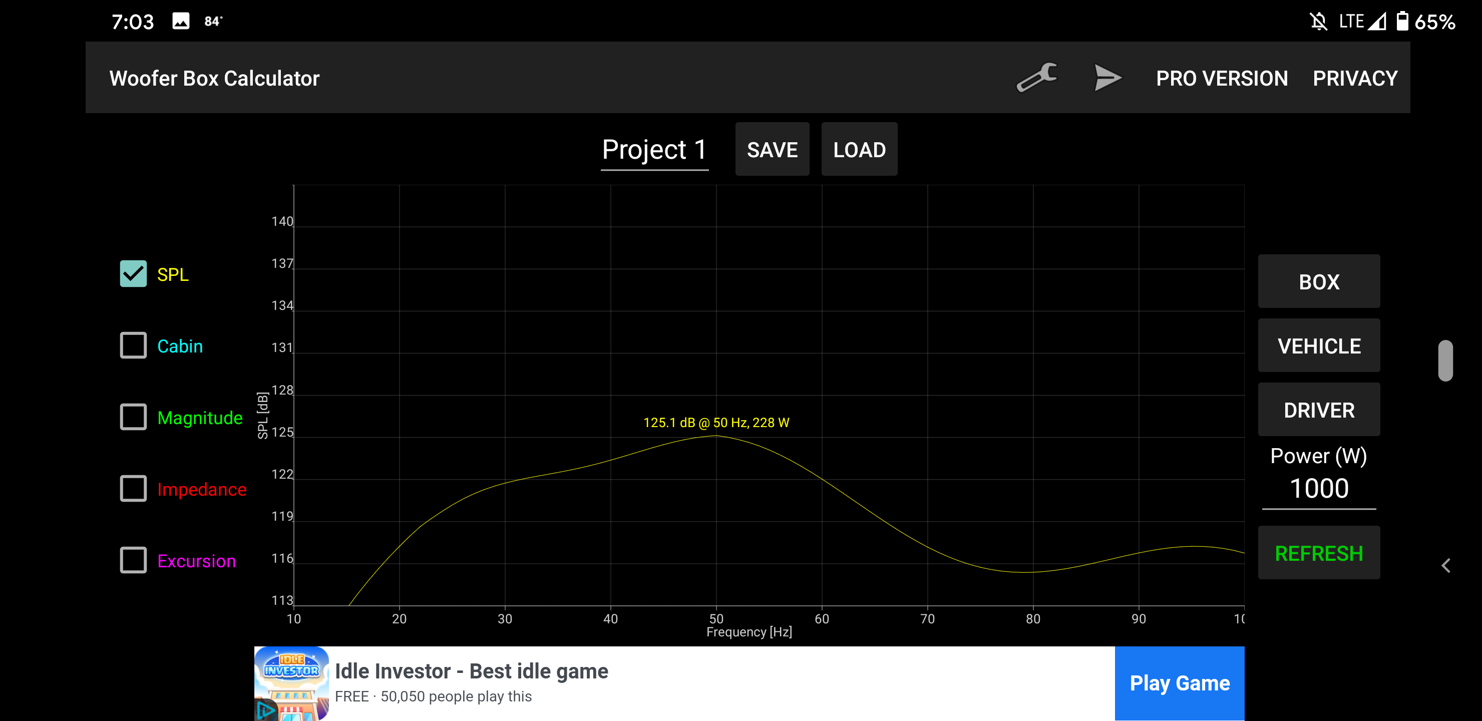

Is there an app that can do that?
Ok, found one.  To be perfectly honest I'm not really sure what I'm looking for, but here are the graphs it gave me for 0.4, 0.8 and 1.2 cubic foot boxes.

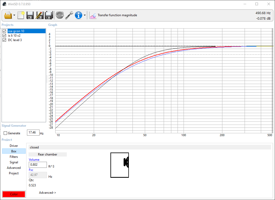

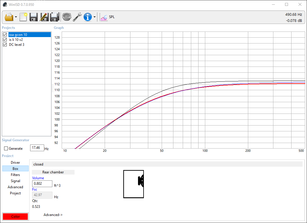

I'm kinda bored, I'll throw them in winISD real quick.

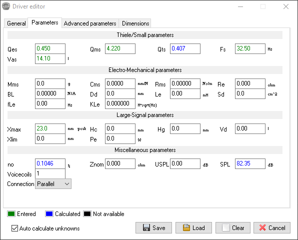

So I just threw these in winISD, I only entered t/s parameters and skipped EM and Large signal stuff, not sure if the matters. DC might have a little bit more output above 35hz but the gcon and LI can go a bit lower.
gcon is red, LI is blue, DC is black
I used 0.8 cu ft for each and 1000 watts for the spl plot.
transfer function
spl on 1kw, DC is like 1-2 dB louder over a small range. Not sure if you would hear much of a difference. Other subs can play a bit lower
TS parameters if anyone wants to double check my work
dc
IA
SSA
Thank you.  The GCON looks like my best bet out of those three.  I'd prefer the low end extension at the expense of a small increase in SPL up higher.
