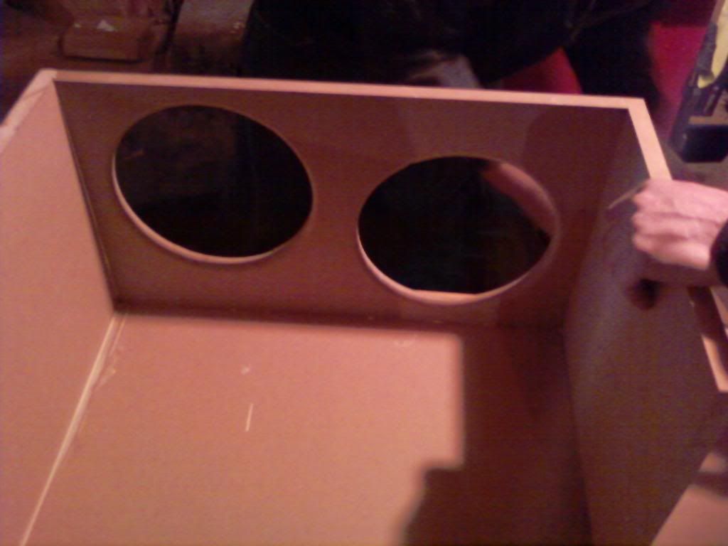

March 2, 200917 yr Author Built a new box to replace the broken one.Not finished but it should be ready by wed. to put in for testing.

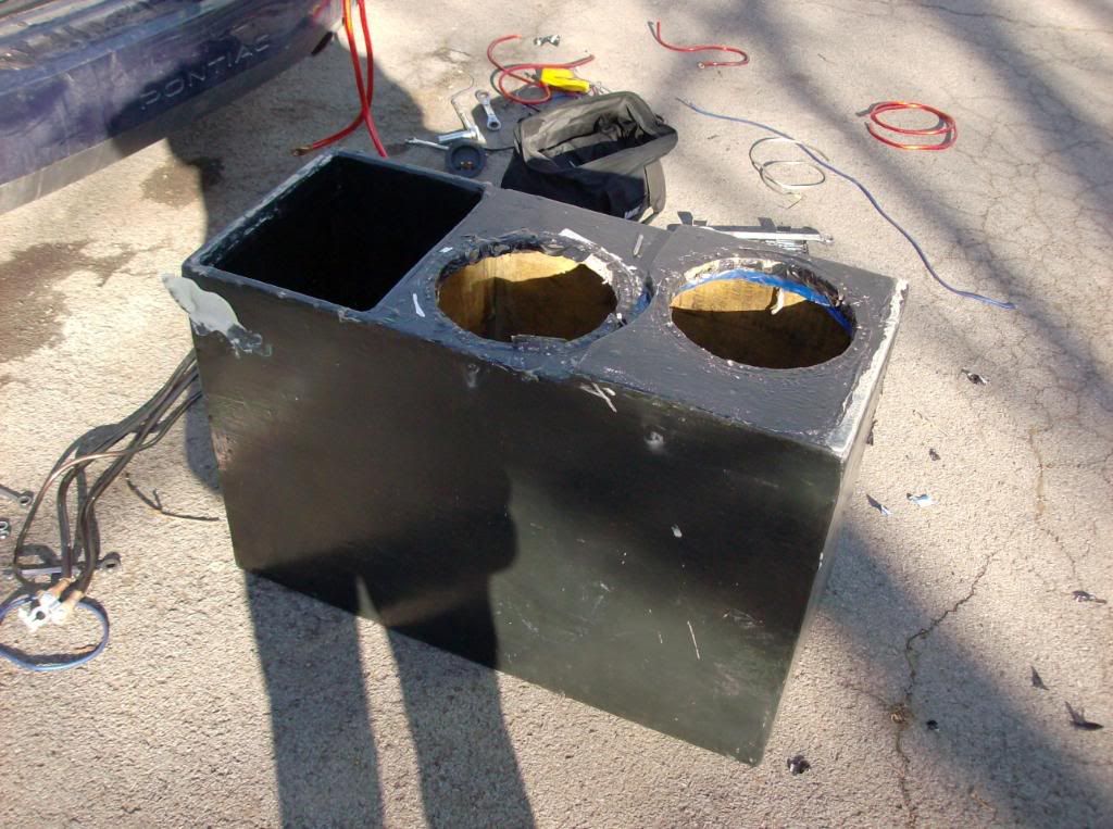

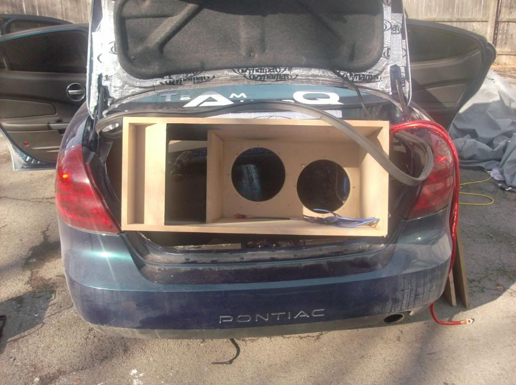

March 6, 200917 yr Author Got the box up and running and found that the subs were getiing a hot faster than they had in a long time. So I cut a longer port to shrink the common chamber like I did in the old box and it worked like a charm. What I couldnt' stand was the box flex at high volumes it was driving me crazy sooooo with no meter to do testing I decided to pull the box and resin it up!Should be ready to go back in Sat. Still have to do the inside top and top of port.

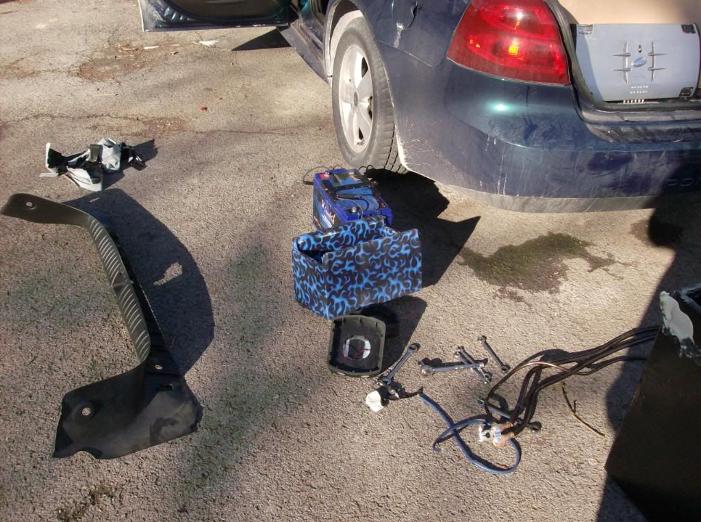

March 6, 200917 yr Author Got 2nd kinteik in the spare tire well and dynamatted the rest of my trunk.More Pics to come later
