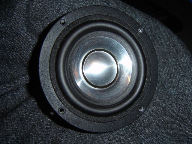

  8. Fountek FR88 EX, my system is in my sig. I can play them down to 250hz., but I seem to loose some impact from my 830946 sls's crossed that low. I keep them crossed at 315hz., they sound pretty good like that. I have 4 exodus anarchy still new in the box that may play around with, not sure how they'll sound vs. my sls's or the 8" sls you have. I mean 2 per side of the 6" vs. 1 of the 8". This is all speculation until I have the car to work with. I was mostly interested in the mini dsp and possibly the nexus 7 so I can keep the factory "stereo" and whatever I put in separate. I still have a lot of reseach to do, but I have the time.

  10. Thanks for the replies. I'm still in the planning/learning stages at this point as I don't own the car yet. It sounds as though my wide band up front may not be happy reaching as low as 250hz, if that's as high as the sls will play and still sound good. I forgot, you have a mid in your system, so you may not need/want it to play any higher. Thanks again.
