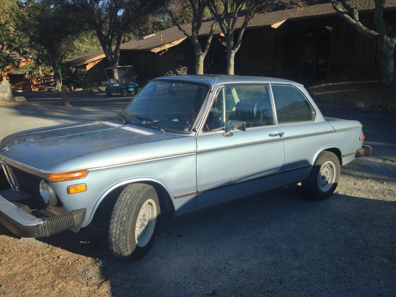

  5. Heres the only photo I have of it right now. It's a cell phone shot so kinda blah but I'll get some more tomorrow before work. It's also pretty dirty, the trials and tribulations of living on a dirt road. the second photo is of the door mounting location. I can't really see myself adding more weight than I have to so I think I'm gunna skip the deadening and allow the beast to scream if it pleases. the speakers are more for times when I'm putting around in the city or freeway driving when the noise is relatively low. I could also cut some space for some speakers in the rear deck if I wanted. Maybe some 6x9's for some midbass and the 4's up front for the detail? I don't know I'm just trying to get this thing all set up so I can just enjoy it.I also found a bolt on Bosch alternator that has an output of 85a. Is that enough to run 600w to my sub and another couple hundred for my speakers? Its a 50 amp difference from the stock alt.
