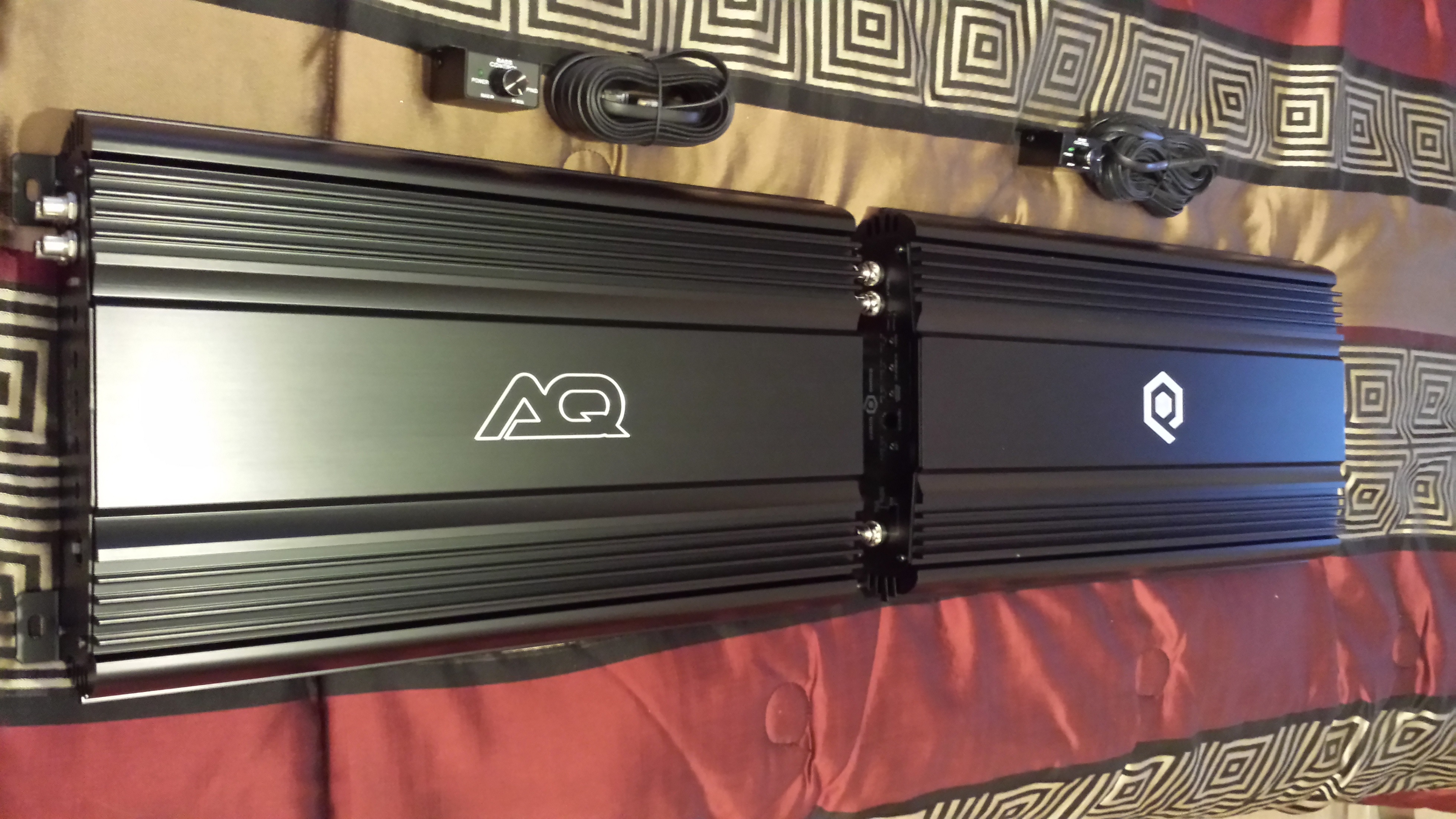

  6. Thanks for the heads up! 3 sets ordered.... just hope they arrive before Santa. BTW.... thanks for the amps. Installed them both last weekend and am totally blown away! I have friends who refuse to even get in the car to listen once they hear the doors open.
