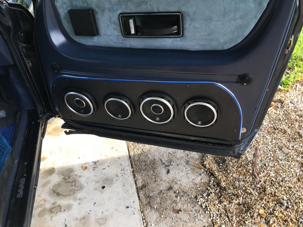

    Thank for the post J. I’ve used up my photo allowance so thanks for the photos of you car. The Alpine looks big larger than 6 3/4? I didn’t think I could fit anything bigger on that door because of the room but possibly could on the ends. That said not much is available? Would you try a 6.5 sub in a door? You mentioned having enough power The 4 speakers on the door are driven by 2 NVX amps with Polk brand on them 250 watts per channel 1000 rated watts per door. One amp for the 6 3/4 coax and on amp for the 5 3/4 component. Two identical drivers per channel wired to 2 ohms. The amps have adjustable LPF and HPF but with DSP and active crossover I don’t think it’s needed I play with it tho. The same 500 watt amp is on the dash Alpine 5 3/4 component but at 4 ohm is probably 300 watts? I play with the amp filters. 1500 watts to 10 speakers between the doors and dash. I’ve got the gains down under half but use the audio Controls DSP input output levels. I’m playing with tuning the gains down more to push the subs sooner without jacking up the sub gain The rear speakers have an 800 watt 4 channel NVX on 4 speaker and a 600 watt Alpine driving the Two JBL competition and back seat Alpine I have a 4 channel Cadence driving the Martin Logan Motion and bi amping the tweeters to the JBL competition thru it’s adjustable passive crossover The audicontrol uses the crossover in your posted article and has delays on left channel and sub. If I understand correctly distances change phase so multiple drivers can cause phase distortion. I may need to get the mic to measure frequencies separately. Be amazing if I’m actually missing something. Reading the instructions with the DSP/EQ 250 area tends to over power because of acoustic flaws and tuning to a flat graph gives a better sound. I found this added clearness. It also allowed the speakers to be driven louder. I found trying to bring that area back up a little would start to over drive the 6 and 5’s but the system felt like it needed more punch or mid bass. Playing with sub EQ I found it sounded like it is getting more of that working. Early on I had the Alpine dash and small sub that when I played wit phase would make remarkable changes. I’ve kept that in mind when adding drivers and try to evaluate but the idea that distance would create a cancellation phase shift that swapping polarity can help ill check out. Generally I don’t hear any loss of mid bass as I cycle different speakers. But more would be better I find that whatever settings work on one set helps the the others and they always sound better together. I played Pink Floyd’s Welcome to the Machine and Old rock tune with Synth Bass for someone that wanted to hear my system he got a little nervous because he felt it in his chest a lot. yes the more I do I sometimes wonder if it sounded better before? I felt it was a bit of a monster but now it’s a bigger badder Monster that plays nicely. Plays P-Qb4 incredibly try it without subs or with. Nice mids

    I’m only using quote to reply. Thanks I used sound dampening in the panels the door speakers don’t go thru the panel and the rear speakers are enclosed. Maybe I’m not producing enough bass but comments have been it doesn’t rattling of buzz. I live in Miami so It’s windows down roof open. Saab has a reputation but I’m only looking at this as methods not seen before to install upgrades to that car and how nice it is to work on. Cats are bass heads.

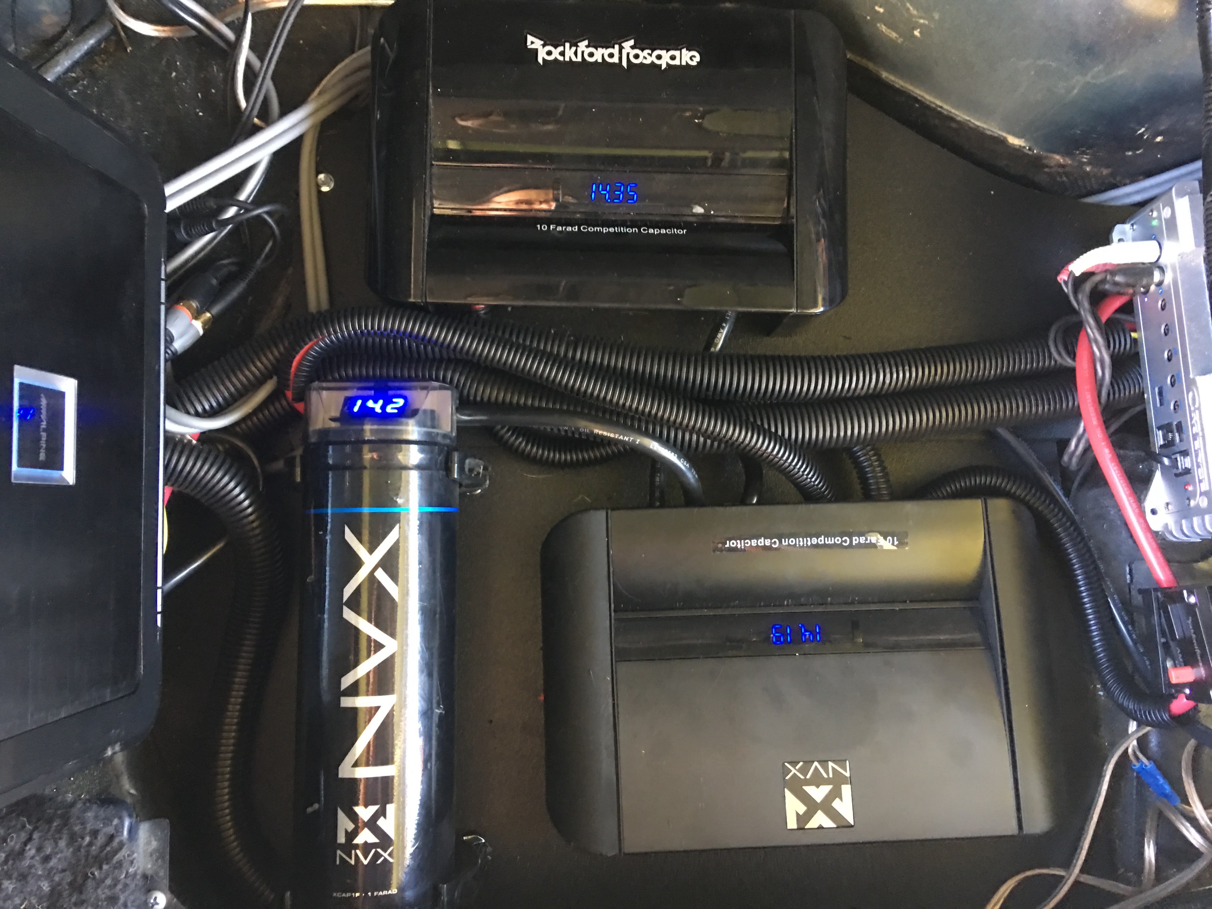

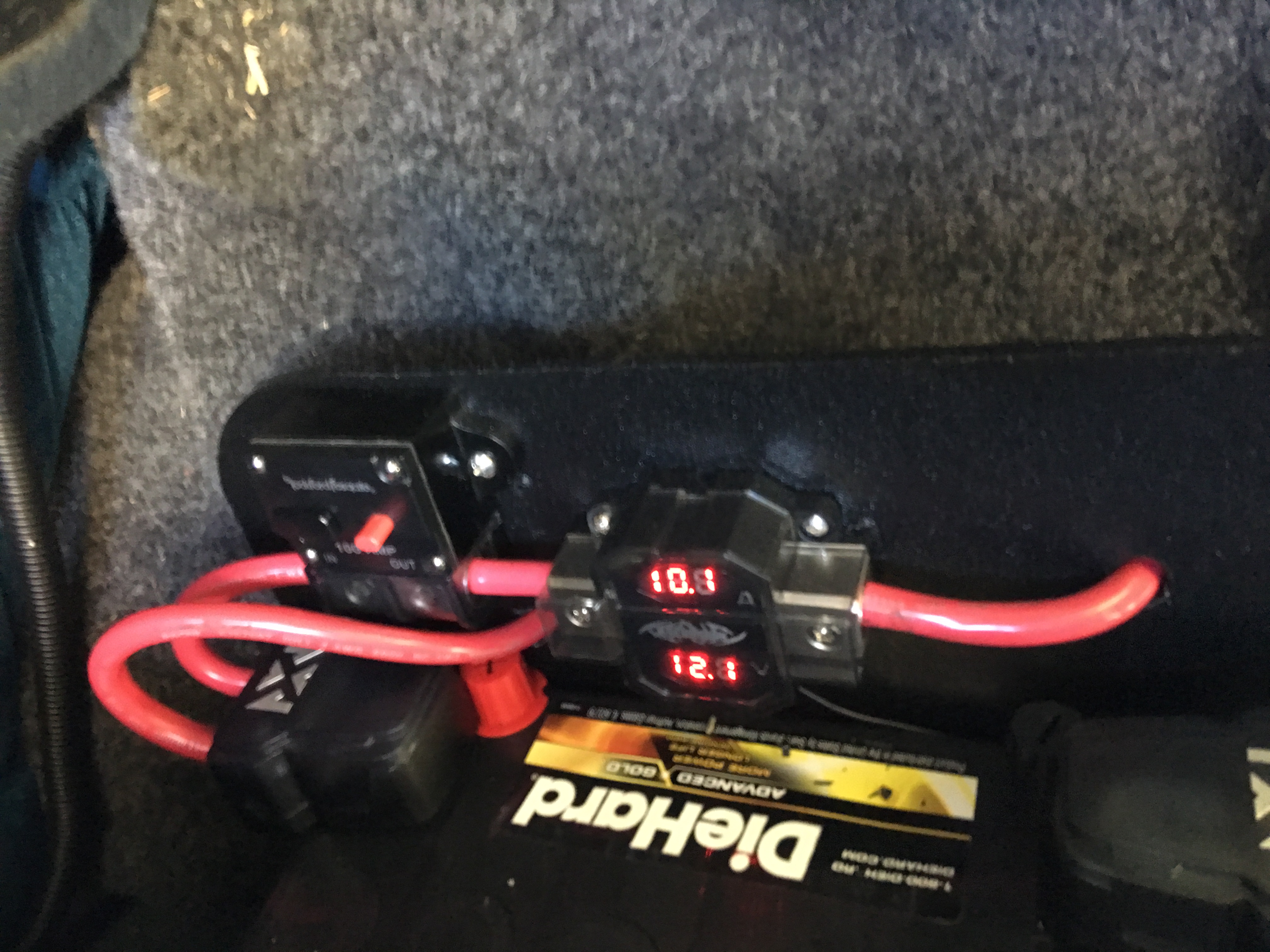

    Photo of the capacitors I have to help stabilize voltage and running a second battery

    Still could it’s a small matter if I’m motivated. I’m kind of doing that now. The amps have bypass filters but I find the active crossover and sound processor with an adjustable crossover are doing a fine job. I have one 500 watt amp per pair in the doors whenever I put bypass on it sounds fuller off. I’m running a separate amp for tweeters in the back and happy not running a separate amp on these and letting the crossover split the tweeters. I also have two pair of tweeter on the dash. The sub box fits so I’m happy. Room for two 15” Thunders a battery 7 amps sound processor 3. Capacitor drives Really don’t need 2 woofers but it does go boom. If there is a better way that fits I would try it.

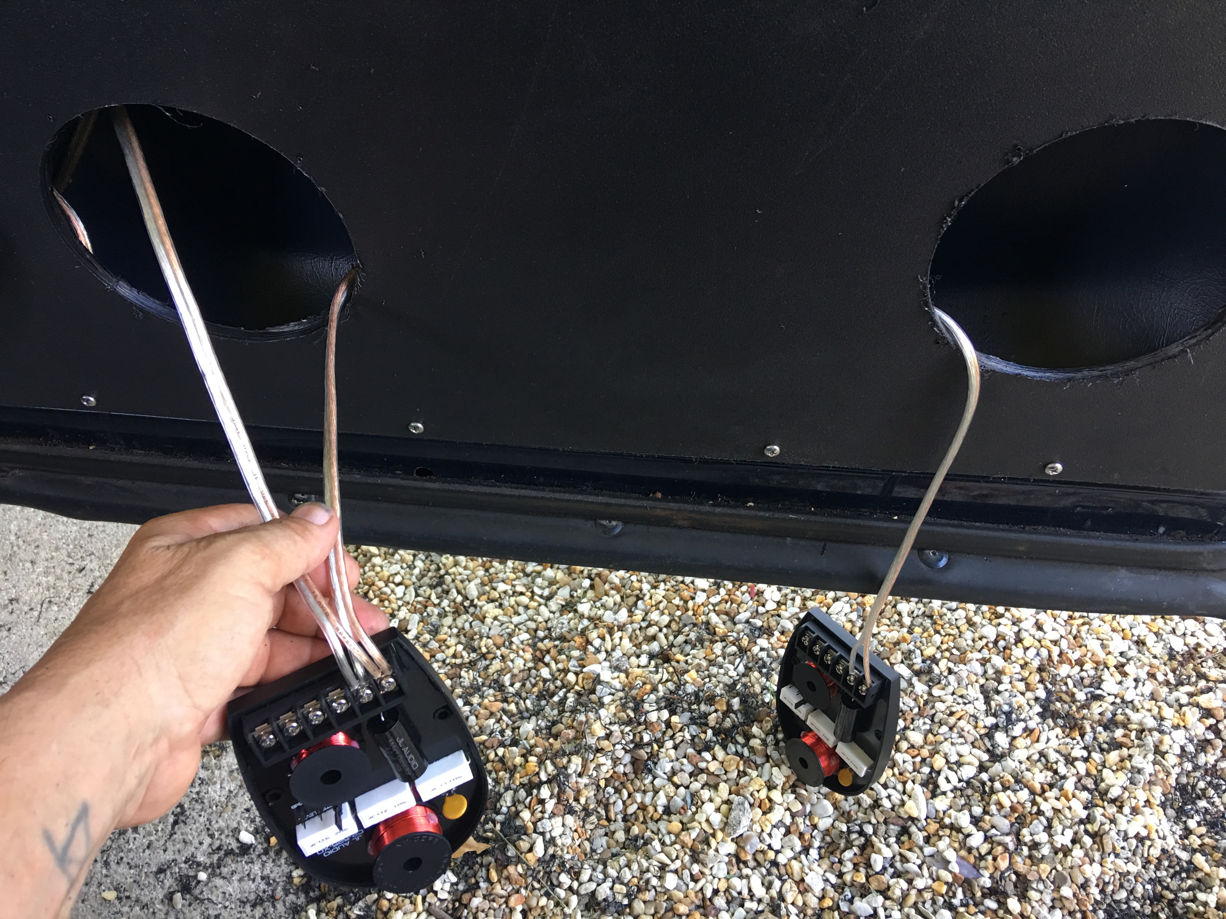

    Crossovers fitted inside more reason to mix coax in
  13. Chad L replied to Chad L's topic in Build Logs
    Same door with two coax and two component different sizes was to save space and money. Also tried just component speakers first and decided to install more speakers instead of a window to crossovers
