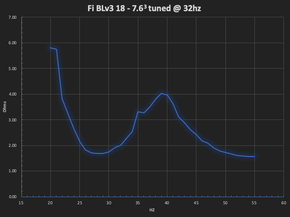

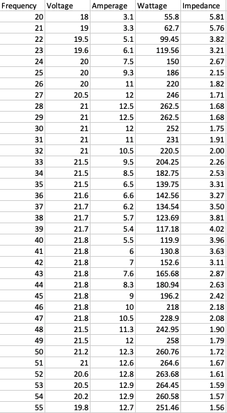

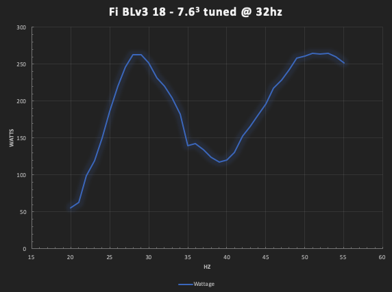

  1. Thanks Tirefryr.. that all makes sense. I've done a ton more reading over the course of today and finally had an AHA! moment. Especially regarding the data I already had from trying to find my box rise. The thing I wasn't grasping previously was the fact that yes, the coils are wired to 1ohm.. but the amp itself isn't actually seeing that low of impedance. Especially after going through the above data and running the average, which came out to 2.64ohm. It now makes sense that I can't expect to see 1 ohm power rating output from an amp that's seeing almost triple that on average.. Regardless of how cheap or expensive the amp is. So I think I've kinda learned my own answer after slowing down to read and think a little more. For what its worth though, I did stop at a buddy's house today to use his SPL Lab meter.. 140 flat from the dash on one of my favorite tunes by E40. Not a huge number... but I think mildly respectable considering the power situation?

  3. Alright guys. I picked up a Hifonics BXX2000.1D for my Fi BLv3 18. A good friend of mine has a scope, so we dialed in gains on a 0db 50hz test tone. I have the electrical to feed it. I’m able to maintain voltage at full tilt. I was reading about power and impedance rise and decided to clamp the amp and get some readings for myself. I’ll save you the time in telling me “it’s a hifonics amp, you get what you pay for... etc” I’m fully aware. I plan on going Sundown this spring with tax money. However, I’ve ran a few HF amps in the past and have been satisfied. I ran test tones at full tilt, 20hz to 55hz, measured AC voltage at speaker output terminals, and AC amperage output clamped on positive speaker lead. Wired to 1 ohm. Wrote everything down, popped into a spreadsheet, and now I’m a little concerned with the output I’m getting. Watts calculated = Amps x Volts Impedance calculated = Volts / Amps From what I understand, the rise and peaks go hand in hand accurately.. but less than 300w actual output??? Am I missing something? I understand HF doesn’t usually “rate” at RMS if ever at all.. but wtf. Can anyone offer any input? Does this sound right, is something up?
