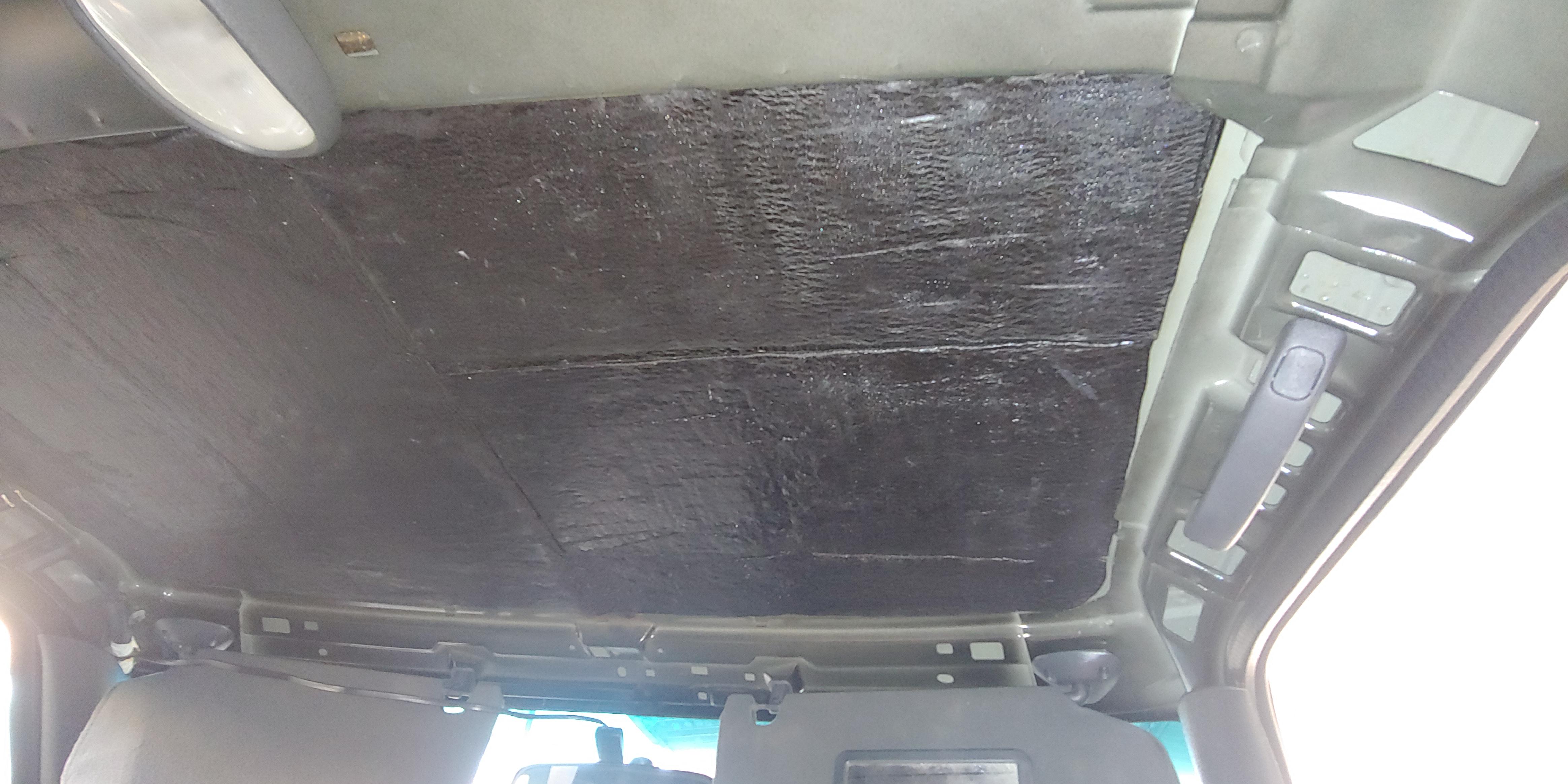

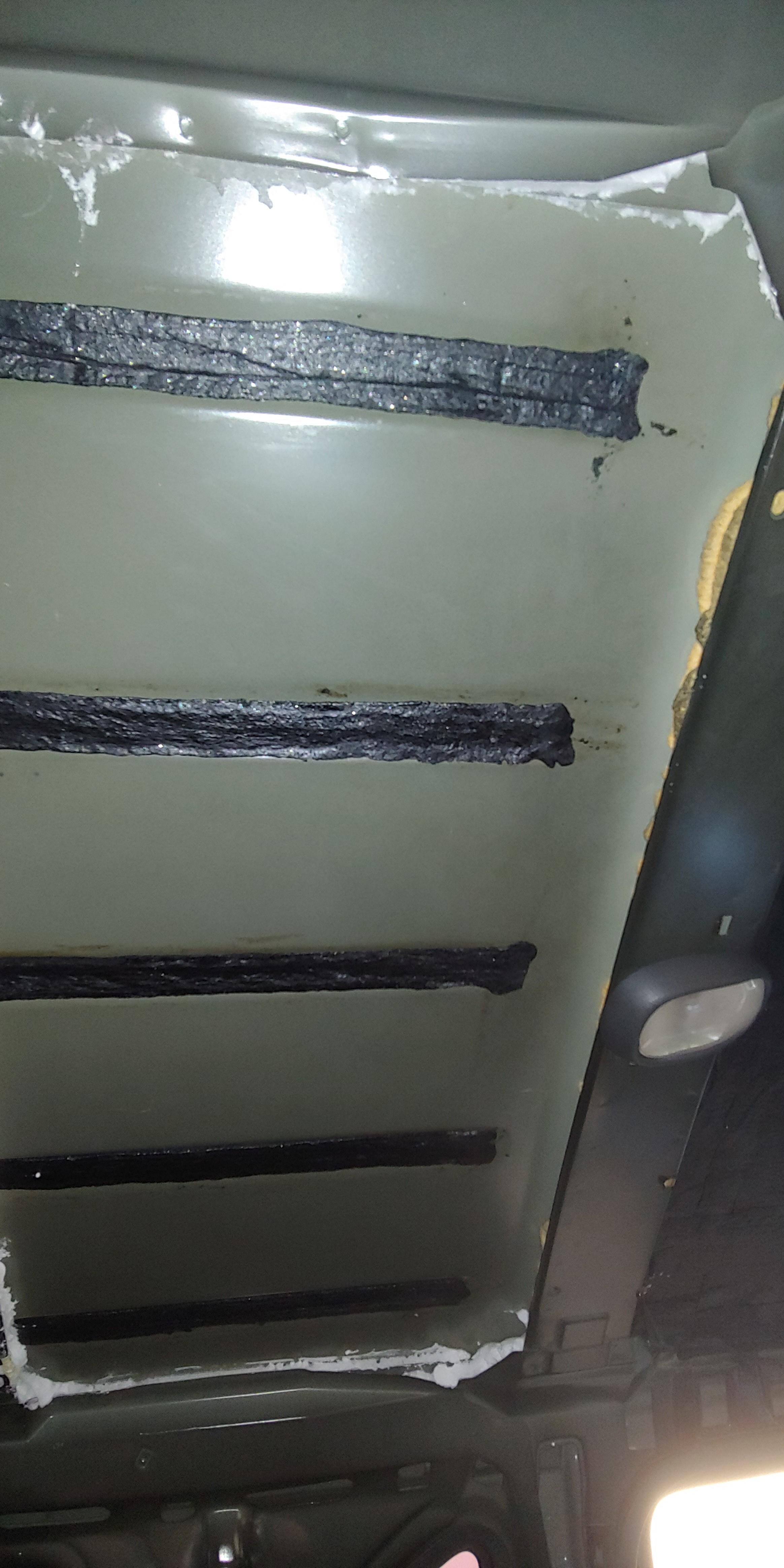

  5. the vibraflex is flush with the roof
  6. i did just the front section there , the rest i went with 1/2'' mdf , kerfed it , then used a crap load of PL3x . but before i layed up the mdf , i filled the roof channels with strips of Vibraflex

  9. anyhow , i did the front section of my 2002 2dr blazer with 2 layers of 190 mil vibraflex , cooking it on with a map gas torch , yeah not much fun when it's already 90 degrees out !
