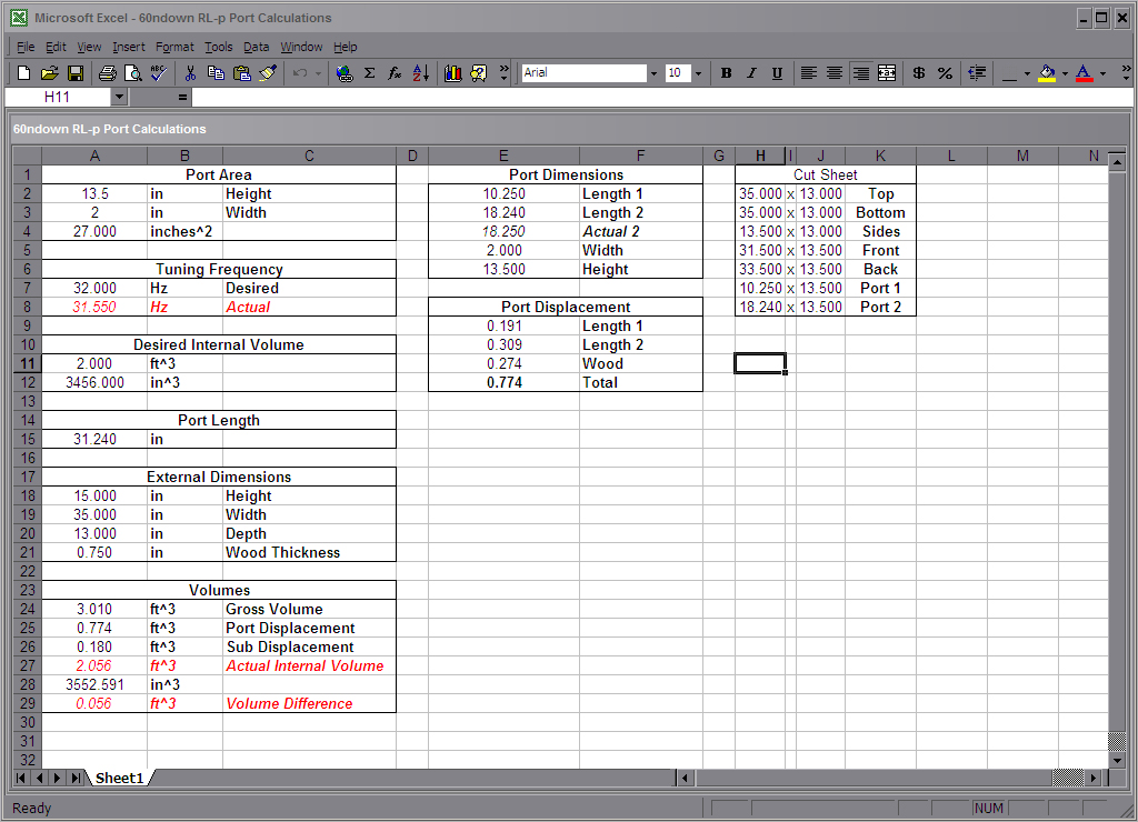

DOES THIS LOOK RIGHT FOR AN RLP-12? I HAVE NOTICED SOME discrepancy between the cut list and the calculated dimendsions? and am wondering if rest of the calcs are correct. 60ndownRL_pPortCalculations_1_.bmp- Sealed box suggestions
i'll take your, 1.7 ft^3 slot ported box tuned to 32hz.- 10 guage wire
