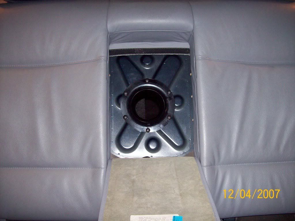

check it out i did this in about 1.5 hours yesterday afternoon at work what yall think?

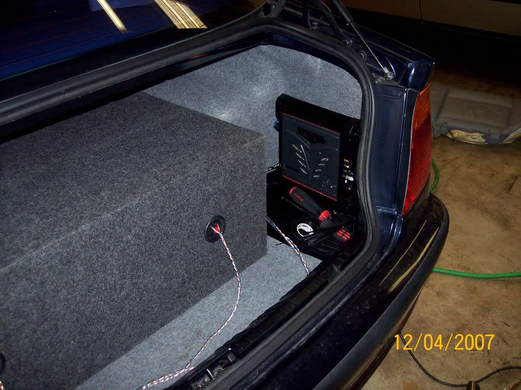

i did a kicker zx400.1 powering 2 oldschool kicker comp 4 ohms. they are in a prefab ported box (probably tuned around 38 hz :( ) but thats what the customer bought. i did the car saturday but the trunk was so sealed i needed to "port" it. no tuning just basically letting bass in the cabin. here ya guys go....

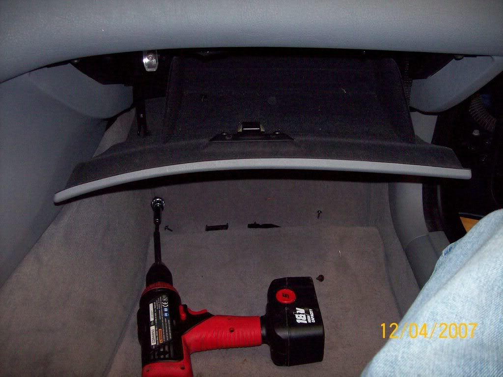

heres the bass knob install in the glovebox

m5, customer was very pleased and is actually bringing his m5 to me next week. ill have to show you it when i get threw so maybe you can get some ideas!!! we are all here to learn right?
wow, you hacked up a 02 325 BMw just to put a port in the arm rest.. Where do you work circuit city?? :)
its what the customer wanted?? thats why i am making the face with the port lol. i just do what im paid to do. if yall wanna hate the hate but gimme tips for future reference ex. m5 with the stinky face, well tell me what to improve on lol! we are all here to learn thanks!

It all depends on the goal, those cars in particular don't take well to subs in the trunk. It would help to have them rear fire...
that or replace the rear deck speakers with mini subs. Or pull out some of the trunk insulation.
If you would have covered the opening with some vinyl, it would have looked 10000000% better.

one thing though i thought that BMW's had a Ski hole to slide your skiis in. em, couldn't you just open the entire skii hole and not have to port it into the cabin like that?
is the box mounted to the floor or is it being held in place by the port?

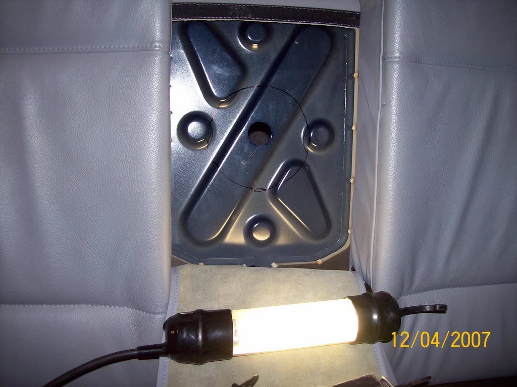

i would not trust the box being mounted to that port do to the surface the port is mounted to. if you put light behind that plate on those bmw's you can see the spaces inbetween the welds to hold it in. if you punch it hard enough you can knock it out. i knocked the one outta my dads 740il after i had a 8 mounted there because the 8 rattled it apart. 8's sound good right there. also im not sure about the skii rack thing. as far as replacing back deck with mini subs i did not do that on this one. i did it on a 740il (4 5.25's boston acoustics) turned out o.k. i guess.

or like ///m5 touched on, just removed the panel. sometimes if you give the customer a little more then what they want (in this case, a cleaner opening), you'd get even better response.

In my E46 I just knocked out the entire ski pass. It didn't have cold/weather package, but the piece is meant to be knocked out. Removing the rear speakers also yields the same results as removing the ski pass.
The red circles are what hold the piece in place. One swift kick would knock the entire piece out. But, I understand the op was just doing his job and what was asked of him.

here is a 05 745li its a friends i know, he lives in Ohio. he removed the whole piece and made a skypass for the 4th order port
and then the insulation you have to remove; this is the main reason why you see a lot of "complaints" about not able to hear bass in from trunk
