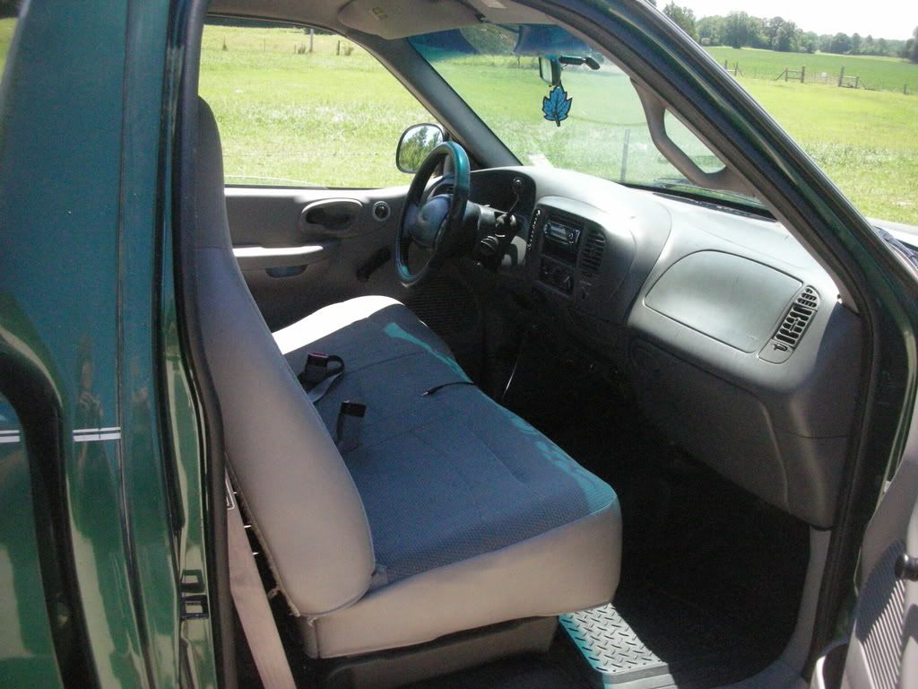

With everything in the cab in the place where they will more than likely sit.
Another view.
