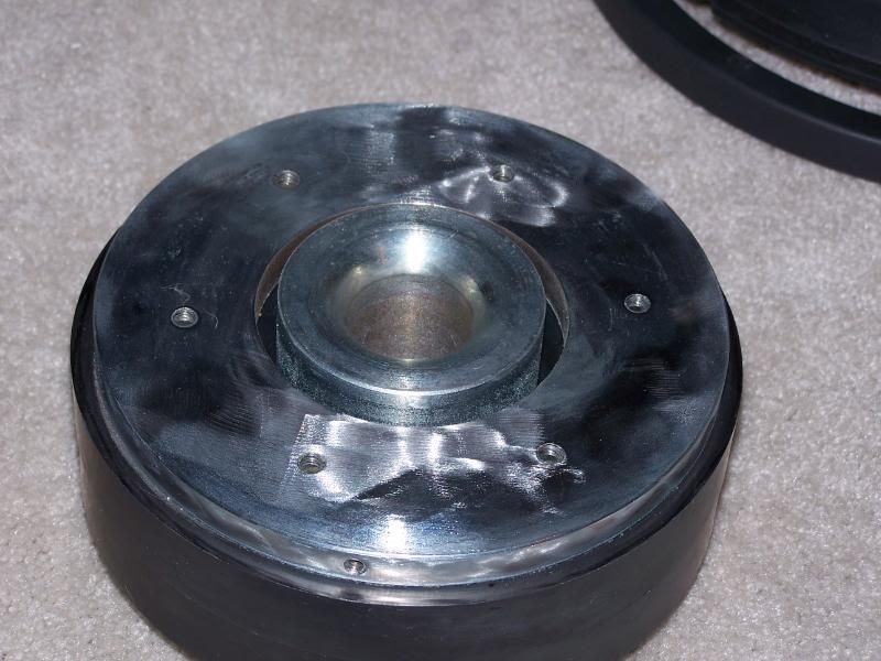

The top plate isnt threaded. Im going to upload some pics in a minute
Edited by sonikaccord
neat i never seen that top plate before but it does appear to be a standard 6 bolt pattern (never owned a 8800 series sub either lol).

The slugs are 3/4" thick and a little more than 7 1/2 inches wide.
Im guessing that I need a micrometer to measure the gap, but shouldn't it be the same as the eclipse titanium SW9122?
The extended top plate/pole piece will stick up through the bottom of a standard 12 spoke basket and give you very little room for backwards movement of the cone. That motor was designed to work with the Eclipse style basket or the ones that are used with the TC-3000/Audiopulse Axis/Lightning Audio Storm. Those have HUGE amounts of clearance below the spider landing.
You can build up some type of spacer to move your basket/motor joint even with the top plate. I had to do that with my 18" recones from Fi. They were designed to mate with my 3HP motors but I decided to use them with TC-9 motors. I used a pair of 5/8" stainless steel nuts on each of the 6 bolts. They were placed between the motor and the bottom of the basket. The width of each nut was 1/4" so a pair gave me the 1/2" clearance that I needed. I got the idea from a recone that was for sale in the Sundown section. In your case, I think the spacer may need to be a little thicker. In my quest for a spacer, I looked at everything from aluminum to MDF. I lacked the tools for creating one out of metal and MDF is great as long as it is dry. I almost went with Corian (solid surface countertop material). It is machinable like MDF and extremely strong as far as compression strength goes. It is also waterproof so that it will not absorb moisture. Finally, it is available all over Ebay with people selling scraps from kitchen and bathroom remodels.

The RL-p's use TC9 motors. They look like this. The 3HP has a much taller top plate. Yours is a little different. With a basket on it, it looks like a TC9 but the extented center of the motor makes it a 3HP.
Think about the adapter plate a little more. It will be your least expensive route to take.

The extended part of the top plate is one inch. The pole piece is another 5/8" above that.

Let's say that on a normal 3HP motor, there would be 40mm from the spider landing on the frame to the top of the pole piece. That means your xmech is 40mm or you have 40mm before your spider crashes into the pole. Now mount your motor to the same basket. Instead of an xmech of 40 mm, you would have an xmech of 11.7mm. Since 1in = 28.3mm, you are moving both the top plate and the top of the pole 1" closer to the spider landing and losing 28.3 mm of rear mechanical excursion. That's why you need a 1" adapter plate.
Buy the material and send it to me. I'll make you an adapter plate. Or you can use some spacers that are available at Lowes. They are in the nuts and bolts section called Nylon spacers. They are white but you can paint them. They look EXACTLY like this. Just make sure your bolt barely fits into the hole in them. Or get them in chromed steel.
Your bolts should be 1/4-20. With my 1/2" spacer, I used 1/4-20 x 1" stainless steel machine screws with an oval phillips head by Hillman. With your 1" spacer, you will need the same size but 1.5" long. The stainless steel bolts were more expensive but they are not very magnetic. Nice if you happen to drop one. You don't need to get a hernia pulling it off the top plate. I also used blue Loc-Tite on the threads of each bolt to make sure they will not back out.
With the spacers or an adapter plate, you can just request a standard 3HP recone kit and basket from Fi. You can have it put together in an hour and the expoxy cured in 24 hours.
