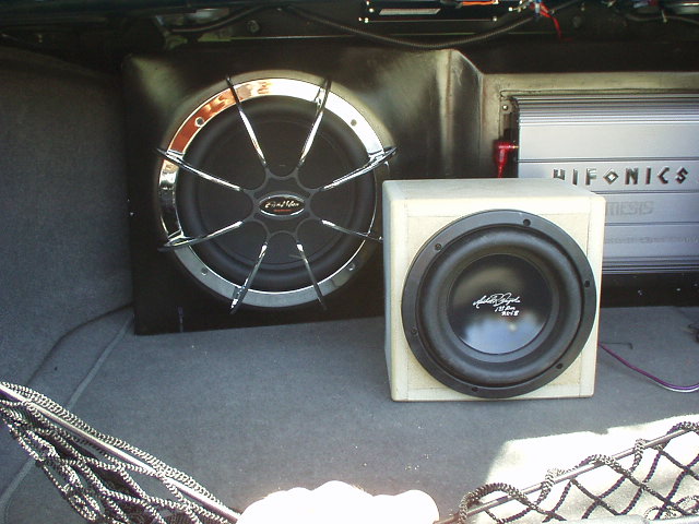

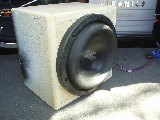

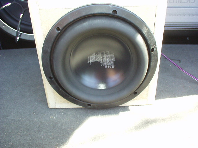

got this bad boy installed in the recommended .17ft^3. with the t/s parameters mike listed, this thing can mechanically handle 1600 wrms before exceeding xmax...thermally, well, that's a test for another day..lol.
anyway, i've got it wired for 2 ohm and running off the hifonics nx750d in my wife's car, so it's getting a rated 400wrms. and i'll say this, i think the 400 is just tickling this thing..lol. it, while moving, isn't being stressed at all. it's a cool lil sub.
musically, wow! from freak-a-leek to speaker box intro to pour some sugar on me..it just doesn't miss a beat! i do believe the box is a lil on the small side, but then again, it does a great job of getting low anyway and it does get loud! i can't wait to try it ported! but even in this lil sealed box it moves..
later, i will put a lil more power on it just to see how it does..
and with that, the pics...
and yeah, i'm too lazy to host them first..
wheeeeeeeeeeeeeeeeeeeeeeeeeeeeeeeeeeeeeeeeeeeeeeee :slayer:

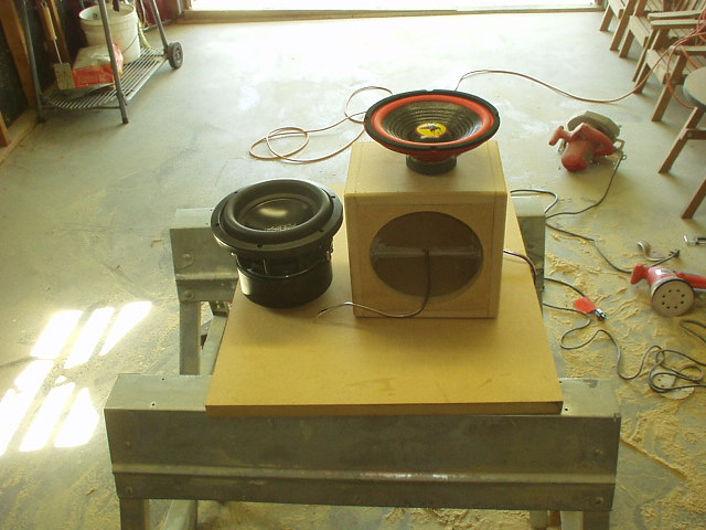

Kent, nice enclosure, did you really have to use 1" on that thing...cmon
Nice Kent! Yea the 0.17 cu ft is the smallest recommended enclosure size I'd give, but it will make for a very nice non-peaky flat frequency response until it starts rolling off. Generally, anywhere between 0.17 - 0.5 cu ft sealed on these should be great.
Ported, I still haven't had a chance to figure exactly, but the suggestion you made earlier sounds decent so I say give it a go and let us know what you think! :woot:
ok..lol..
it's 3/4" mdf. i used 1" as a table. the box is made from scraps.
tom, any suggestions as to what to play?
mike, so about .5-.75ft^3, 15in^2 of port..tuned to 38hz? going to be a big box for the port..lol.. btw..is the 8's displacement about .03ft^3? that's what i used to figure the net of the sealed one.
