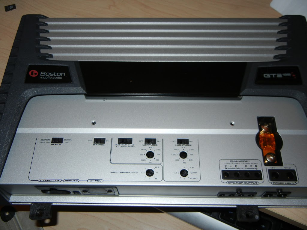

This is the crossover section for my BA amplifier... I think it should be enough to run the woofers or tweets... Let me know... :eek5wavey:
Could also repair/upgrade those crossovers rather easily....

Sorry, my reply was talking about the passive crossovers, not the crossovers on the amplifier.
