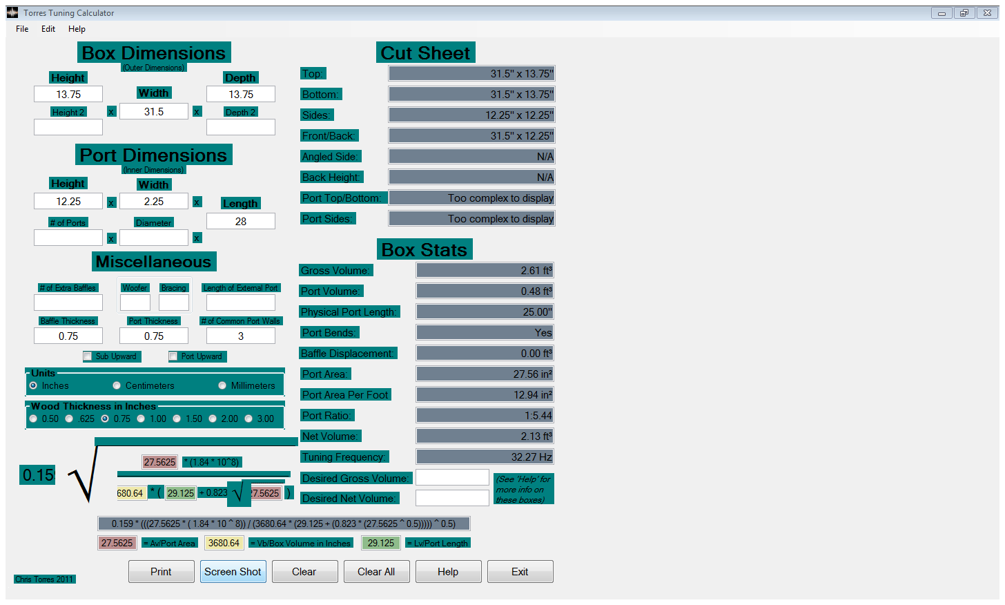

Im trying to make a box for a single 12" dcon can you guys give me your feedback and let me know what you think please? im new in building boxes this is my first and looking for it to be tuned at 32hz demensions for the box are as seen in the calculator( long story on why i chose those measurements and dont want to even explain why) let me know what you guys think please and also for my port according to this what would be the sizes of the 2 pieces of wood i would cut for it? thats only thing im confused about at this point.post-24474-0-42030600-1352860314_thumb.p

Everything looks pretty decent. Are those the MAX dimensions you can use though? The one thing I see is that it could use a bit more port area and that will require the box to be a bit larger. Otherwise, if you can't spare the room it will work fine. The only issue could be port noise.
yea those are my max demensions sadly how can i avoid port noise? without having to make the box bigger? can i just give it a bit wider port? and if i can how much wider should i make it?
If I were you I would just build it as is. Depending on where the enclosure is located and a few other factors it may not be noticeable. My sister's box doesn't have much more port area than the one you've made up and port noise isn't an issue with it. I personally would rather have the extra volume than the extra port area.
As for the board cuts, I can draw you a sketch up model and cut sheet if you'd like.

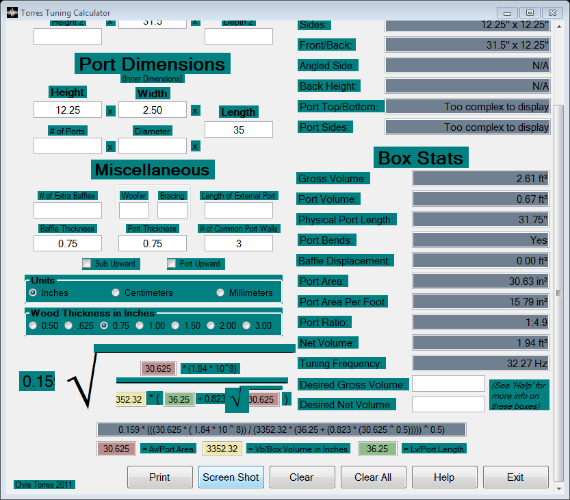

a sketch up would be awesome thanks but before you even get started what you think of this other one with a bit wider port?post-24474-0-57686200-1352866970_thumb.p
Once I started actually working through the numbers it seems something is a bit off. One thing, for certain, is that you didn't include the sub displacement. That's not a real big deal though with the small amount of displacement of the DCON it will only raise it a little over 1hz. The other issue is that what I'm seeing calculated in the Torres calc and what I'm calculating aren't jiving. It's usually really close to my calculations, but for some reason or another this time something is a fair bit off. I'm calculating more port displacement volume than the Torres calc. Generally I find where I miss a number somewhere, or fat finger one, but I've ran it quite a few times and get the exact same result. I need someone else to help verify what I'm seeing because if my numbers are correct by the time sub displacement is factored in the tuning is all the way up to 42hz, not good.
I'm seeing .6cuft displacement for the port, the Torres calc shows .48. That's for the same 28" calcualted length for the 32.27hz tuning. I did this same thing for Shogen recently and the numbers were pretty much dead on, so I'm not sure where it's going wrong at here.

I'd be glad to help you with this right after we figure out what's going on with the DCON box.
Best I can tell is that it's not accounting for the two port walls that make up the port inside the enclosure. That seems to be where the math is taking me.
From what I see, the Torres calc has not calculated it correctly and the tuning is going to be WAY off.
If I multiply .75 (wood thickness) by 12.25 (port height) by 28 (calculated length of port, not physical) I get .143cuft, that's REALLY close to the .12 difference I'm seeing between the Torres calc and my calculations.
If you could go 14.5" deep it would work with the 32.xx tuning...

OP, after running the numbers I can get 1.87cuft NET with 24.49 sqin of port area (12.25 x 2) tuned to 32.25hz inside your required dimensions. Not exactly optimal, but it's not choking it either.

Cut, but not assembled, correct? If so, you could cut another half an inch off the front, slide the first port wall out flush with the front (which would make a final 2" wide opening), as for the port you need the first wall cut to 11", then the remaining 16+ inches would make the second port wall. You'll have that 1.87cuft NET enclosure tuned to right around 32hz with the boards you've already cut.
