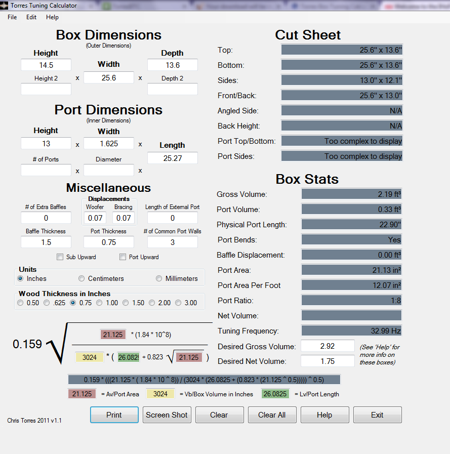

Can someone check a box I am going to be making for a customer ( can't have it fucked up).
Looks good to me brother.
Thank you, J.
I tried the Torres, but I am getting some errors. Same input as you. Can you send your version through PM, even tho it says 1.1 on both.
Thank you, J.
Try adding the Desired Volumes and see what happens.
