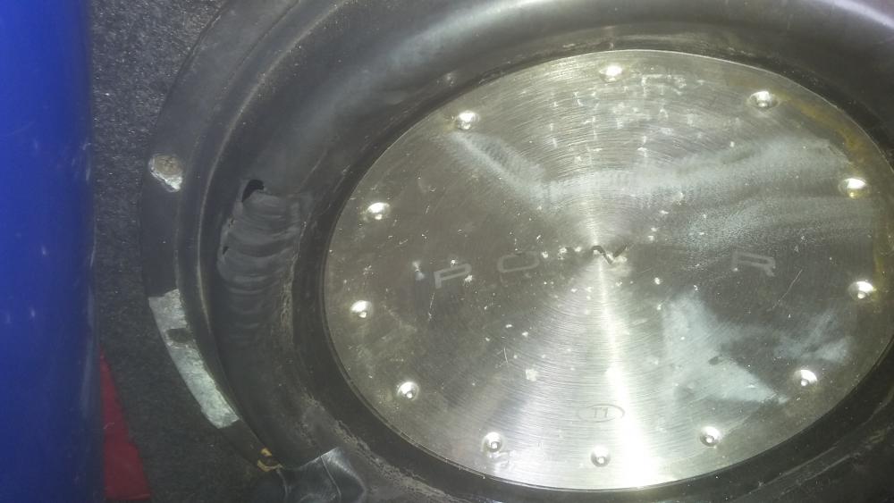

I have 2 12"  Rockford fosgate t1's....done poked a hole in one...I herd e6000 is good...a guy told me I can use an old bike inner tube and the e6000 to patch it up or the rubber off another speaker1495226360284551660527.thumb.jpg.f516fc24e7b0b37c308e844206cb4bf6.jpg
 I personally use black RTV gasket maker, and wax paper to shape until it dries.  Have done it without wax paper with good results also,  just make sure it's not too thick.  Be sure to glue it from the back side also.
