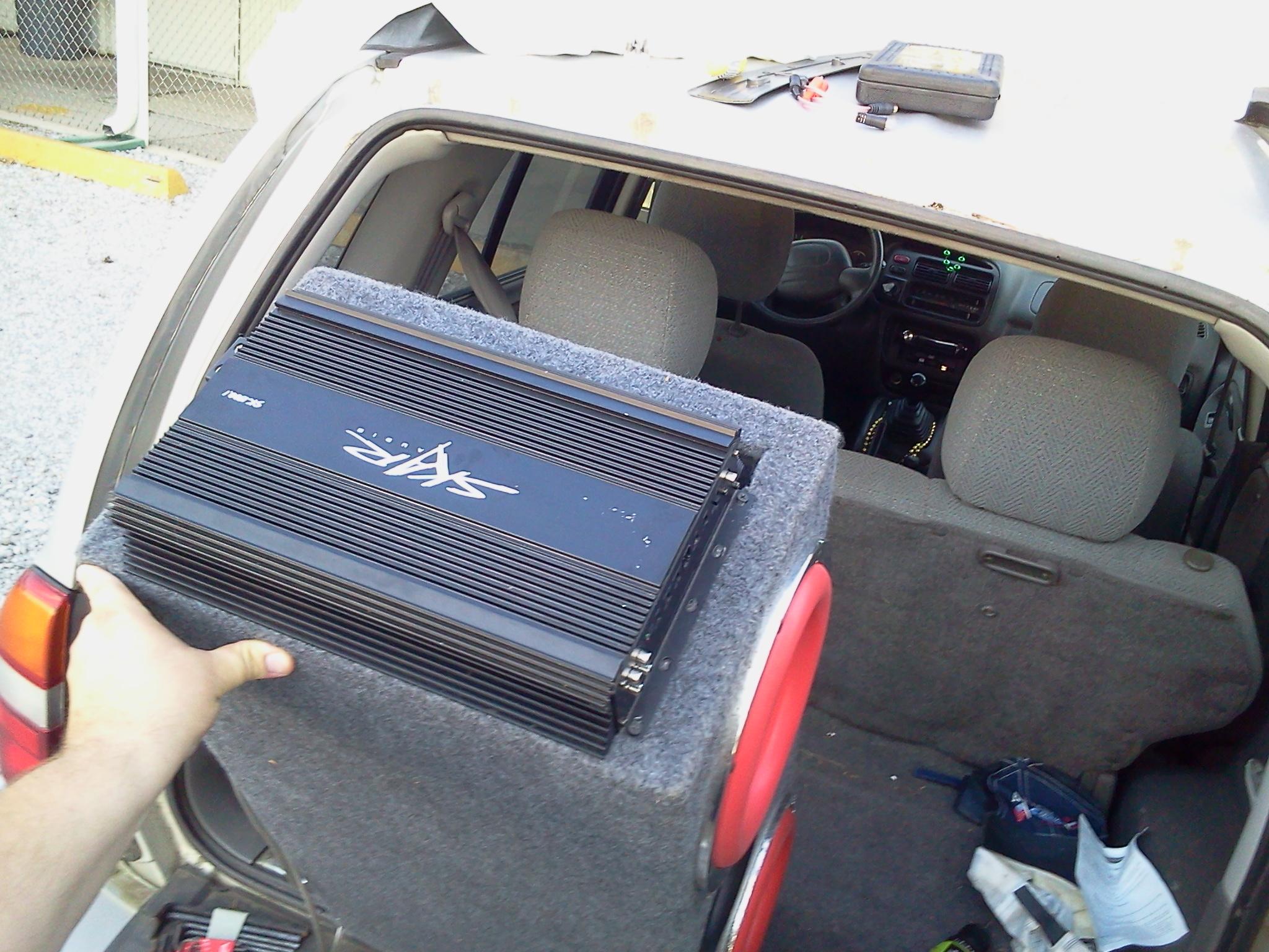

Forward to now.  Was planning to swap the GS 10's out for some SA's or Dcons, so I was on the lookout for a mono amp to drive them, and saw 'W140' selling a Skar 1500.  Not my first choice with their rep round here, but I couldn't pass up the price.  Got the Amp- installed it this week here at work. (BTW I work 7/7 here in Houma LA- Live in South Alabam).  Even on the crappy 6awg wiring, and the amp turned down, and at 2 ohms, those lil 10's woke up!  Figuring the 300w max Redlines were short for this world at 1K watts, back to looking for subs.  Well 'W140' done it again...selling a 18 Xcon D1...thinking I can buy this now and find another later to do 2 in the Burb- iwe came to an agreement, so now I have a 18" Xcon on the way!

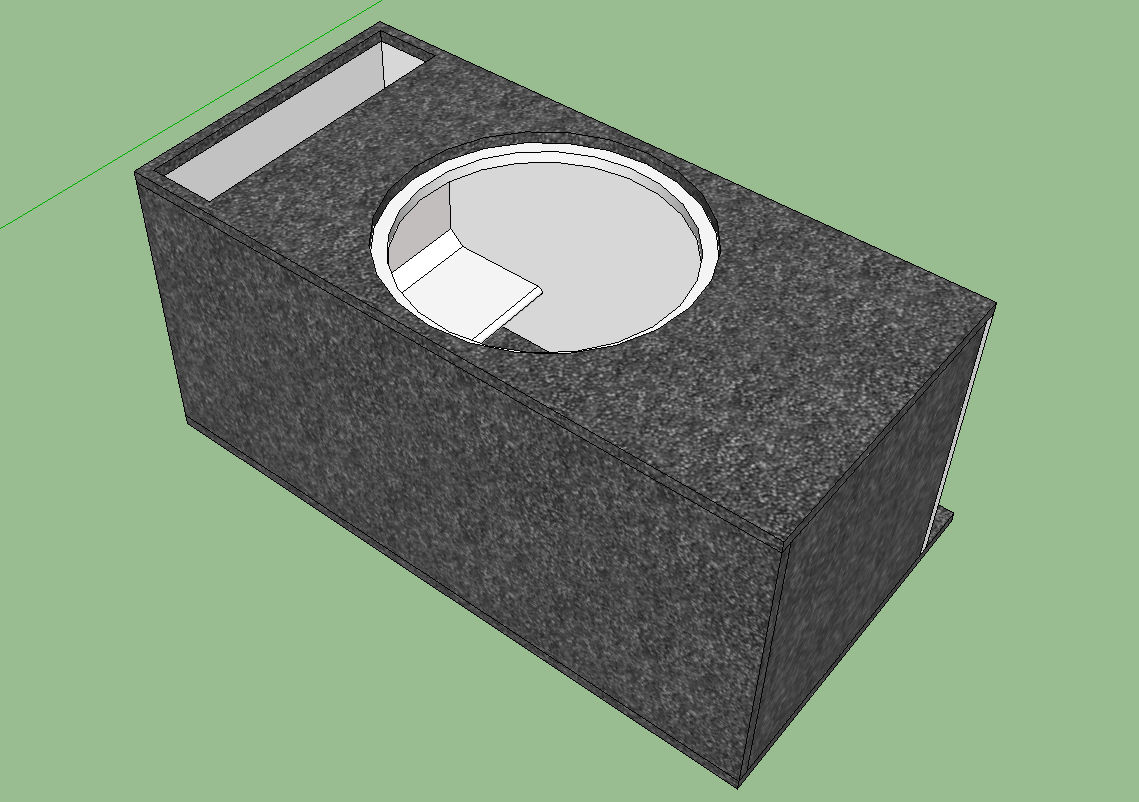

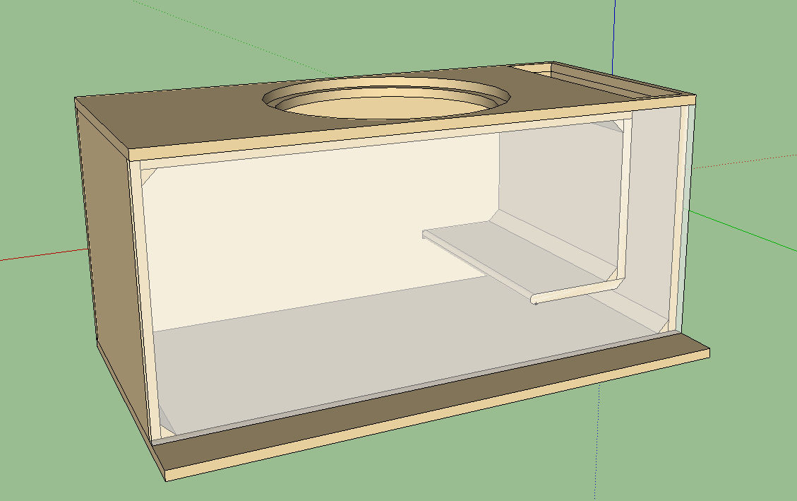

OK, so, I took measurements, and went to working with winISD and sketchup(new to both, cool stuff though) that I conned our IT guy into DL'ing onto my work computer(LOL). So, this is where I am at.  It isn't optimal- but it is ~6.5cuft, tuned to 31, ~84in of port, port is 18.5x4.5x25"long.  Gonna take the entire cargo area up to the seat back.  Going home tomorrow- Got my cut list ready for Home Depot, hopefully they'll cut the wood for me so I can fit it inside the truck.

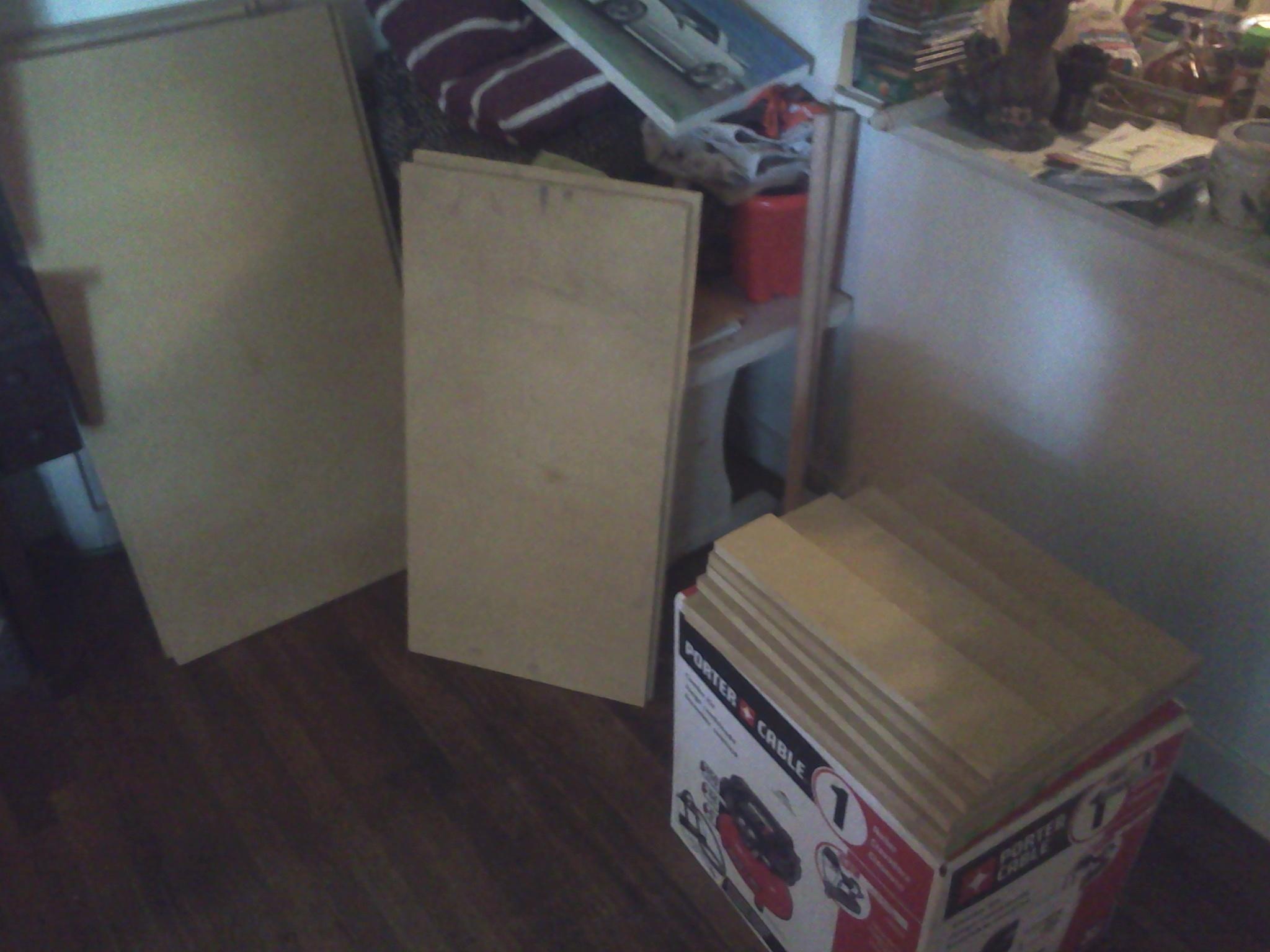

Got off work yesterday in Houma LA, went to Lowes, and they wouldn't cut the wood to spec- so I left there and went to the Home Depot down the street. and they hooked me up.  also bought a compressor brad nailer combo!
Somewhere in there a box is hiding.LOL

keep up the progress, and pics.  Glad to see you were able to get the wood cut.  Hope you checked the cuts to make sure they were on, I know all my local hardware stores won't guarantee cuts except to withing 1/4" off (and are always off even with a digital panel saw....)
Actually- while laying some stuff out tonight- they are off slightly...like the saw wasn't exactly square. But they are off to the long side(like one side is dead on, the other ~1/8-3/16 long)- I believe I can straighten them out with a router.  I am picking up a router on lend tomorrow.  So tonight I am double checking all the wood, and marking the corrections needed.  Prolly much better than if I had made the cuts myself.LOL

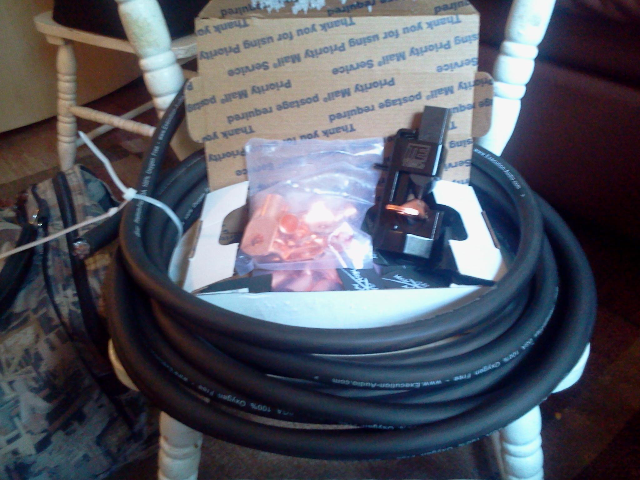

had a package from CTSounds/Audio Tecknix when I got home.  Bought some more items I need.

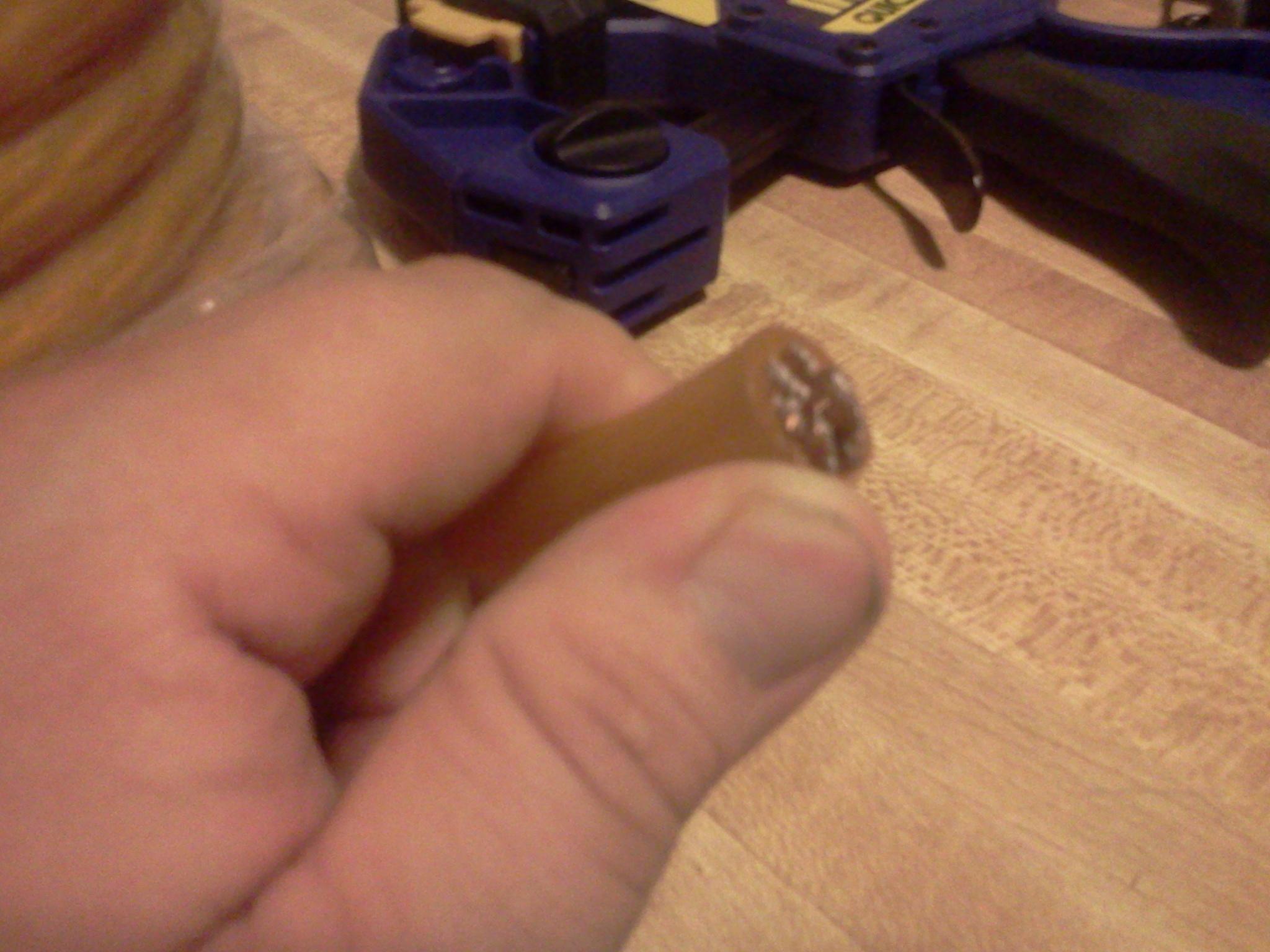

an Idea on the wire thickness.

I think I didn't give the executioner wire it proper due.  It must be true to gauge, I BARELY got it into the fuse blocks.  it is very easy to work with too....I like it.  If you don't need OFC- I highly recommend it.  I paid 70 bucks shipped for 50' of it from CTSounds.
The Sky High terminals and shrink wraps are kick ass...never spent the money to used shrink wrap...but it really cleans up the wiring.  And the lil 16 dollar hammer crimper makes good tight connections.  Maybe I'll step up to solder on my next install.
