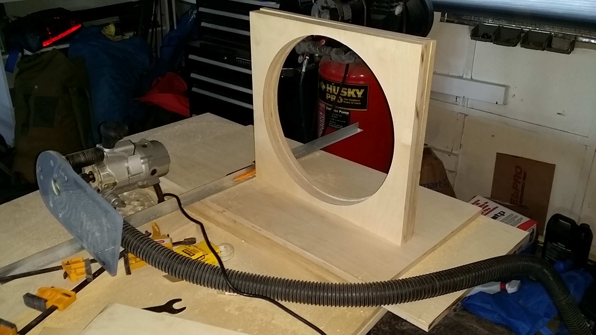

Going brace with 2" dowels and still have to cut and place corner braces. Still debating on running a full port divider down middle or a partial. Made the box a little bigger than design. 50" X 20" X 38".
Looks good man! I think you'll be happy with the birch decision.
I probably would try to avoid putting a brace in the port as it'll increase turbulence in there. Maybe just double up the side walls of the port and round over the ends.
I was worry about the rear of the port. Because they will firing into each other except in the center at rear where I will add a deflection (triangle). Double up on port walls, that will be with birch ply. Lol. I used a total of three sheets of BB for the box already.
