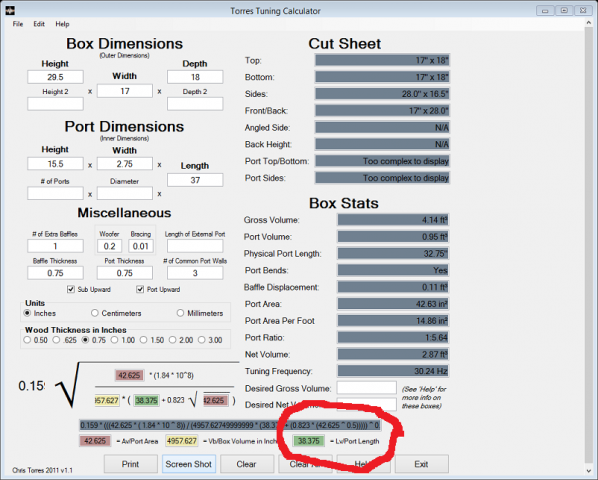

Oh god these designs are so old lol. Here's my new updated one: http://imgur.com/a/rsjTk
There's 5.5 inches between the end of the port wall on the inside and the other wall, so I would think i'd be fine. My center line down the middle is 37 inches but if I add the double baffle and the two port walls and add 1 3/8 I don't get 37.
I'm extremely confused lol.
Edited by Syphlyn
The effective (acoustical) port length is given on the bottom. You are confusing the physical port length with the effective.
holy shit! never noticed that. Wow thanks man!
