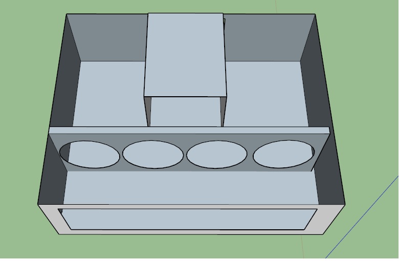

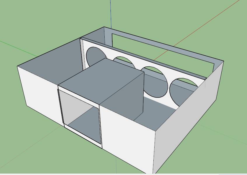

Wanting to go with (4) SA-8 V.2's in a 4th order box with a 2:1 ratio.
From what ive gathered so far on reading..
 *  Speakers facing sealed chamber(better cooling&so you can smell the coils if needed)
 * 15^3 inches of port area PER cubic feet of sealed chamber
 * The shorter the port the better
 * Ported chamber tuned to around 45-50 hz.
Here is what ive come up with on Sketchup so far.
Sketch is not to scale.
Came up with
         - 2.6^3 feet in ported chamber and...
         - 1.3^3 feet in sealed chamber.
post-7369-0-69914200-1411424157_thumb.jp
post-7369-0-43936400-1411424146_thumb.jp
Would love some input or constructive criticism/ advice and help since this is my first 4th order

Everything you described is a recipe for poor results. Its absolutely no different then walking down the street and asking someone "hey pick two numbers" "okay good i got my chamber volumes down, just gotta get a number for porr area and length and ill be good to go."
Sorry if that comes across as being harsh, but i want it to be made clear.
Where do you recommend i start then?
im lost now :?
I would use a ported enclosure and I probably wouldn't use 4 8"s for the sake of cost (2 12s would have a little more cone area and cost around half as much), but perhaps the 8s fit better in the trunk?
4th order bandpass won't offer any more output over a ported enclosure (okay it might but it'll be a tiny amount more over a limited frequency range) and it'll have have a shorter bandwidth.
As to the bullet points you made above: there is no relationship between port area and enclosure volume, there is no correct "ratio" for chamber volumes, and shortening the port length merely raises the tuning frequency--which could be good or bad, but without context is meaningless advice.
I would listen to them.
