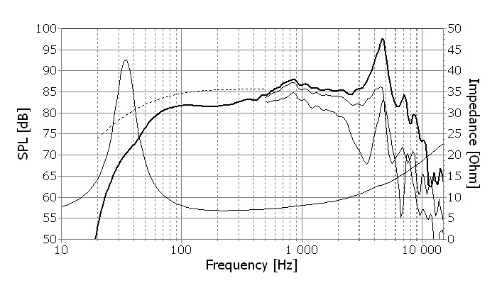

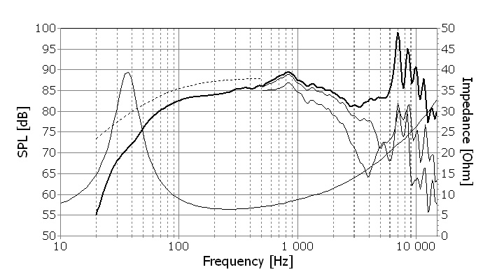

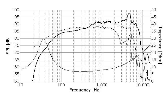

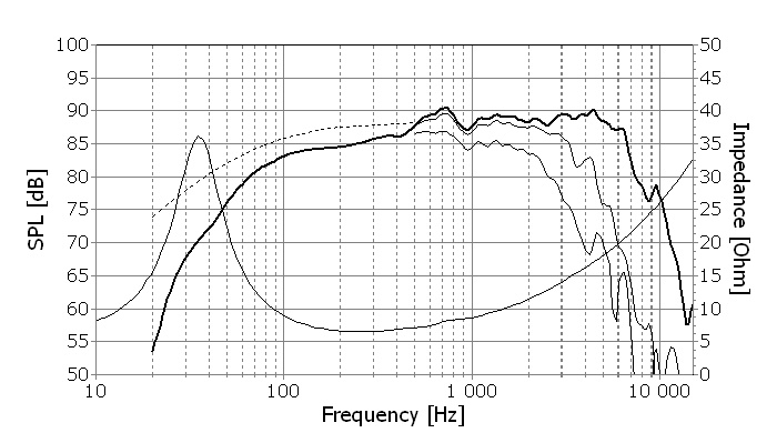

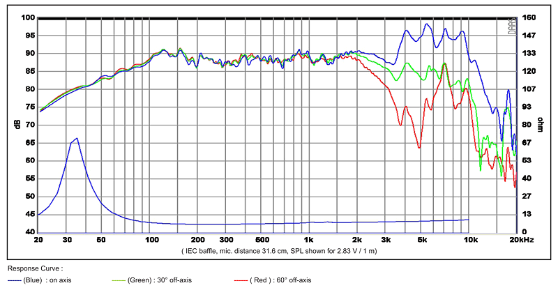

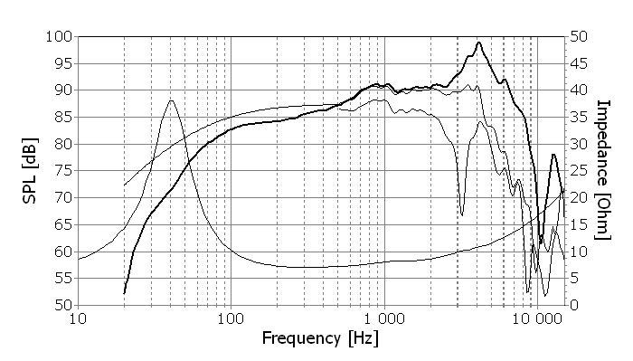

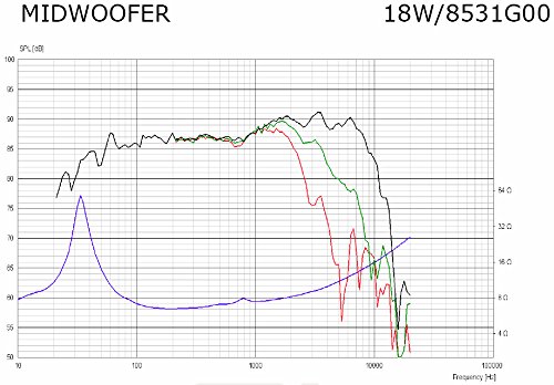

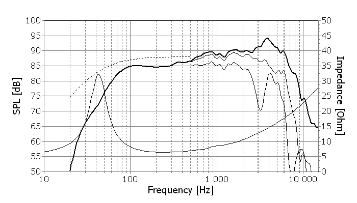

Heres the frequency response graphs. I'm still learning how to interpret these graphs fully. The Seas graphs confuse me as there is a line on them thats not on Scan-Speaks or SB's midwoofers graphs, I honestly don't know what it is or for. This is one of the reasons I need advice along with the other reasons I already stated, mainly due to imprint, but driver location needs to be correct for my listening environment as well. Last 2 graphs are the Scan-Speak tweeter and Revelator. And I just saw while on Seas website they carry a "high end Line" so they say of drivers specifically made for car audio hmm…
Graphs fixed with correct names
Seas Prestige CA18RLY 7" Paper Cone 35-3000Hz, 8 ohm
Seas Excel W18E-001 7" Magnesium Cone 40-2500Hz, 8 ohm
Seas Excel W18NX-001 7" Nextel Paper Cone 30-3000Hz, 8 ohm
SB Acoustics SB17NRXC35-8, 6.5" Coated Paper Cone Woofer - 8 ohm
SB Acoustics SB17CRC35-08 7" Woven Carbon Fiber Woofer 8 ohm
Seas Prestige ER18RNX 7" Reed/Paper Cone 45-3000Hz, 8 ohm
Seas Prestige L18RNX/P 7" Aluminum 40-2500Hz, 8 ohm
Seas Prestige CA18RNX 7" Paper Cone 45-3000Hz, 8 ohm
Seas Prestige 27TFFN/G Textile Dome Tweeter with Grill 2.5-30khz 4ohm
Scan-Speak  Illuminator’s Textile Dome D3004/6020-00, 4 ohm
Scan-Speak Revelator 18W/8531G-00 6.5" Paper Cone Woofer, 8 ohm
