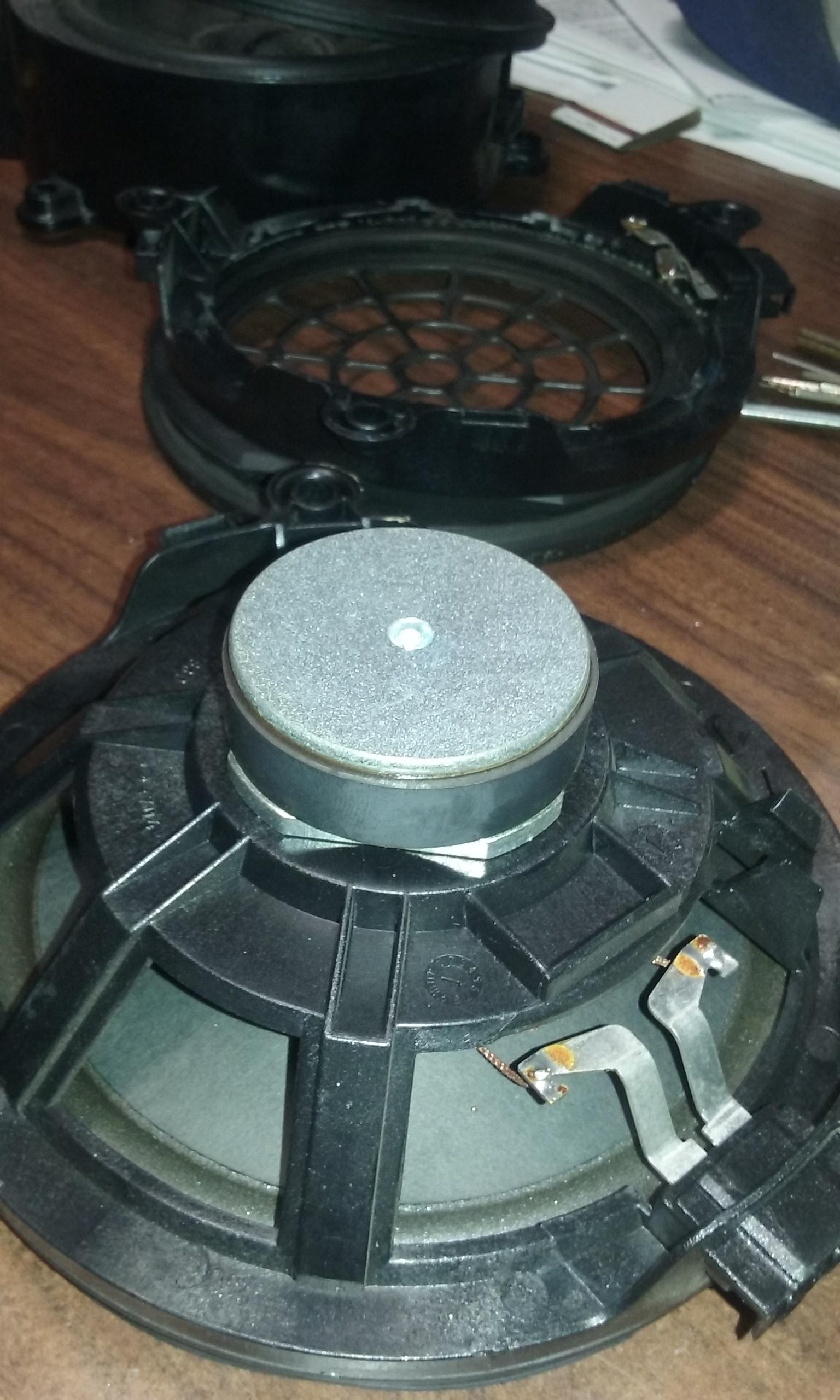

Posted May 4, 20179 yr Well bought me a Merc. Car is stupid fast 6.2L Naturally assed lol So far Pioneer 7100 Skar 4ch mid amp 4 SSA evil 6.5s Exhaust Cut Outs Alpine Tweets Soundqubed HDS300 15s Audiopipe 3k- (for now) https://drive.google.com/open?id=0BxLrfYEawFdILTJacDl2a3dlc1U Uploaded to photbucket and works now. Stock Harmon Amp getting removed Remote turn on/acc/pos/neg and speaker wires Antenna and fiber cables Front fiber cable no longer used. Fakra cable to motorola for new HU Not sure what the Tan Fakrah cable is for-satelite radio maybe? had to glue the metal radio bracket to the radio housing, otherwise it was just slopping around. Ugly on the inside, but looks fine on the outside Messy Messy, aux, dual usb, reverse cam, hdmi, front, rear, sub rca, GPS, probably missing something. Headlight film test, looks good to me need to take them out completely to make it look better. Also thinking about adding some halo chasers( i think thats what they are called) Front shelf replacement hole for wires probably going to take these out, not sure yet. Sound deadening is never ending, go some second skin, and Noix i think its called. So far have the lid rear deck, back seat and front doors done. Nitto White wall stickers. Probably what i get the most compliments on because people think they are the actual tire More deadner Xbox 360, need a new power converter because it sounds like crapola. Guess i need a full sine power converter Had to step on the magnets to get the glue to release on these, also you need to snip the connector. Custom fit, had to dremel the tweet housing a bet to get them to snap in Perfect placing , i just screwed it down Passenger door same thing. Got a star off of a newer benz and it is a little bigger, this project turned into a week long so far project that was unexpected lol. At first just took that ring out and it still didn't fit. Relief cut still didn't fit. Cut in half, used the new star to see what i needed. Metal tape to hold it, then some glass. Decided to change the to some mesh as well, going to paint it all black to match the car. Us Amps amp i have is pretty old can see corrosion and stuff, it started acting weird and cutting in and out. This Skar amp was pretty cheap, it seems pretty well built as well. Added rca and power noise isolator. Was getting some static from the radio. Also pioneer is known for the blown pico. Need another small amp for the front and rear shelf speakers. Sanding, putty, sanding putty, sanding, putty uggghhhhh. Hope it turns out good. Just got it primered tonight so have to sand that down and re primer probably. Still need to build sub box, and figure out what the deal is with my alternator or battery. I rarely goes past 14v and drops with just the 4ch amp, but is supposed to be a 180A alt. Edited May 5, 20179 yr by djjdnap

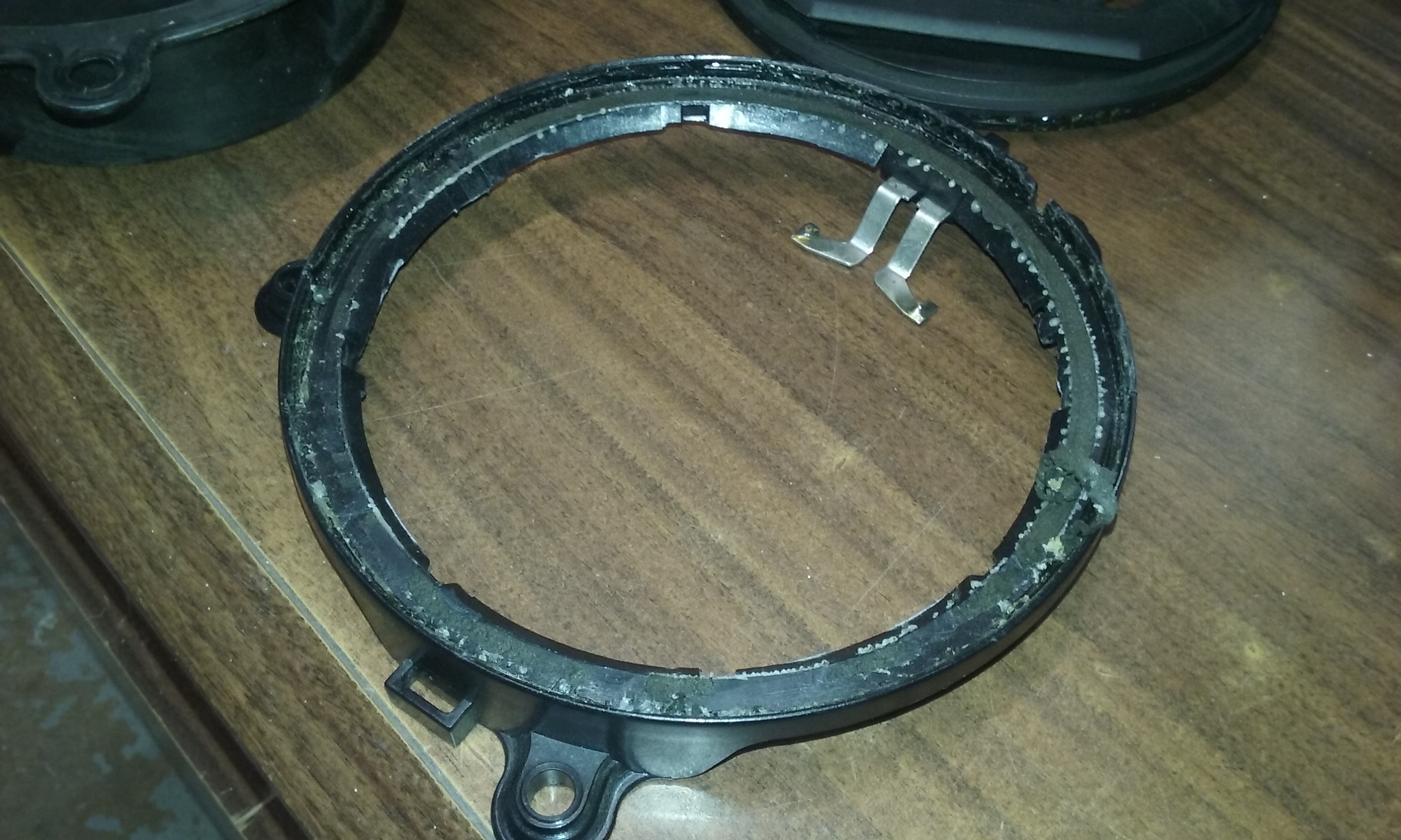

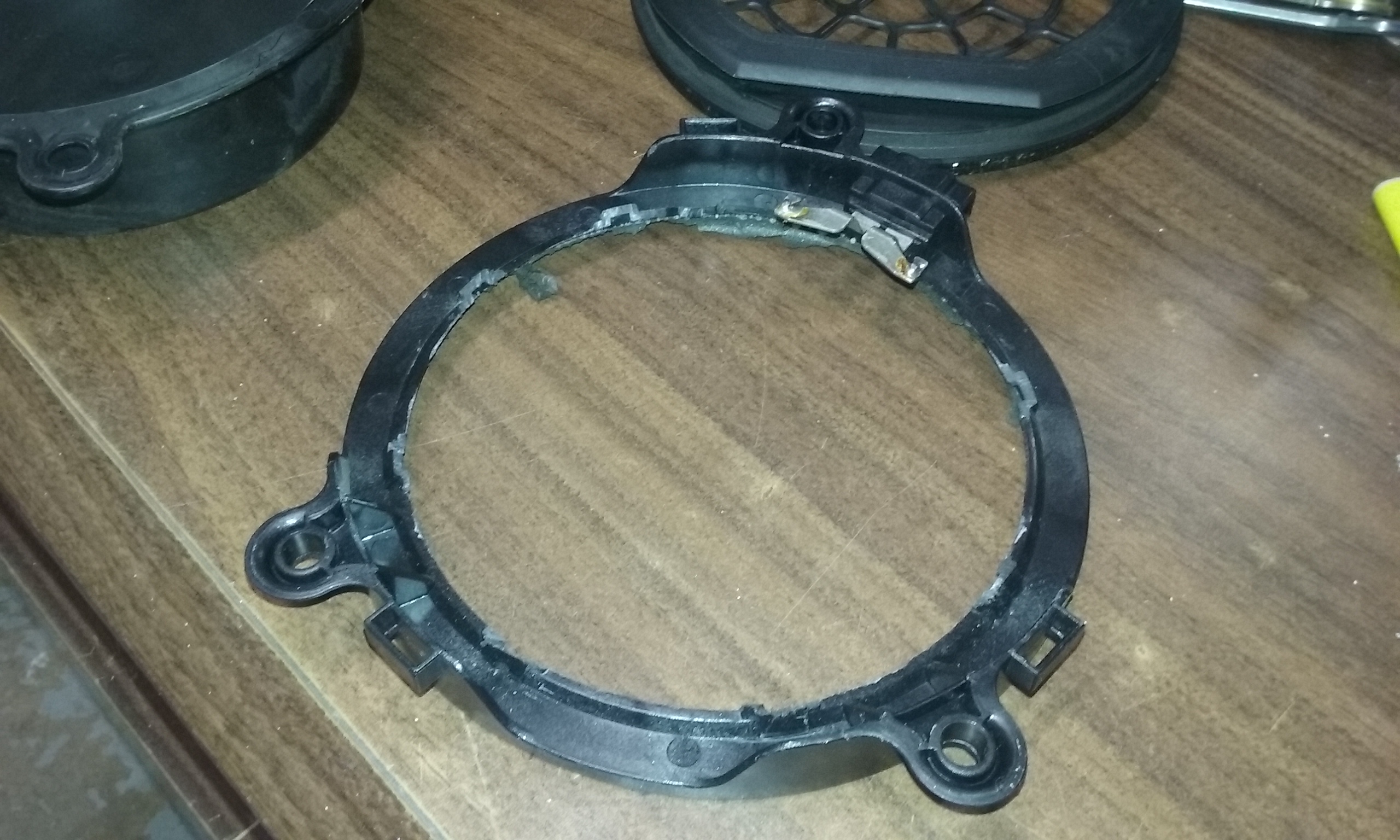

May 17, 20179 yr On 5/4/2017 at 0:33 AM, djjdnap said: I forgot to ask how you attached the new mids on the old plastic rings. It looked like it had mounting holes on the old speaker? Mine was glued on as well but the speaker was made into the mounting ring. I just snipped off the basket and removed the speaker from the back. I dont have any holes tho to mount a new mid. The ring has about 3/8" lip. Ok to mount the mid to that?
November 1, 20179 yr Author On 5/17/2017 at 12:31 AM, bigrank916 said: I forgot to ask how you attached the new mids on the old plastic rings. It looked like it had mounting holes on the old speaker? Mine was glued on as well but the speaker was made into the mounting ring. I just snipped off the basket and removed the speaker from the back. I dont have any holes tho to mount a new mid. The ring has about 3/8" lip. Ok to mount the mid to that? late as hell lol, yours are a bit different than mines it looks like.
