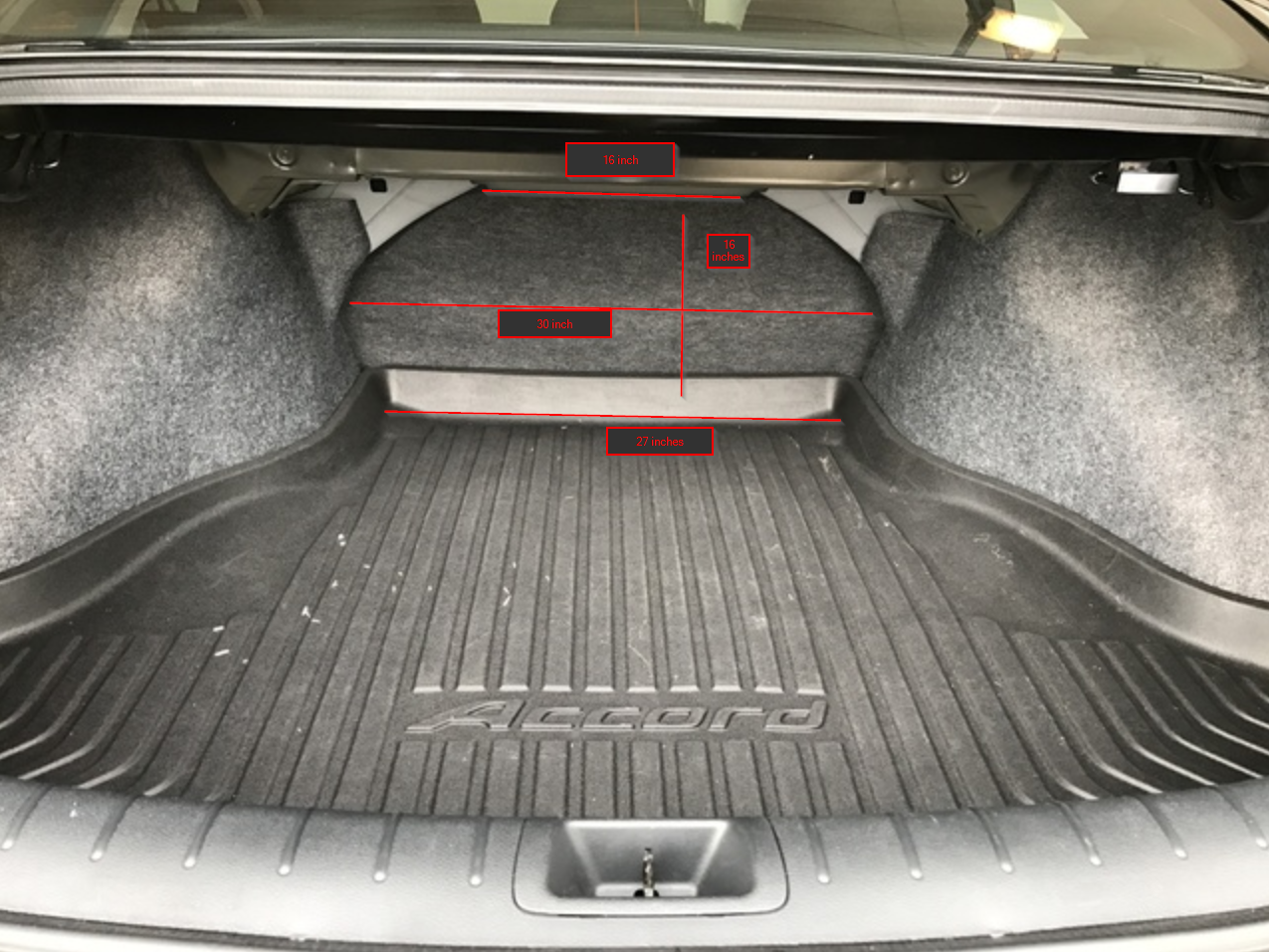

February 26, 20206 yr Author So as you can see here the rear deck is about 12 or 13 wide between the bracing. seat up (this color combo is kinda fuggly in some lighting, should have went with black interior lol) seat down, opening is about 27 inch wide at the bottom, 16 inches wide at the top, 30 inches wide in the middle, and 16 inches tall. Edited February 26, 20206 yr by lithium

February 26, 20206 yr Author I think I could make 3x 10" work on the rear deck. Seems like the Daytons, modelled above, could get close to the same performance as the mach 5 mj18 I've run in my last vehicles. I need to see if 12s could fit. And if they do, would the stock speaker openings in the deck be large enough to vent through. Im sure I could build a 6 inch thick baffle to install any size woofer on the rear deck. But that would defeat the purpose of the install.
