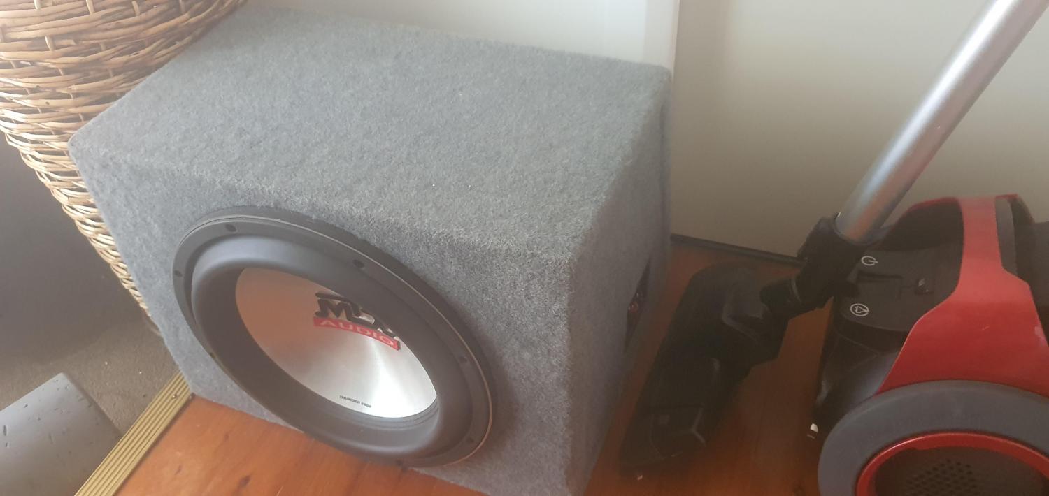

Its in this unported tiny box. I read reviews where there original specs under size it to fit into boot spaces. Also when i have used this before i have seen cheaper 200$ subs with more spl than this. Tried 2 different amps. Nothing hhelped. I think this box does not even take into account the displacement of the sub and is to small as it is.
