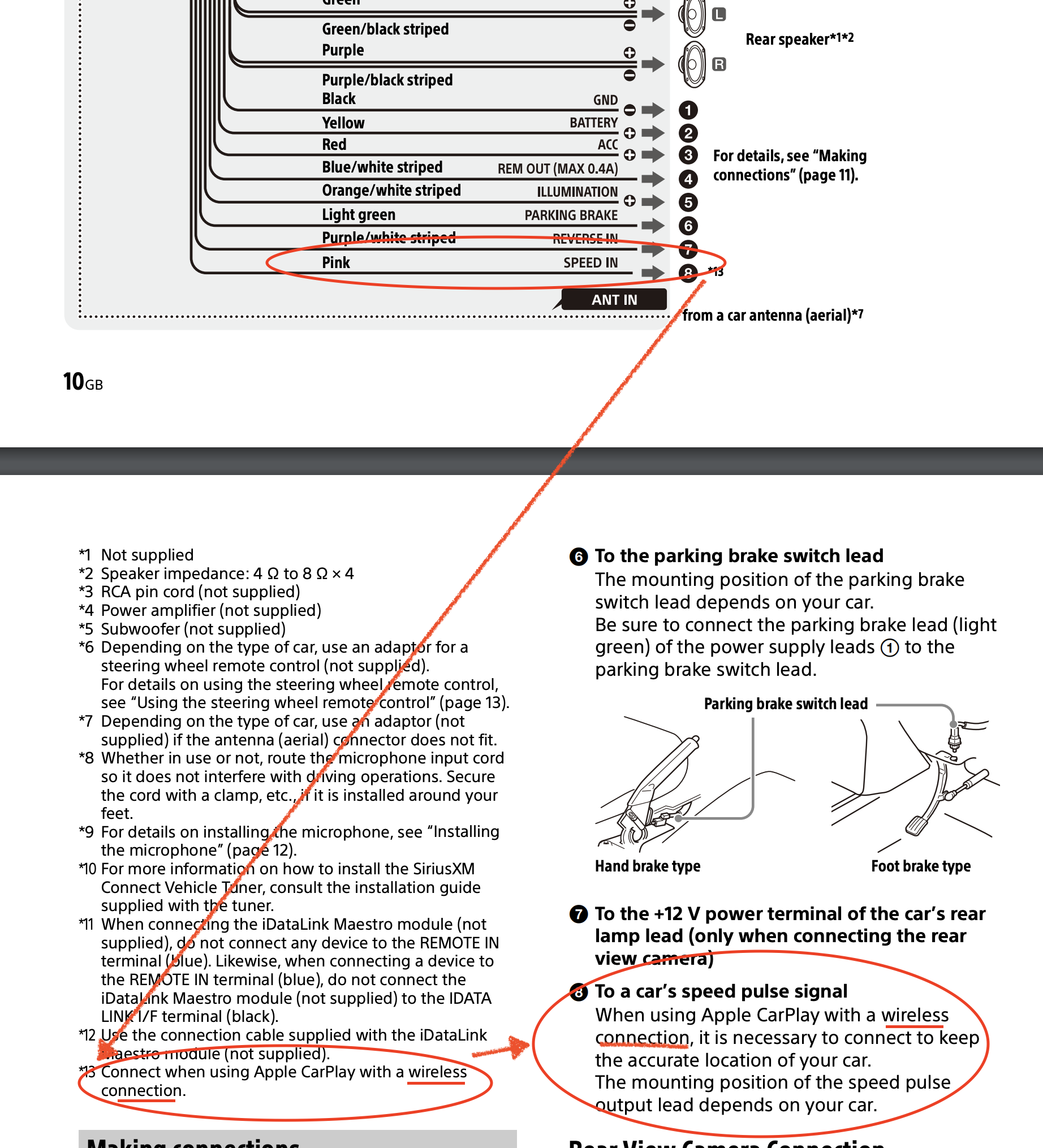

Posted December 8, 20223 yr Hi guys I'm putting a Sony unit with wireless carplay into my hiace camper next week. There's a pink wire comes out of the head unit that needs to be connected to the VSS (aka speed pulse signal wire) for the maps to work properly. Anyone know where I'd find that on a 2009 petrol hiace? I'm putting a Sony unit with wireless carplay into my hiace camper next week. There's a pink wire comes out of the head unit that needs to be connected to the VSS (aka speed pulse signal wire) for the maps to work properly. Anyone know where I'd find that on a 2009 petrol hiace?
December 13, 20223 yr Admin Welcome to SSA. I have no experience with that car. Is there a car wiring diagram?
