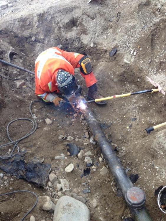

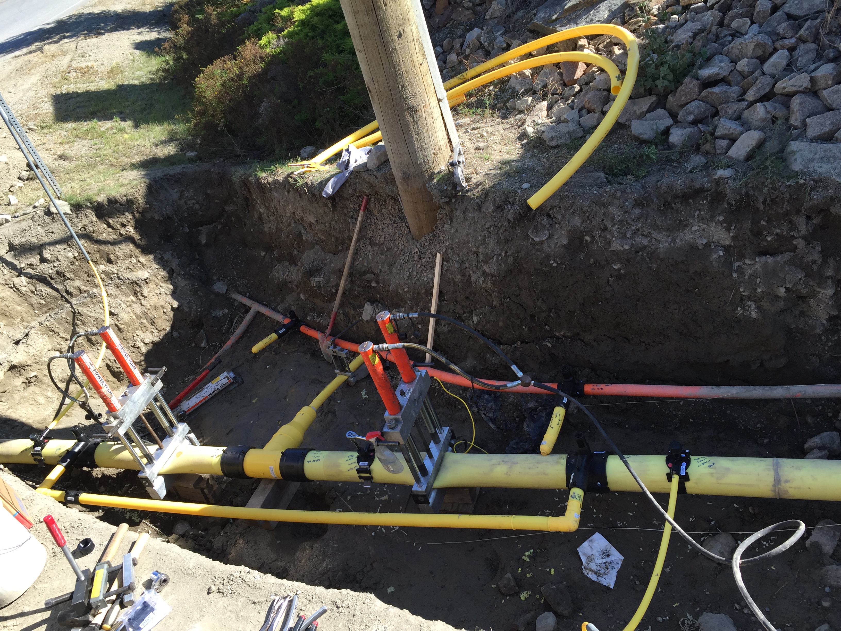

Posted November 10, 20169 yr Popular Post working on Natural Gas Pipelines , weld repairing hit lines , plastic fusion on PE and helicopter drops on mountainsides.... never a dull moment repairing a hit 4" live gasline a 10" high pressure gas line plastic fusion tie in between a 4" PE and 2" PE line a 2" PE gas line and a service tee going to a house

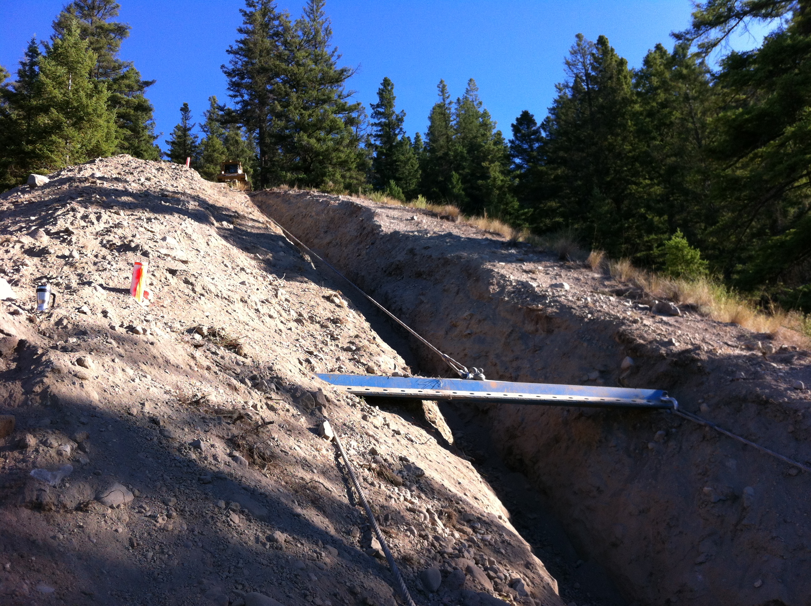

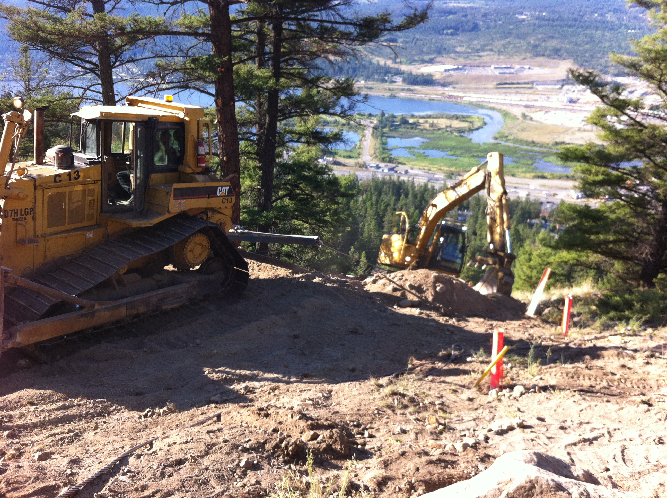

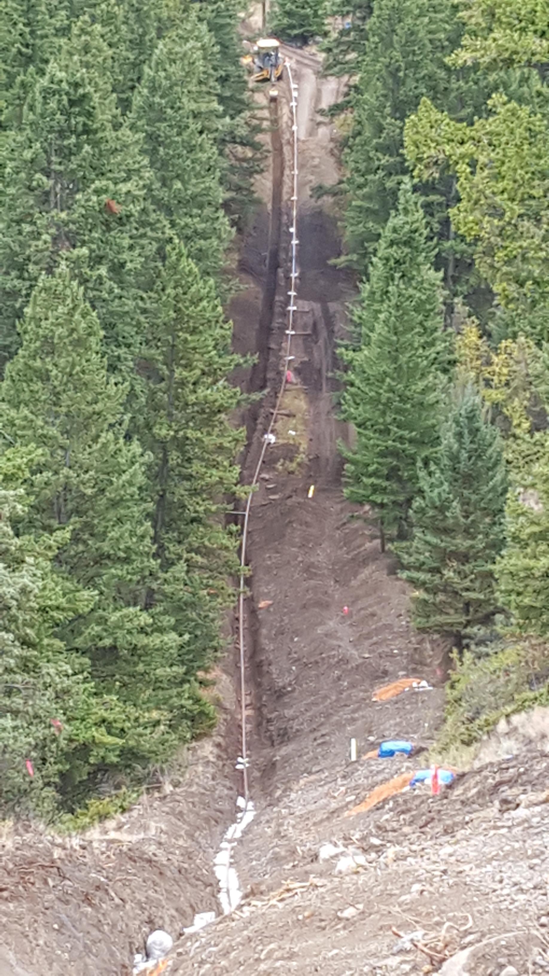

November 10, 20169 yr Author a D7 Cat holding an excavator on a mountainside ... so steep in places you had to crawl up we had 900 meters of 1.25" cable ... 1800+ feet

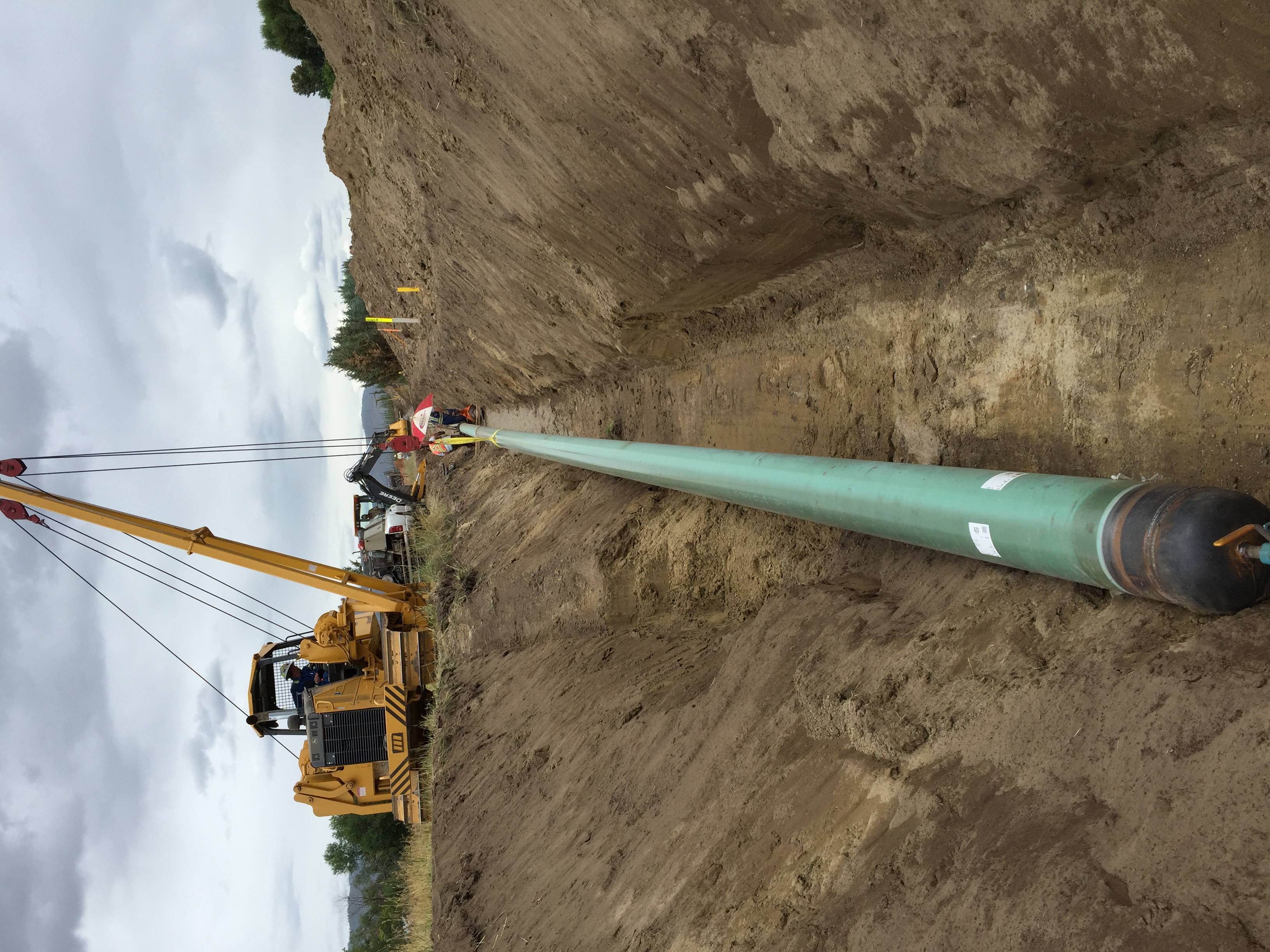

November 10, 20169 yr Man those pictures are awesome for real! How much PSI is running in that high pressure line from the compressor station?
November 10, 20169 yr Author The high pressure line is about 1200 psi the distribution lines are 62 psi i have welded stopper fittings on 500 psi ... they dropped the pressure for me can't say I wasn't nervous with those i had a Muller ignite because of a leaky valve about 3 feet from me when I was running a root pass on a transition and got hosed down with a dry chem

November 12, 20169 yr Nice pics Trevor! Lay that pipe! I bet that's a challenge to weld that close to the ground. How do the check that out in the field? Still by x-ray or do they use some other method?
November 12, 20169 yr Author it's all done by X-Ray and the distribution lines are tested with air on a clock high pressure is hydro tested .... line pumped up with 2200psi of water

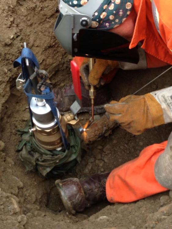

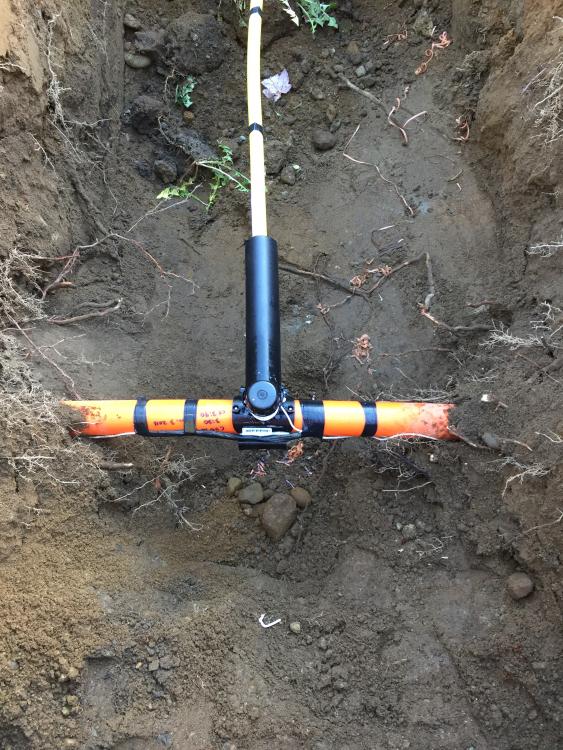

November 12, 20169 yr Author also doing abandonments of house services.... with these I weld a steel plug on the tee branch with an acetylene torch you wanna talk small holes.... I'm 6"2 and have to fold in half sometimes
