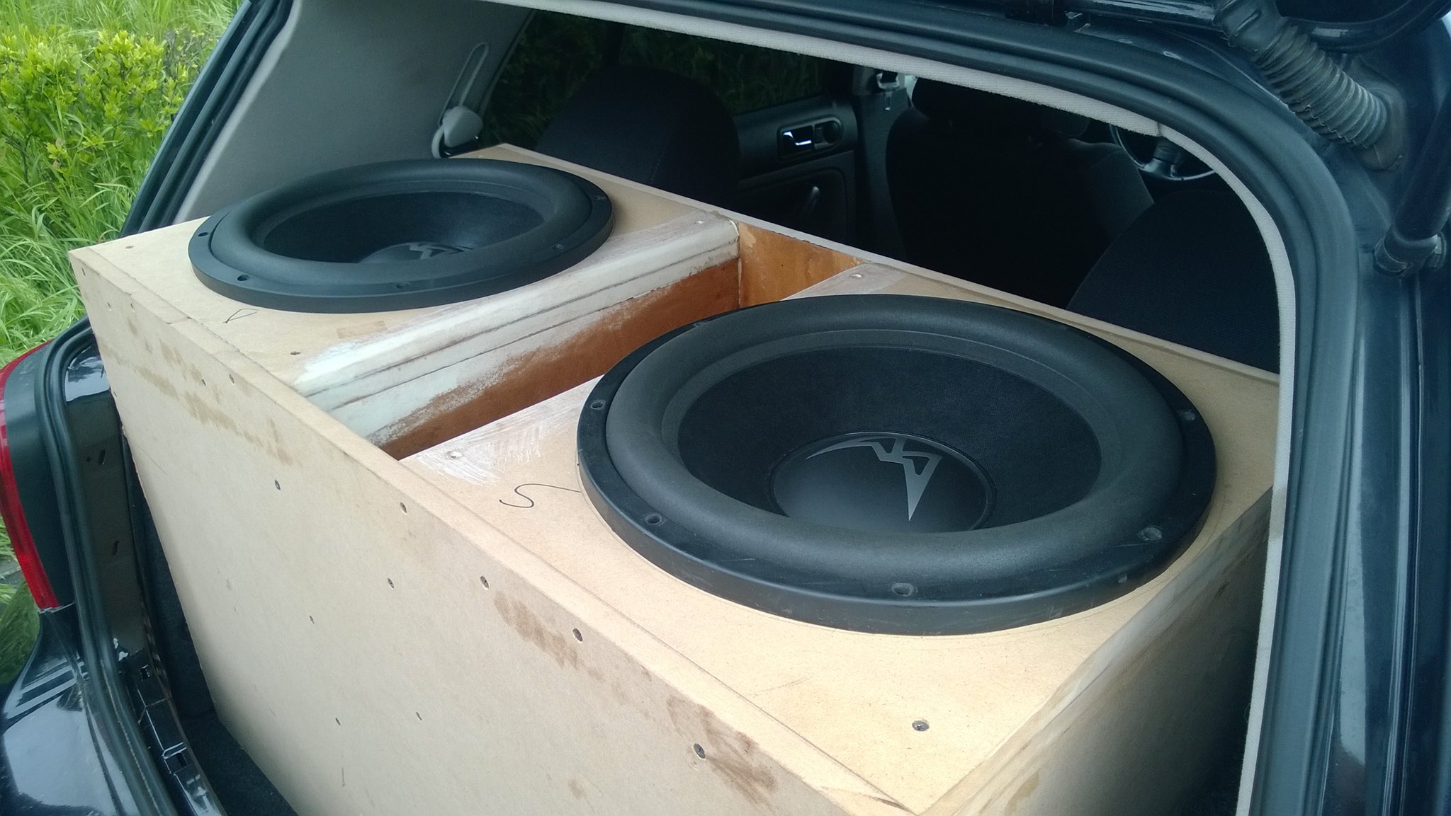

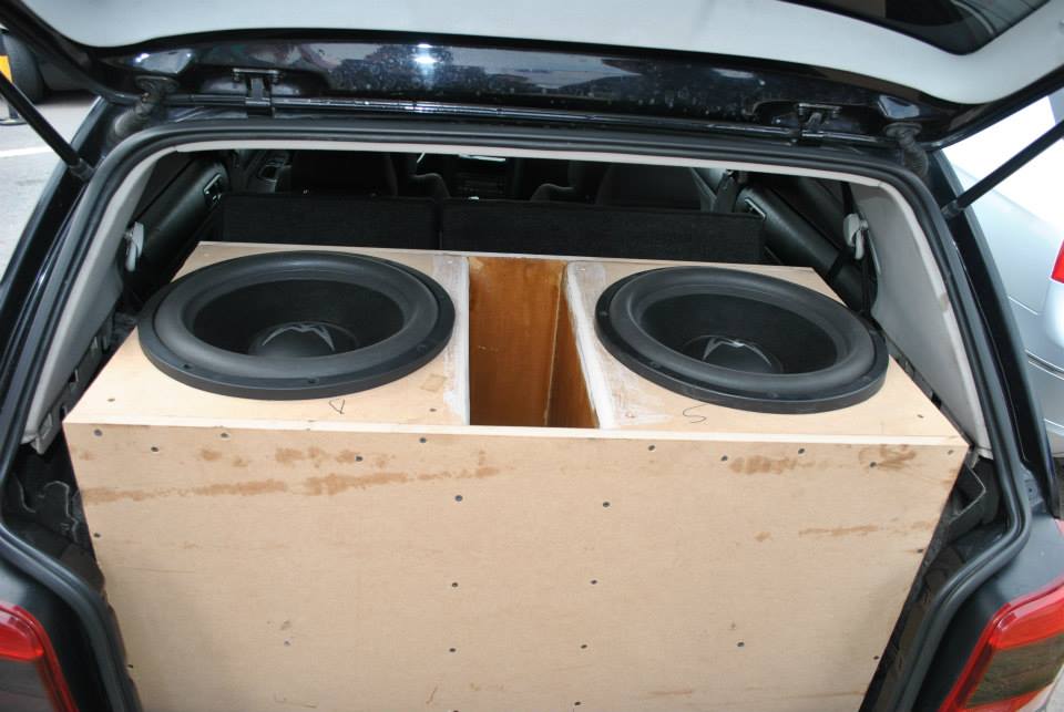

  1. I start working on this box. it will be with two 8' PVC interchangeable round and flared ports. For daily the box will have 7.6 cubic feet, 2 x 8' flared round ports, 32Hz with 27' depth and 97.4 sq inch area For SPL the box will have 8.2 cubic feet, 2 x 8' flared round ports. I will start from 42Hz tuning to find the car peak freq
  2. 2 x AA Mayhem 15' D1. The maxim internal brut volume for this subs is arround 7.5 cu ft. Now I have a box tuned to 37Hz with 39.4 x 23.8 x 20.1(inch) external dimensions But i want to make two box, one for daily one for spl.
  3. About sound system. Stoc alternator 120A Two stock batteries Sound Deadener = 0 Before buying this car I have Alpine 9855 head unit with KCA - 620m usb interfaceTwo Ascendant Audio 15' D1 ordered from BKOLF04 (thank you Brian)Skar Audio SK 4500.1dSkar Audio PAX - 8'Skar Audio VX1 - ST1DLS CA21 As soon as I got the car I put the hu, I make a box with 6.7cu ft for subs, 110sq inches of port area, and 37Hz tuning. Port is between subs like in pictures. With oem 120A alternator and two stock batteries for the first time to spl wired to 1ohm, I did 147.2 dB @ 37Hz and 147.5 dB @ 42Hz. I say pretty good for the first time with this setup.
