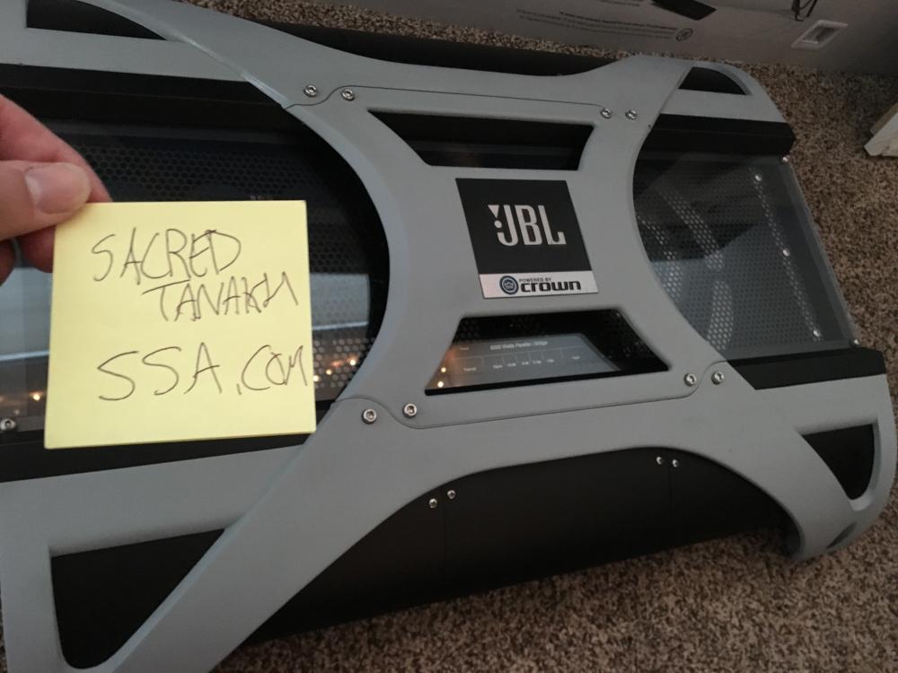

  3. One of the biggest and most powerful amplifiers ever made. They didn't make very many of these so they are quite rare. one was recently tested by oldschoolstereo.com and made over 12,000w rms between the two channels at 1.6ohm per channel. Here is the link I recommend watching it as he goes into the history of this huge amplifier. And here is the manufacturers underrated specifications: Output Power at 14.4V and ≤1% THD+N (CEA-2006): 2 x 2600W @ 4 ohms 1 x 8110W @ 4 ohms 1 x 7400W @ 1 ohm S/N Ratio: 65dBA (1 Watt, 4 ohms) Effective Damping Factor: 6.39 @ 4 ohms Freq. Response: 10Hz ∼ 270Hz (-3dB) Fuse: 600A internal (external 500A minimum) Dimensions: 29.38" x 23" x 6.5" (74.6cm x 58.4cm x 16.5cm) Weight: 88 lb. Only selling because I'm moving agian and need the extra space. The top beauty/mounting plates are in automotive primer ready to be painted to match your build. Condition is excellent. Price is $1500 picked up in the Dallas Texas area, or best offer, don't bother low balling Id rather keep it to be honest. It's only going to gain value considering how rare these amplifiers are getting. I would be willing to ship it if you cover the costs for shipping. Call or text me for questions: 907-227-8213
