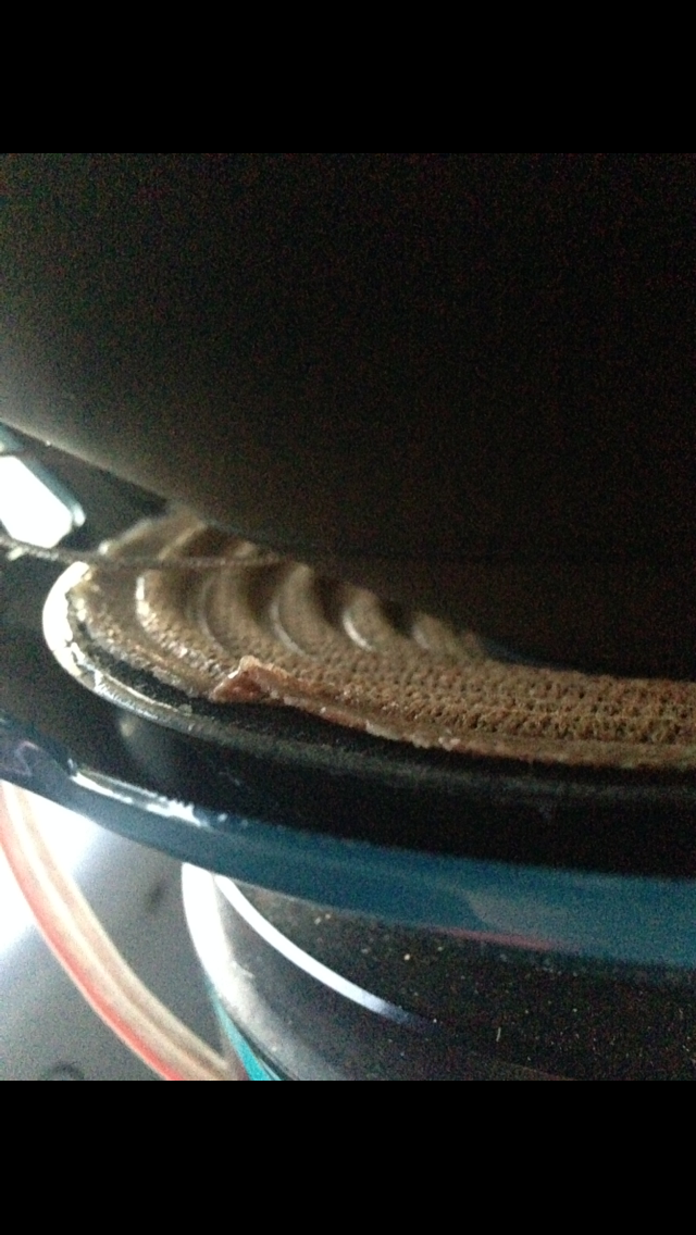

  19. Yes, thankfully they both still work. It was only partial, so I took a leap of faith and used a bead of hot glue between the spider and the landing for til I can go out and get epoxy. I can reach in and pull the hot glue off easily. They're not super high power, if the noise stays gone, (I heard the spider slapping the landing and took them out to inspect) I'll call it square and leave em. I only have them on 125rms each. I think I want them reconed eventually because the way these sound, I don't think i'm ever getting rid of em; but today is not the day. Maybe I just haven't heard something amazing yet, but i'm very happy with my IDQ's.
  20. How can I repair my IDQ 15V1 if the spider partially detached from the landing? Is it time for a recone? Or can I patch it?
