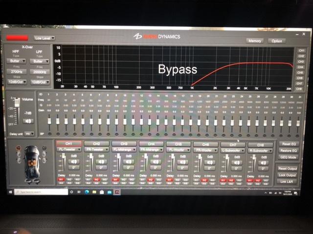

  8. The DSP aint working correctly on low input only on BT mode. On low mode only ch1/2 work rest aren’t playing, BT mode all play perfectly. I sent back to AD & was told there is nothing wrong that all outputs on low mode are working . other issue i get a clock ticking sound from ch 1 & BT keep cutting off every few seconds or minutes.

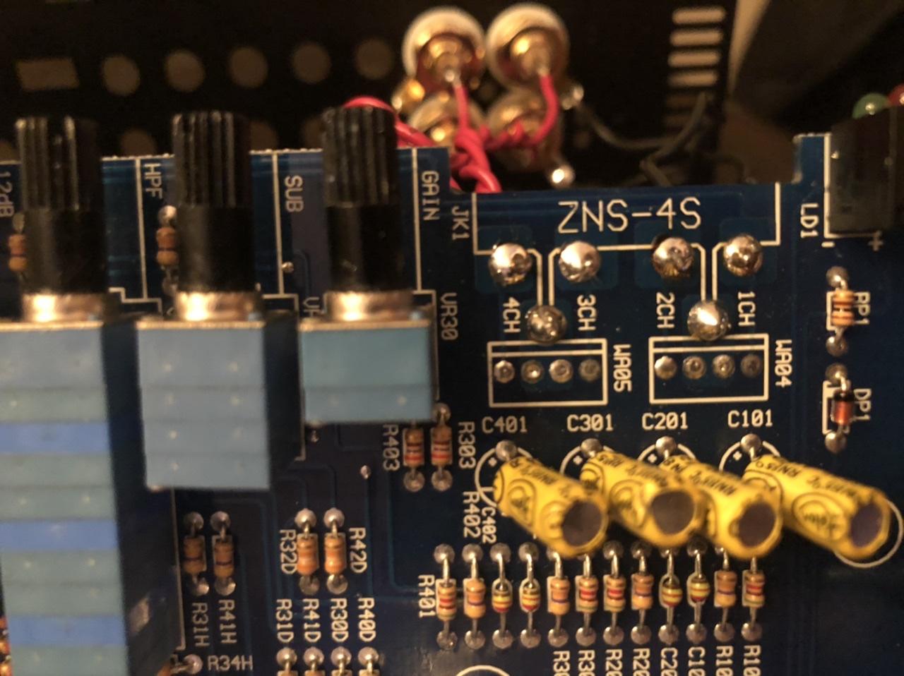

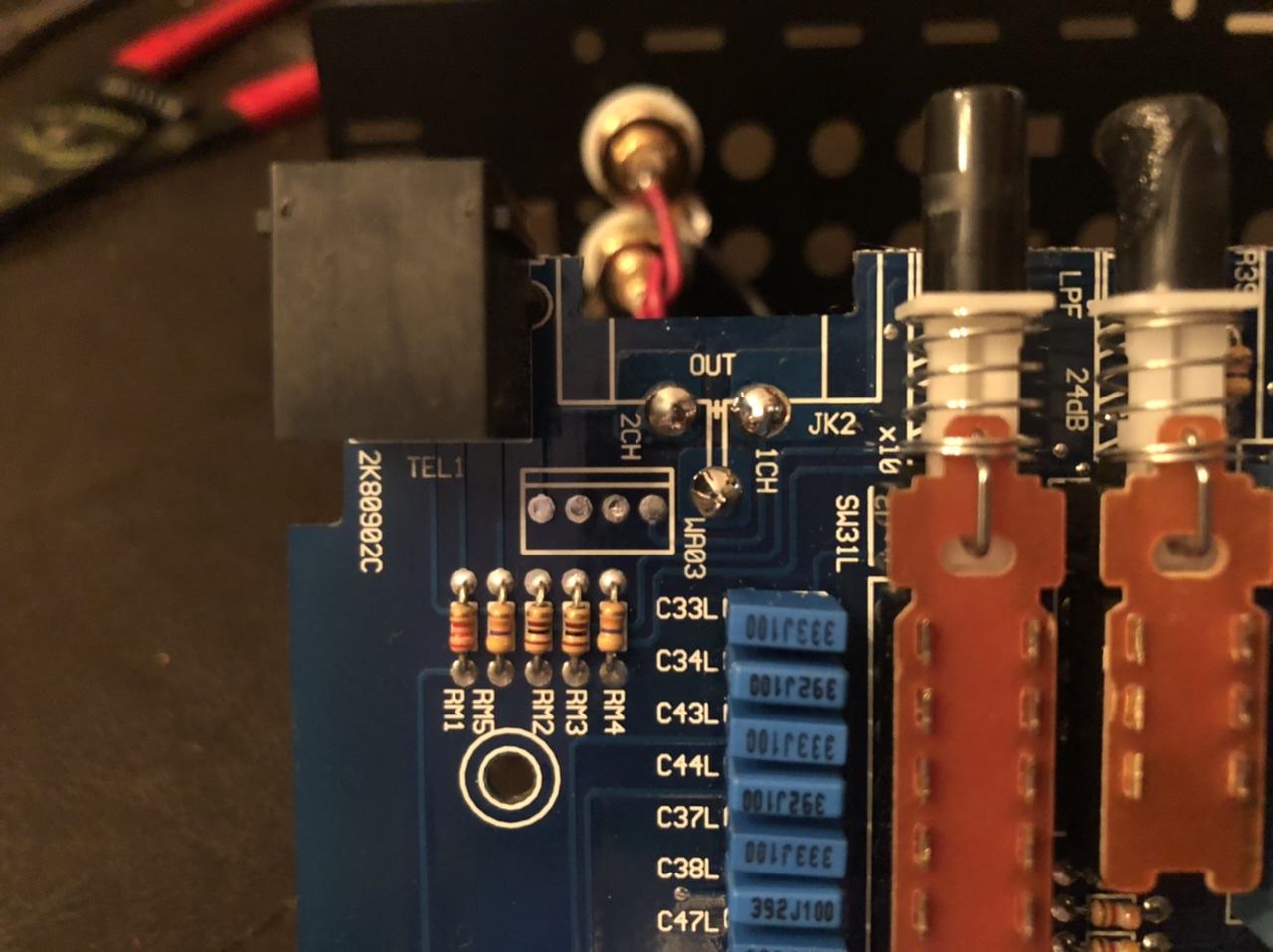

  10. Have no idea what happened, solder looks good. I hope I didn’t over heat the boards on both amps and damaged them.
  11. Both my amps were working fine “twisted sounds 150.4”, but since one of the rcas outputs broke off I decided to change all to Tiffany style rcas. My issue i’m having now when I try to adjust the fader on HU to front the rear speakers still play but little lower & vise versa & balance is the same issue. Also when I turn on my vehicle it has engine noise through speakers now. The single solder between ch1,2 & 3,4 is + & the duals above them are grounds for 1,2,3,4.
