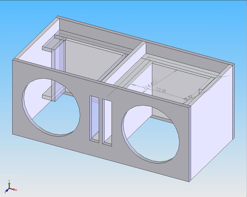

i'm getting pissy, i can't get this box right, i'm going to end up having to do a port inside the box that isn't as tall as the box, cause if i make the port as tall as the box, it has to be long as hell, i can't do a PVC port without putting a bend in it which i don't want to do.
Box will be 18" tall each ava will get 2cubes and will be tuned to 25hz.
i'm thinking a 10" x 2" port will be sufficient, that gives me a length of 38" and a volume of about .88 cubes taken up by the port per sub.

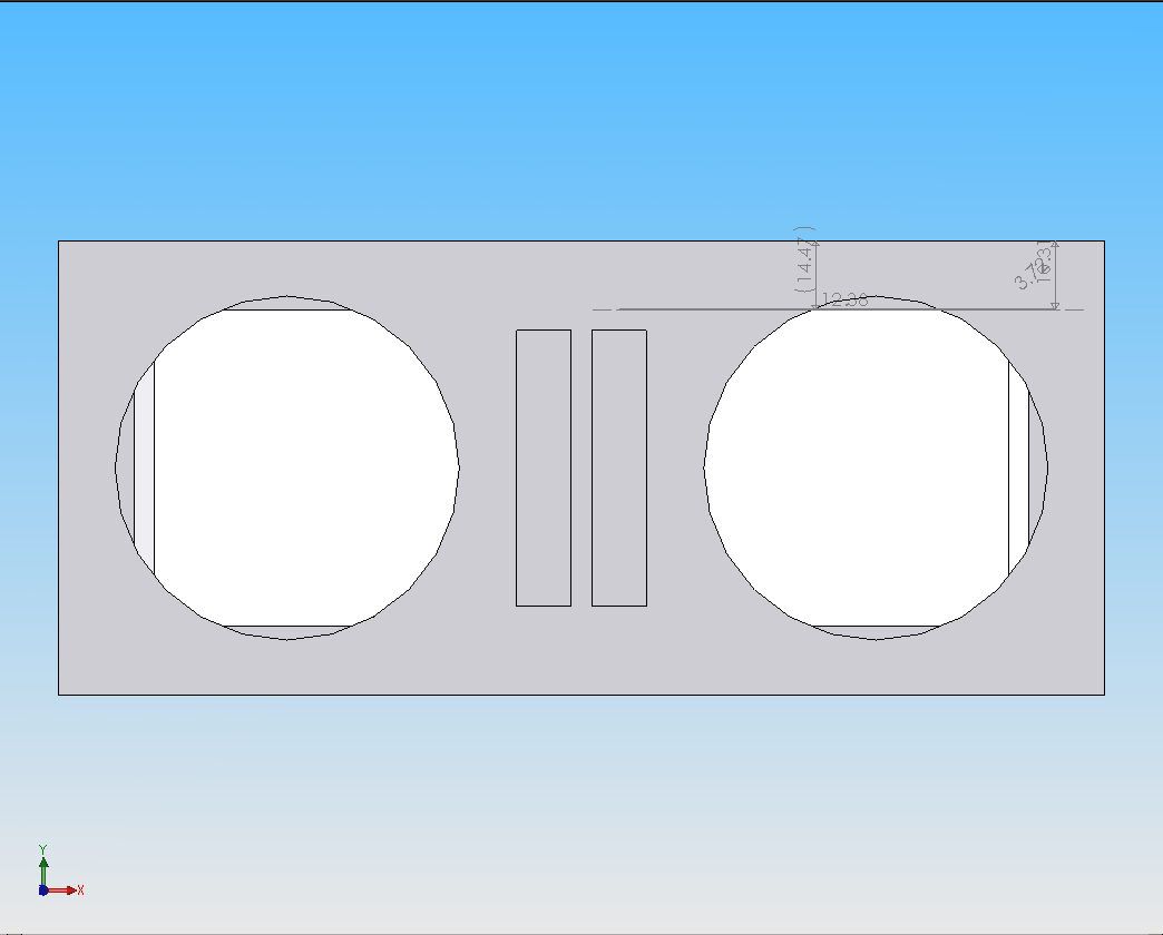

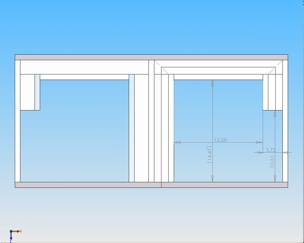

all the measurements should work, its 38" wide 18.5" deep and 18" tall, each woofer gets just over 2.1 cubes before its own displacement (and a little left over for bracing). Port is 2x10 and 38" long tuning should be 25hz
Complicated, 25 pieces total IIRC, mostly small port pieces, but still going to be a PITA to make, it will have a double front baffle even though it isn't shown, but thats no problem if i get everything else correct.
