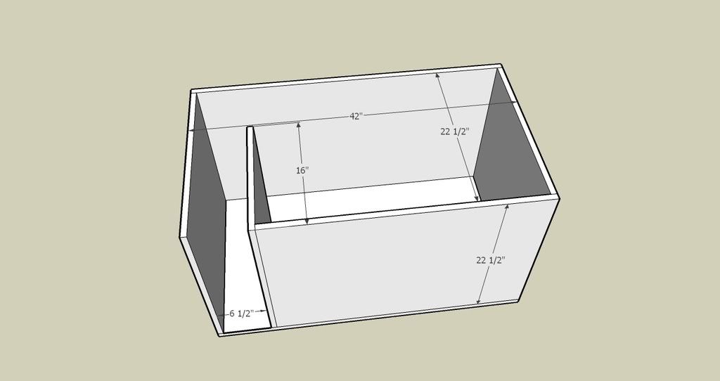

Today i finished building my box for my Bl 18. Its 9.5cuft with 146sq in. of port tuned to 33hz. It is going to go in my back seat of my 1984 cutlas supreme. My amp is a AQ 1200. Anybody got an idea of what i should expect with this setup? any comments are appreciated

lol 5-10 cuft is what Fi says. If you think its too big, what how big would you build it?

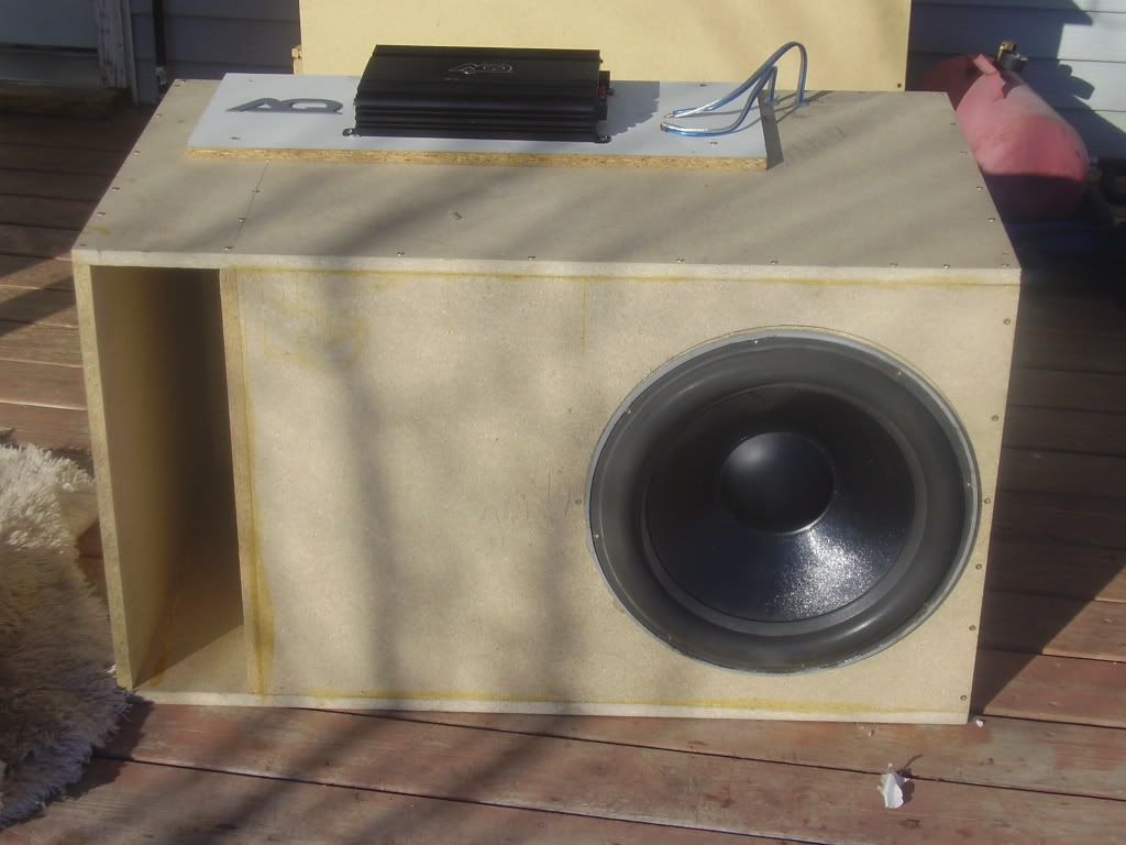

here are some pics.

Almost a wall haha, trim panel and it will be
thinkin back to the last box i had the sub in (6 cubes @ 33) this one blows it out of the water! i couldnt be any happier with the results :D
