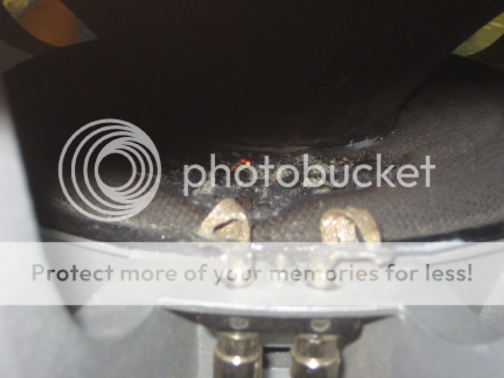

For some reason outside of my power my 08 Bl with cooling caught fire. I was on my way home from work about an hour and a half ago, i smelt something kinda like burning leaves so I turned the radio off and pulled over and opened the hatch of my jimmy and the sub was on fire. I could see this bcuz there is aplexiglass window on the front of my box... I have no idea how or why it did this, it was on fire at the spider btw. The amp wasn't warm nor the wires... The amp isa sundown saz 1500d. 0g wire, 12g speaker wire. Itwas only playing for about 5 min when it all happened. I think the warrenty is still in effect, but I'm not sure if that is even covered. The gains are all set low probably well below where they should be. I will post pics tomorrow when i get out of school. I took them tonight. In them you can see the spider still glowing red... Thanks in advance, Mikey

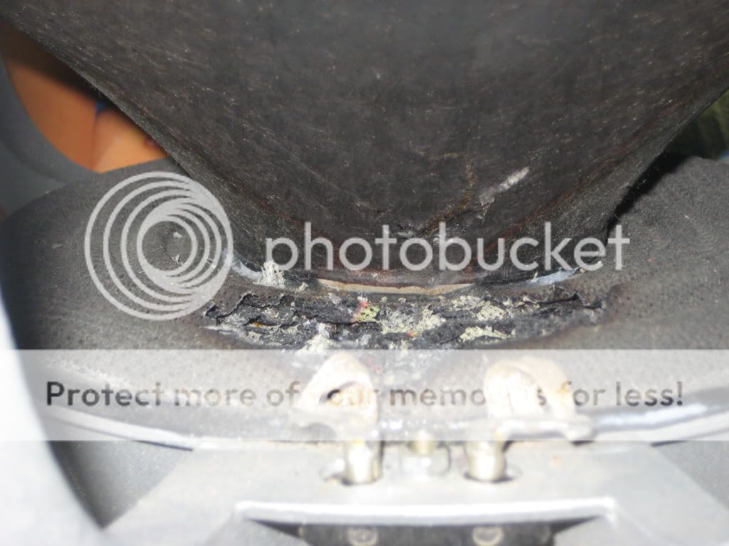

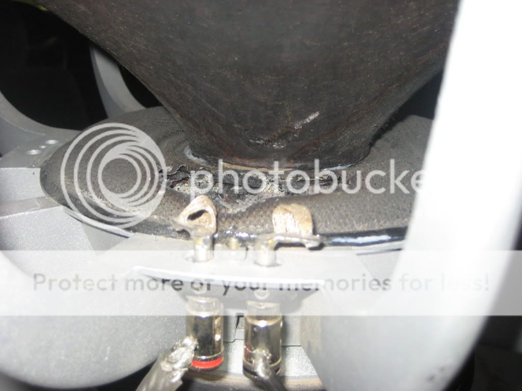

Let me explain what happened. I've had this happen before way back when i didnt know anything technical.
The tinsel leads caught fire due to excessive current. I had this happen when my subsonic filter on a crappy sub was set way too low for the box i was using and decided to turn it up just a couple notches about where i listen to it at. Yea, it got louder, but it immediately set on fire within 12 seconds into the song.
Because the tinsel leads were sewn into the spider, both sides of the spider burnt right through. Sadly, it's simply from running music or whatever it was with non-stop clipping. It generated a ton of heat and unnecessary current.
No speaker company that i know of will warrant burnt spiders, coils, tinsel leads, etc because it's from neglected install. Now, if the company used itty bitty gauge wire on the leads, then yea, that's different but i highly doubt it.

The subsonic is on zero. I am not trying to get anything out of anybody or try to get a new free sub or anything. But i guess i was wanting a new sub anyway, I was going to sell this one though :Doh: But wutever i guess. Il still post pic. I suppose i just have one big ass paper weight now. lol...
subsonic on zero=bad
There's your problem...you MUST set your subsonic 2-3Hz below your tuning frequency of your enclosure. Otherwise..that happens.
