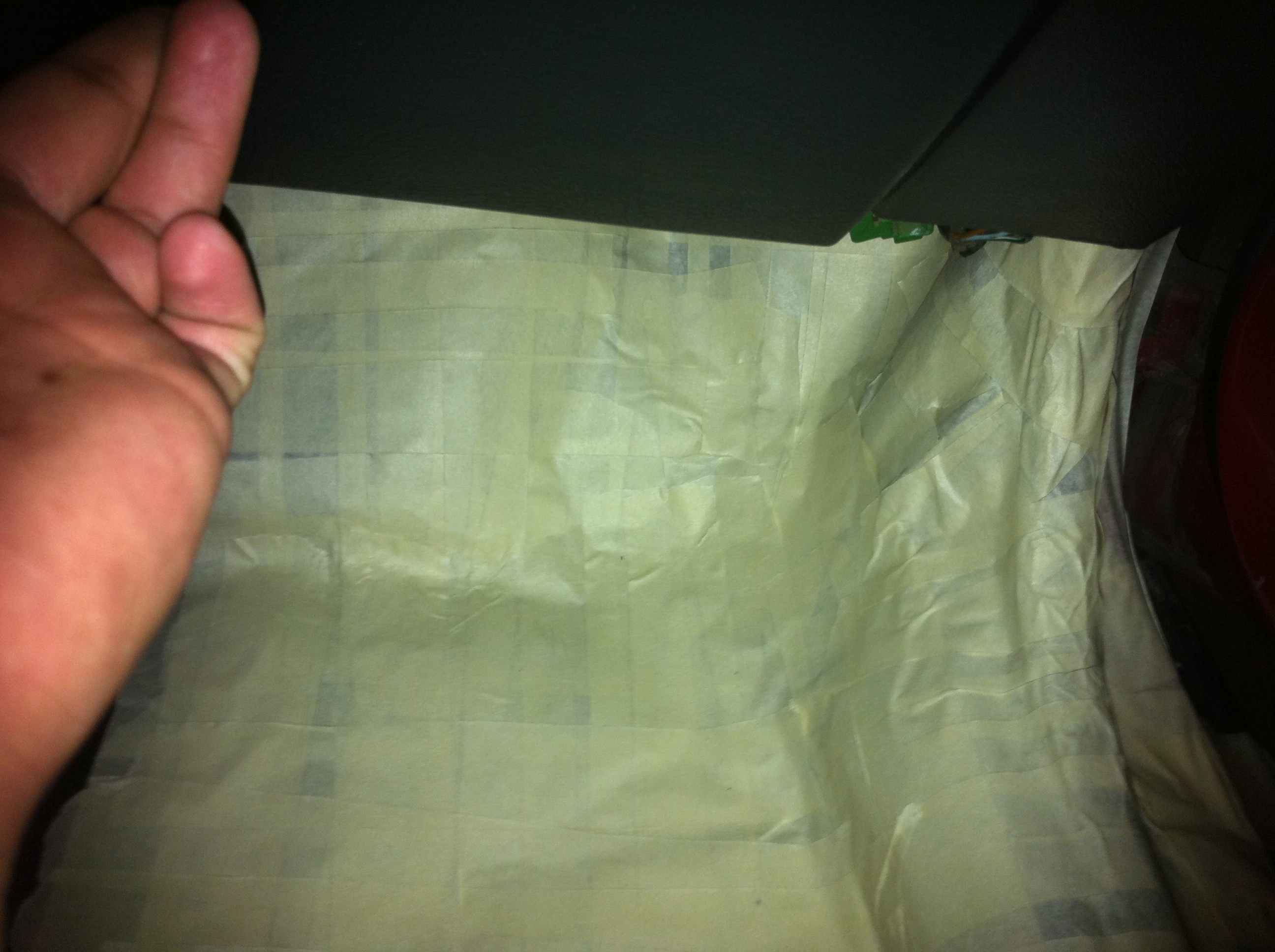

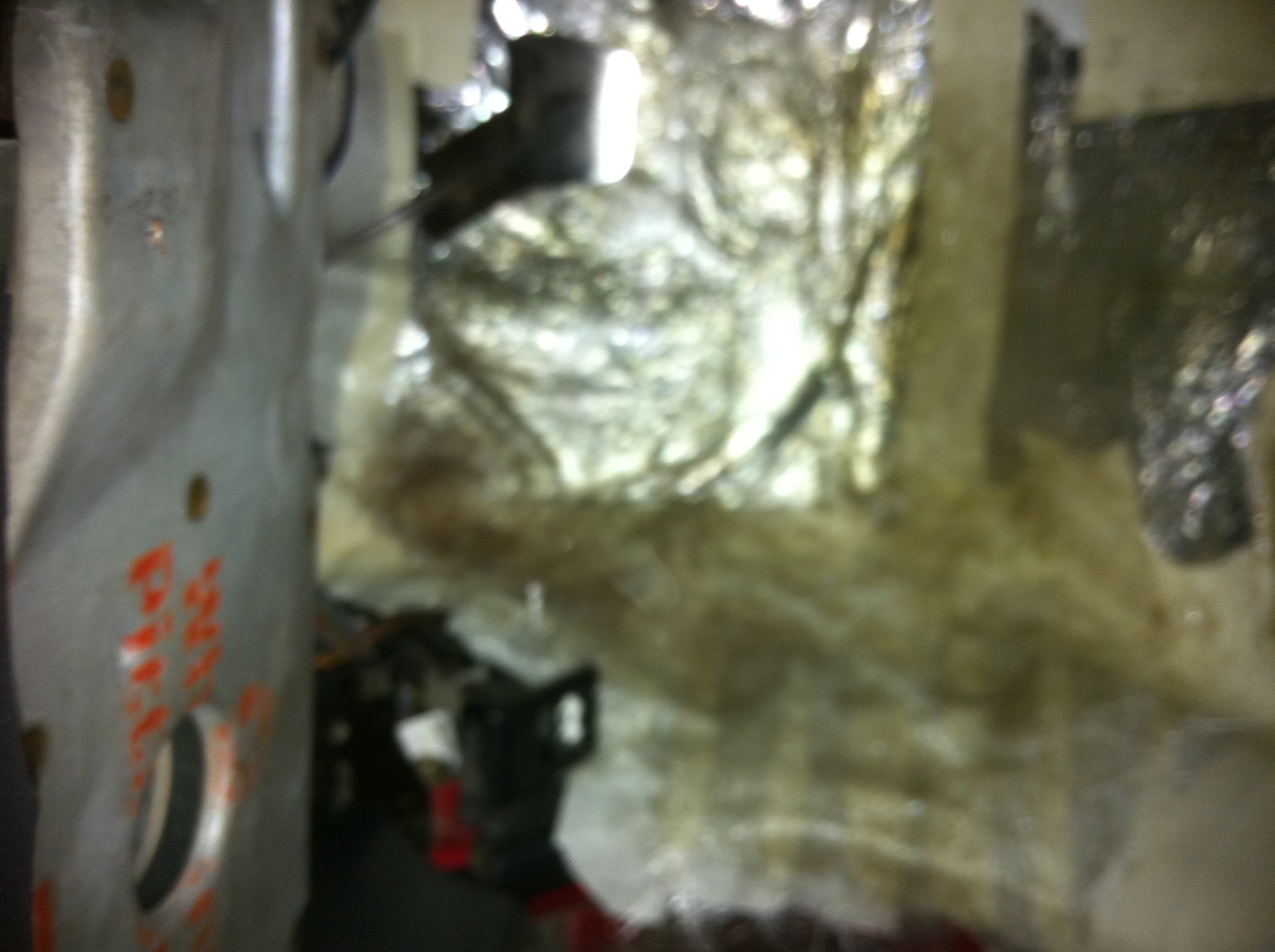

Anywho for the new stuff. Today I started my door pods 1 AA 7in mid in the door and a kick pod will follow housing another AA mid. Got some pics uploading on Photobucket and this is my first attempt at glassing, should it come out shitty I will so it again really want to learn this skill. A new box will also follow later housing Xcon 10s for more room for amp mounting ect!

Here are the pics!!
Got to add another layer to smooth it out and strengthen it up
This is a mock up on angle to see if it will work fine will not actually be glassed to the grill.

Are you using bondo kitty hair on the mat?
I would suggest using regular resin for that, along with multiple layers of mat. Then if you have small gaps to fill or dimples, use the kitty hair.
Otherwise I don't think the bondo kitty hair will really soak into the mat, and the mat is what gives it the strength.
Towards the end when you need to smooth everything out: Grab a cheese grater and you can use that grate/sand down the kitty hair / body filler before it fully hardens (makes overall sanding easier).

No I used an actual fiberglass Matt which I didn't like much. I am going to finish with kid hair but it is hard as a rock.
