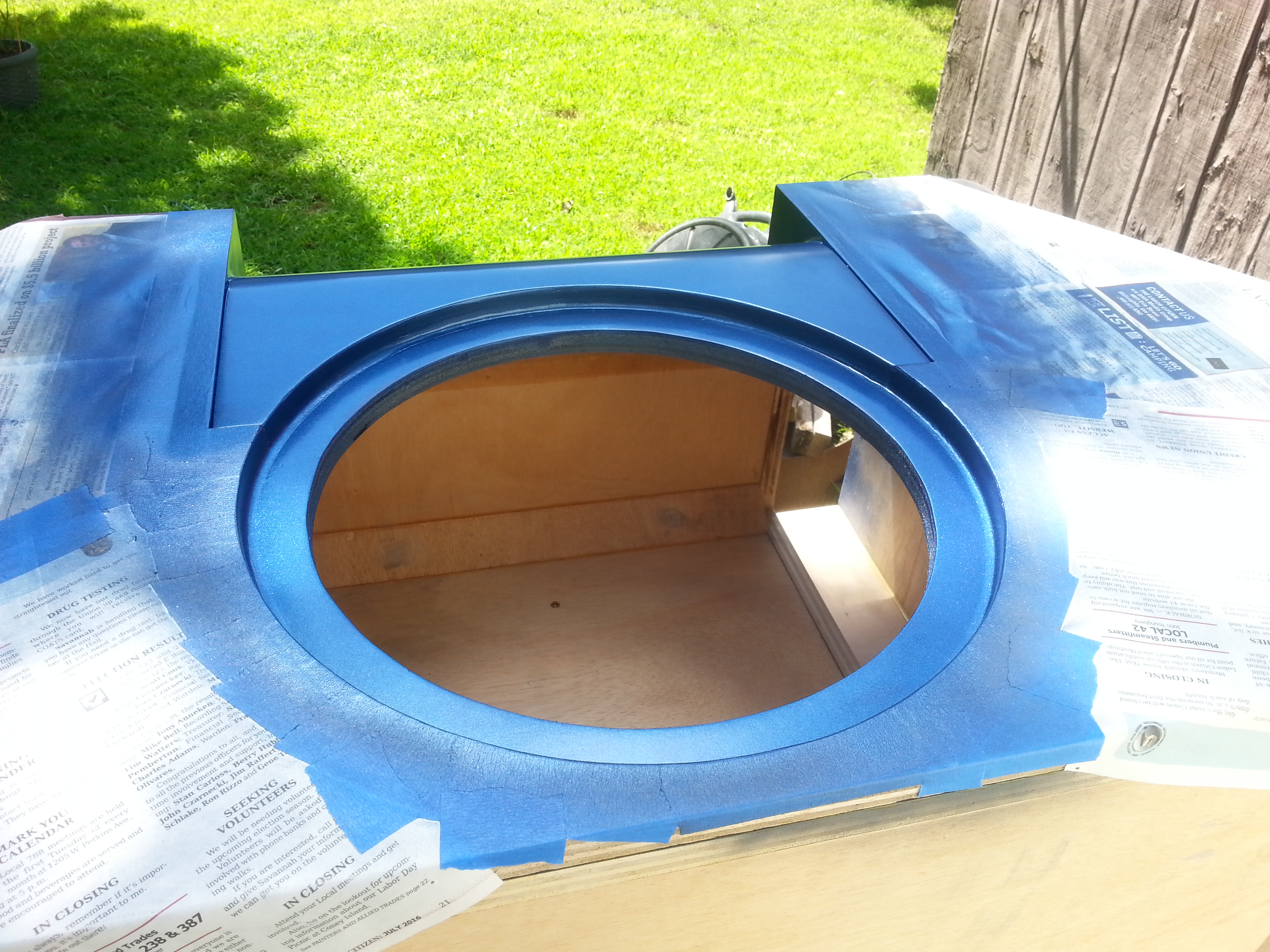

  • MI....I haven't been up there since I was a kid. LOL Thank you for the compliments!!! Well, I have one more freaking panel to cut and it's too dark to see out here so........ HERE'S SOME PICS!!! (onl
  • Whew it's been a long time since I've done a build for myself. This one is modest and not going to be as insane as my last, but then again I am a little bit older now...

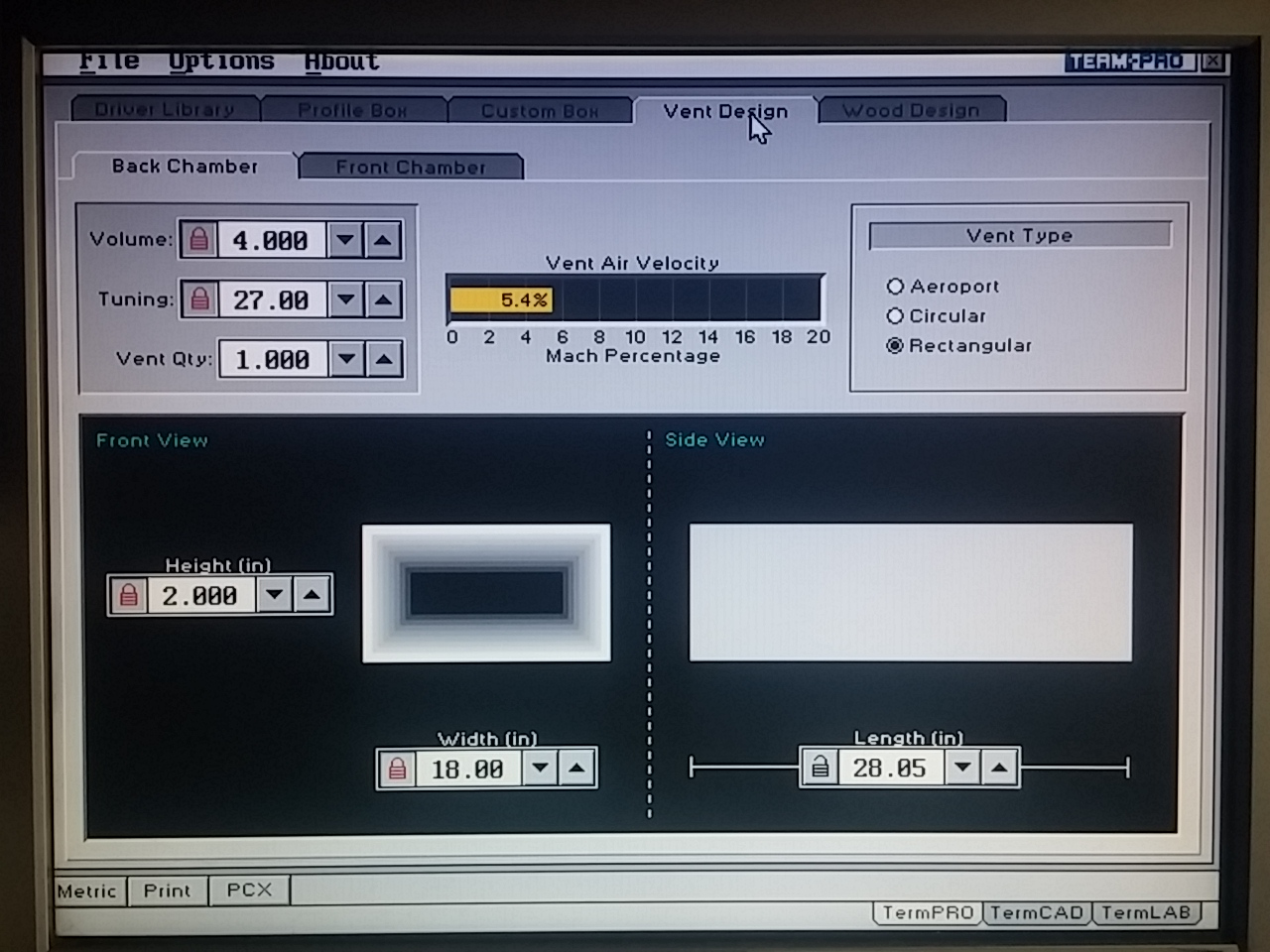

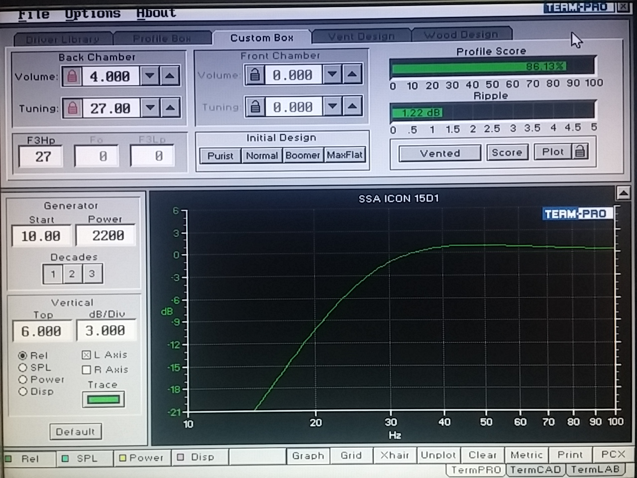

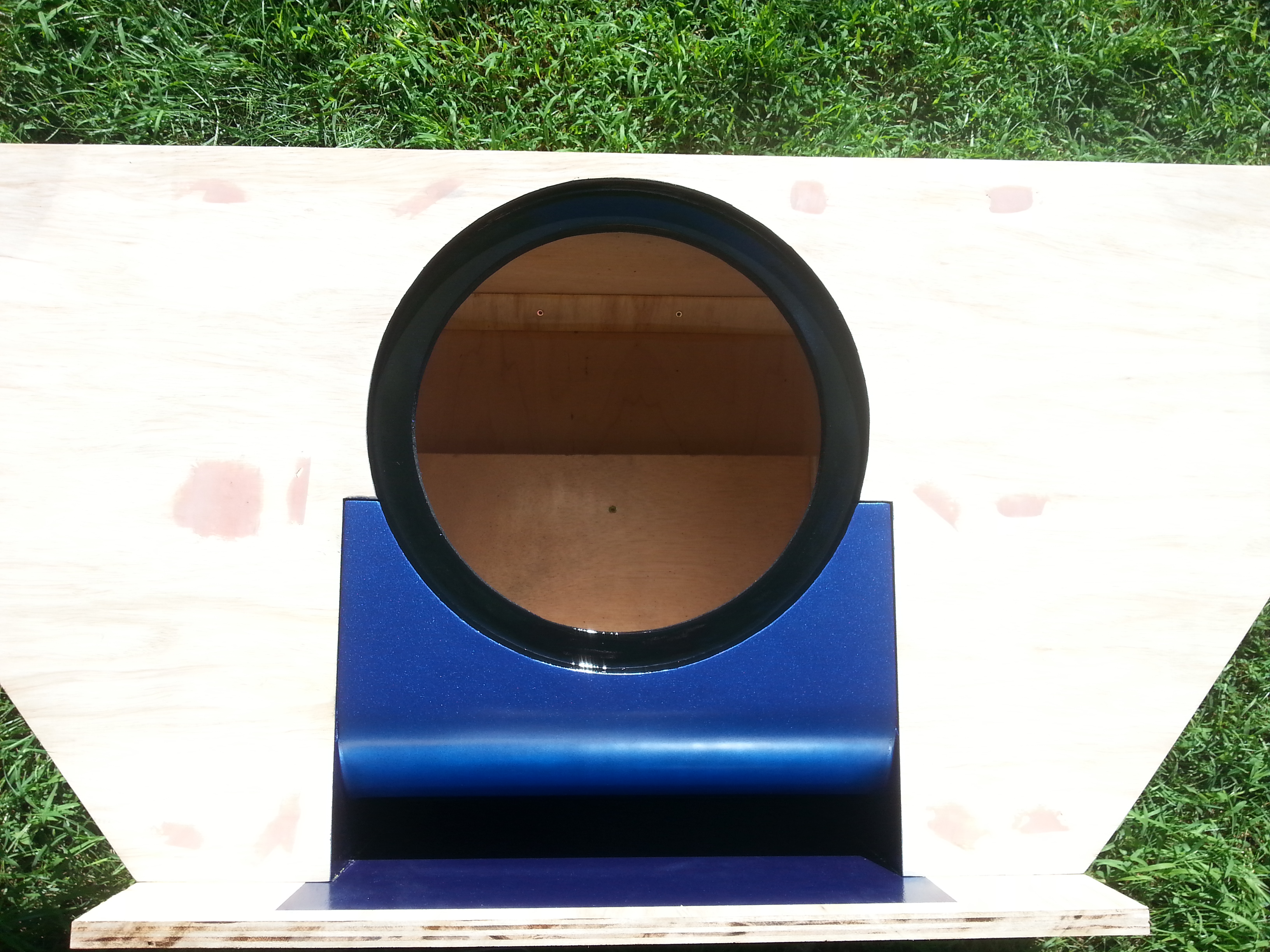

It's for my last remaining Icon 15. It's been sitting in the original shipping box since I blew the coil on the twin at Slamology years ago. Every day I see the dang thing sitting there just begging me to give it life.
So, 4 cubes plus displacements, 2200rms @ 2 ohms tuned at a nice flat 27hz. After modeling these numerous times through the years of owning these, this was the best response curve I can obtain.
:slayer:
How much port area if you dont mind me asking?

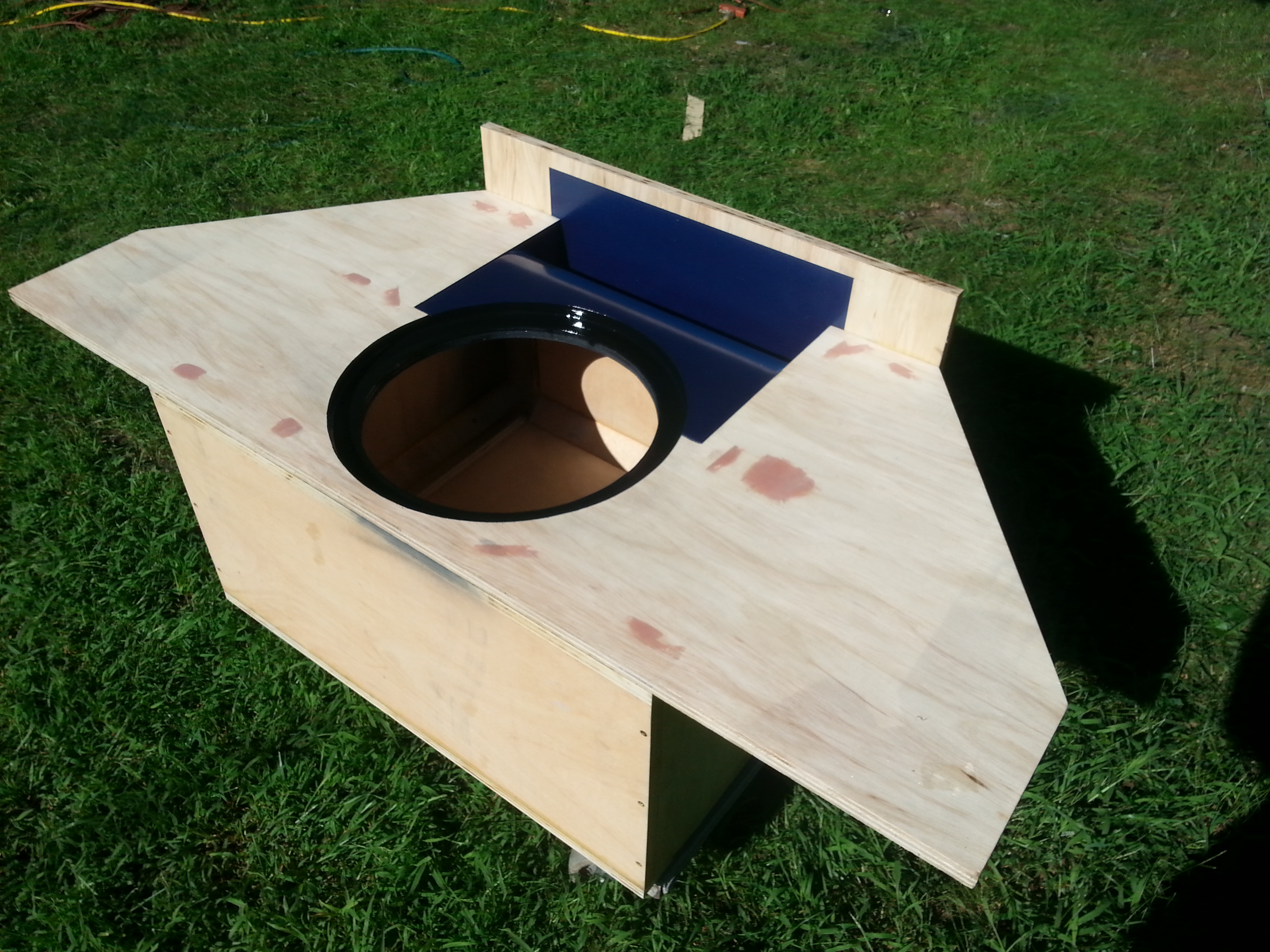

Finally my free time and the crappy weather have allowed me to work on this.

What made you choose that much port area? Just curious amd trying to pick your brain, as my last Icon enclosure was 3.5 cubes with 54 square inches.
Basically, I was trying to keep port displacements down. At my last competition when I was running both 15's I had a net of 10 cubes & 129 sq.in. of port area. I got a final 150db with that before a mechanical failure on one coil during a demo at 20hz. Plain stupidity on my part was the only reason for the coil locking up. I couldn't get to the volume quick enough to shut things down. This single 15", during modeling I kept toying with the port size & displacements and finally settled on this.

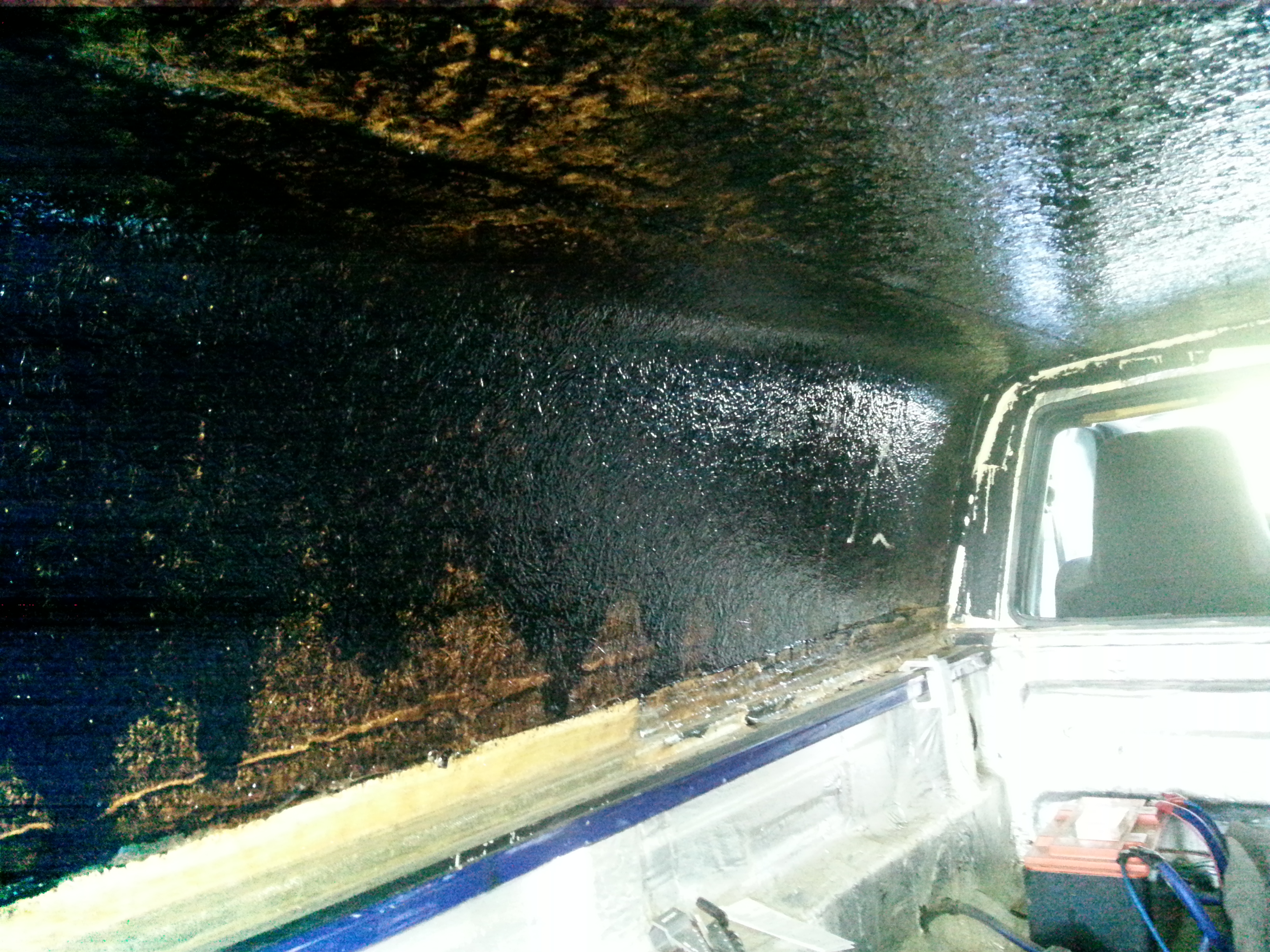

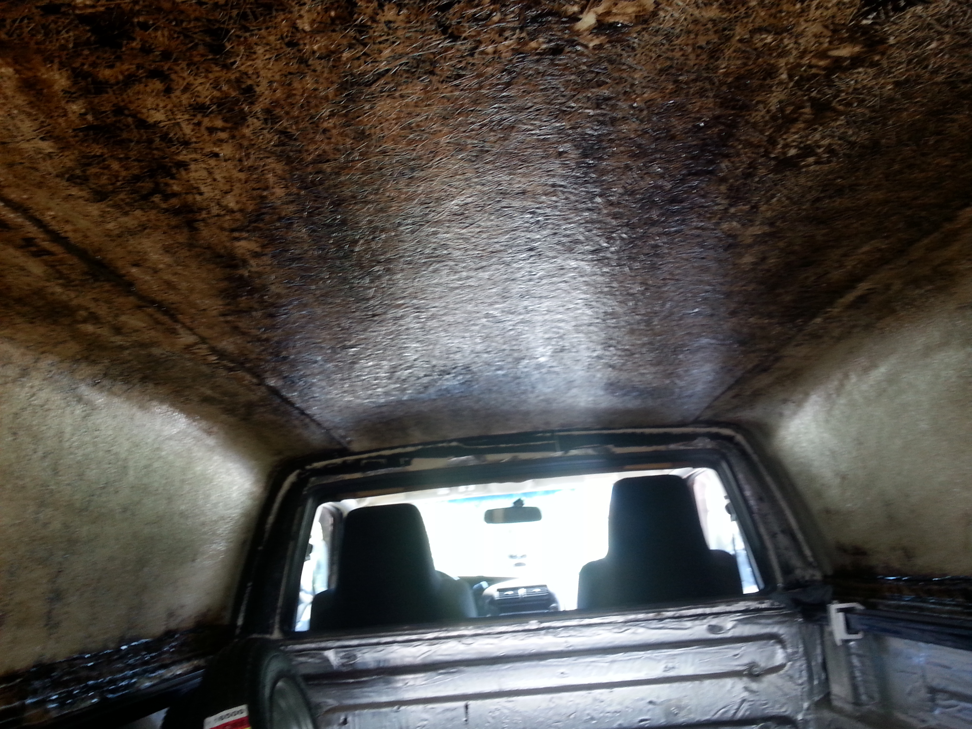

M5 was 100% correct......A long time ago I thought I was sooooo smart saving money on cheap sound deadening. I should've listened to him and many others when they warned me. Now I have a freakin' mess on my hands ripping out this bullshit asphalt based garbage. Learned this lesson the hard way. Fealing like an idiot on this one.
Sorry you had to learn that way.  Even worse is that it sucks at deadening too. :Doh:
To make you feel better I have seen worse doing test work for the oe's in their deadening application.  Crazy what some manufacturers try to do to save money.

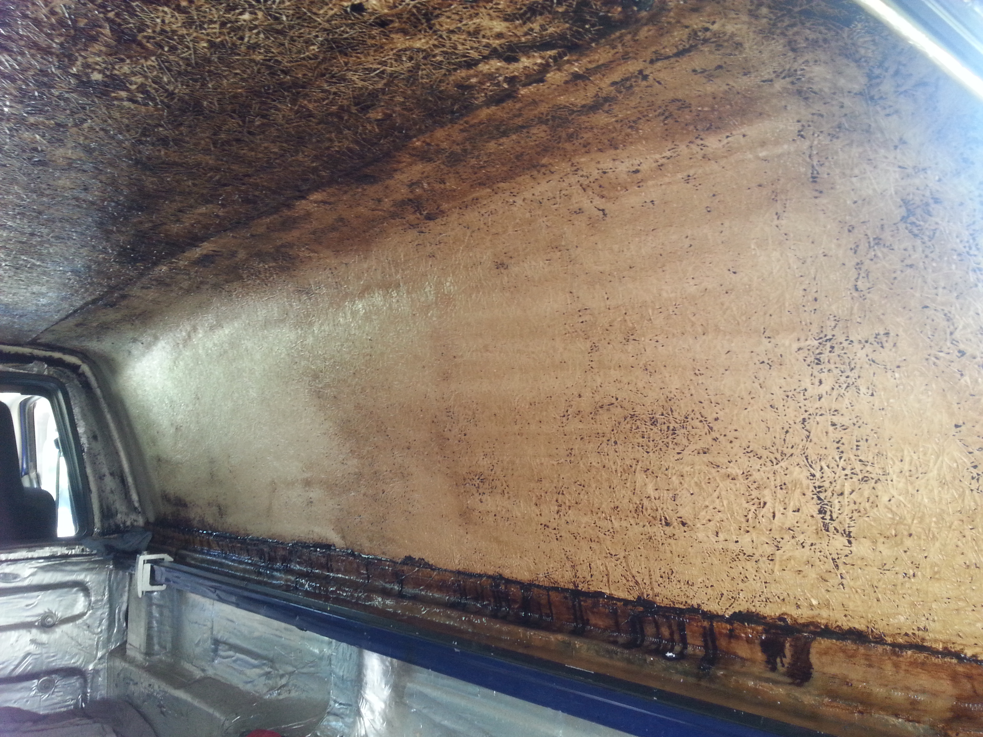

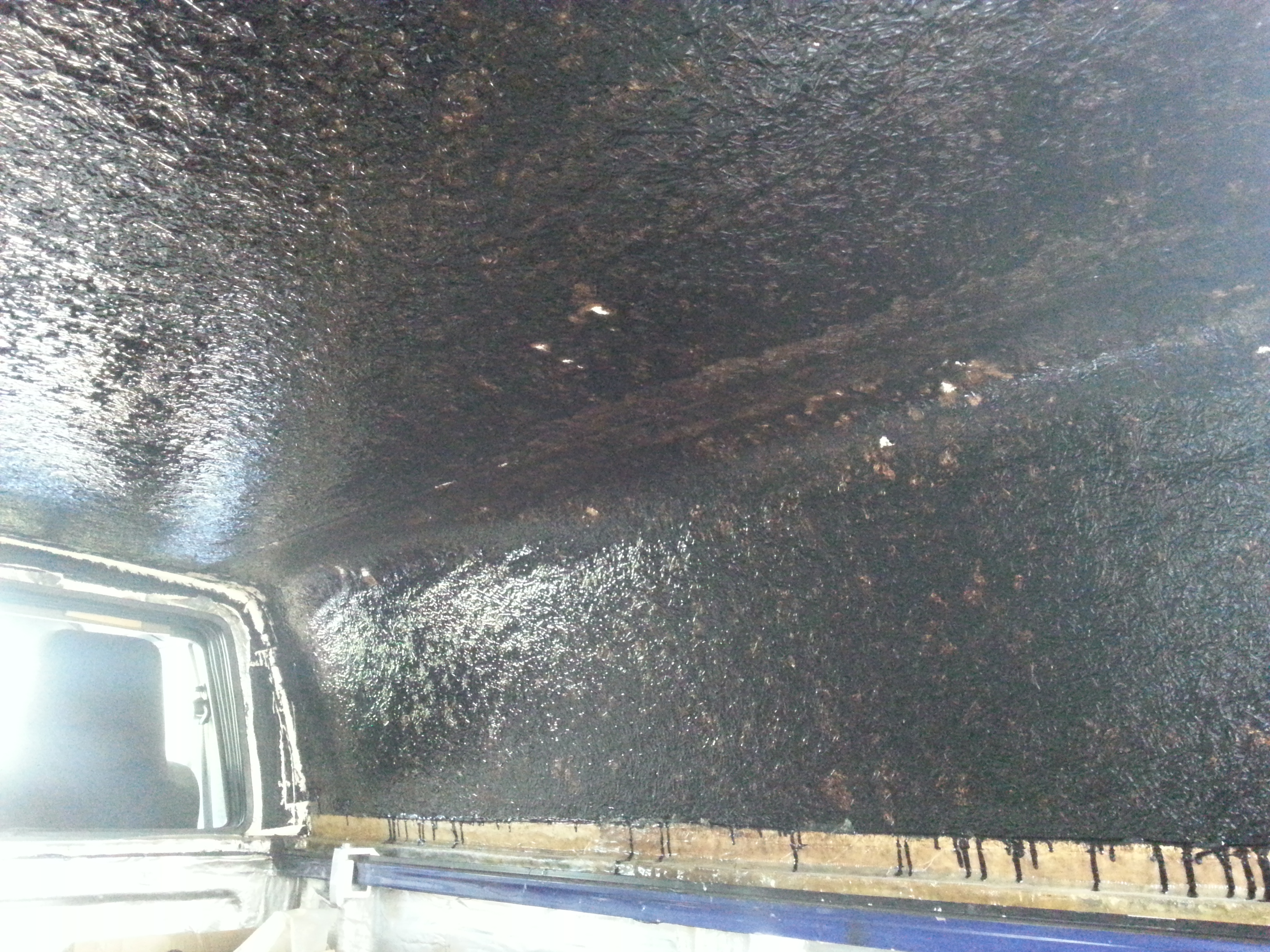

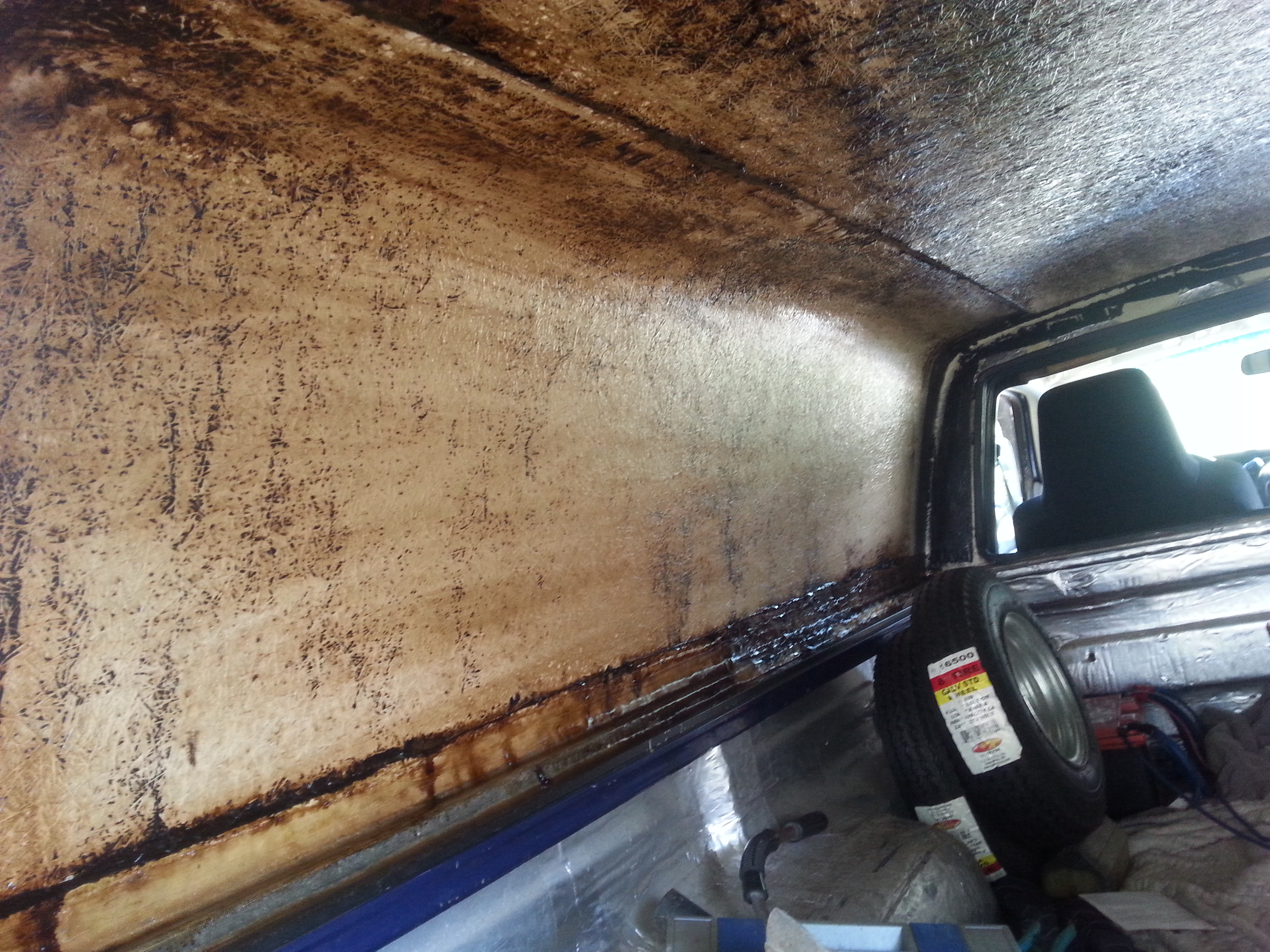

Any ideas of how to get the residue off without harming the fiberglass that the cap is made out of? As you can see gravity is working but it's making a huge mess. Most of the actual material came off but I am left with liquid drip now.

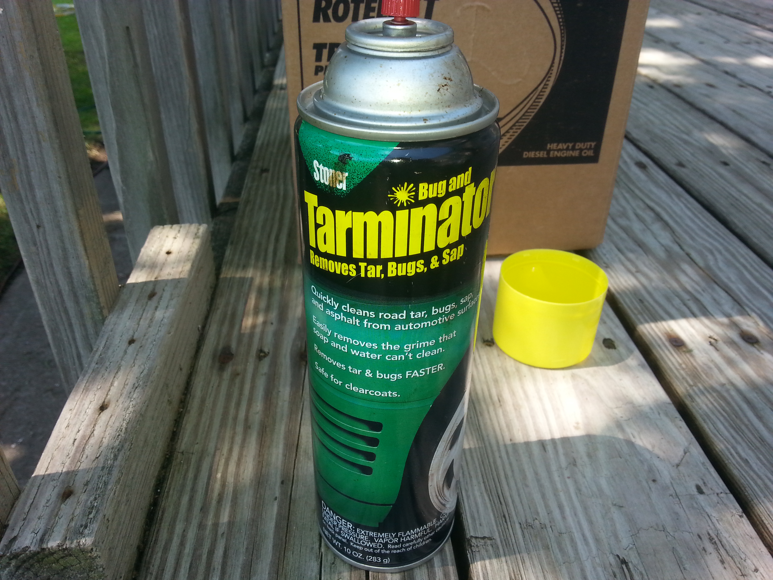

I used the four major brands from O'Reilly's to remove this crap. The Tarminator worked like a sand blaster getting this stuff loose. Everything else just turned it into a slimy goo. Two trash bags of rags later and I have made some descent progress.
