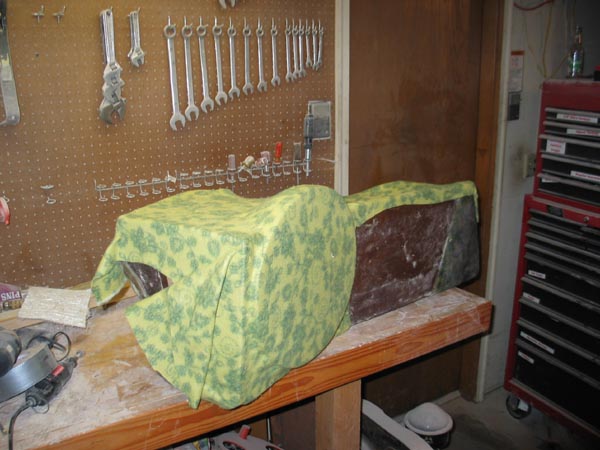

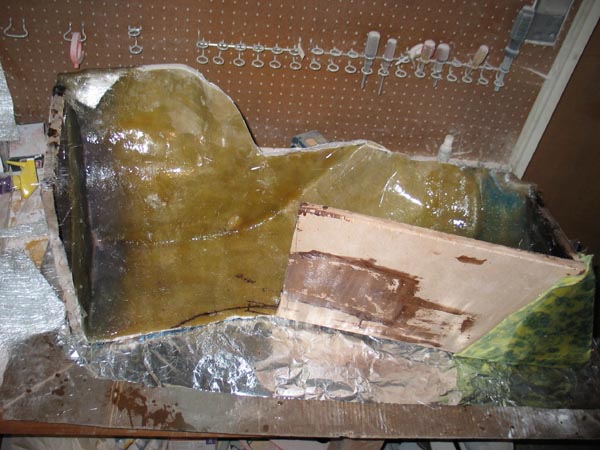

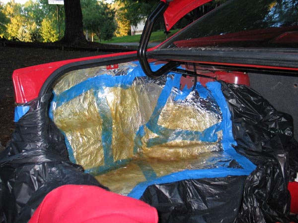

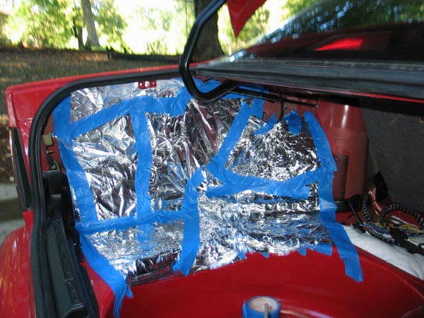

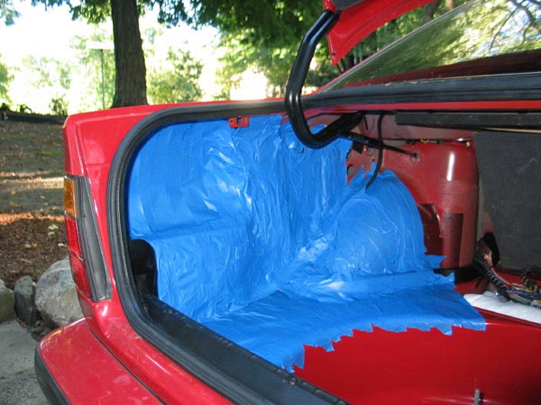

Hey, want your guys opinion on my setup and what to do. The review here and interactions with Mike have convinced me to go with a SoundSplinter. I will push it with either 310wrms (PG M44) or 500wrms (PG zx475ti). My choice due to volume is either a sealed Rlp 12" or ported 10" RLi. I haven't ordered the sub yet but have started on the mold for the box. Here are pics of the beginning.

And for the bracket, not the first bit of fun I have ran into in this car...damn thing is built like it was meant to be watertight.

Sweeeeeet. Just hit the send button to Mike on my order! I am going to try and get my mold reinforced tonight as well, once I start to integrate the MDF I will post some more pics.

Indeed, he was helpful. And yes the car is damped like mad. The only other car I have done work on that was worrse was my old Lincoln Mark 8. I sold it to one of my really good friends and with a W7 and 1000w it sounded good, but loud wouldn't be the word that I would use.

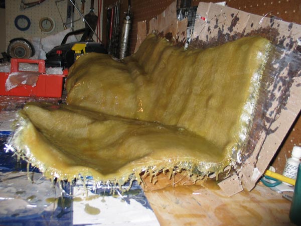

Mike shipped my sub today. I have 10 layers on my mold and will add another 7 tonight--not going to let it flex if at all possible.

Mold is "thickened". Somewhere between 3/4" and 1"; hope it will support the Rl-p :lol2:
I can't bend it even without the other sides.

It looks like you've done glass work before but that thing just looks really big to me! I would suggest that once you get a little further along test it with water to measure the displacement and then slug it if neccesary. If you are concerned with stiffness just use bracing like a normal enclosure thats what I did with mine.

do the stand on it test, im shure it will pass with ease
Actually, never done glass work (I coated a kevlar canoe with resin to cover scratches, but that is it). One of the lessons that I am learning is that I should have done everything so far in the car. The edges kept getting bigger with layers and trimming this stuff is not what I call fun--even with an angle grinder.
As for being too big, I actually am running into the opposite problem and am going to have to make it longer--it will receive the water test and be corrected in the end.

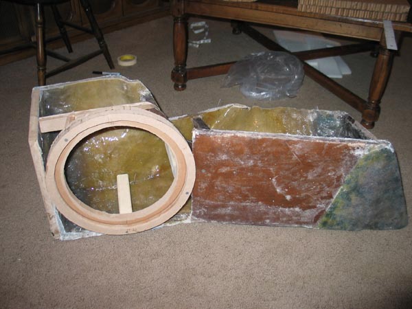

Should be ready to mount the baffle by tomorrow afternoon when the sub arrives. Here is the current "rectangular" box that it will be going in. By my crude estimations, it will be about 1.65cuft gross which I will limit down to 1.53 and use the old water test to verify. Can't wait to fill her up!

Thanks. Got my first layer of bondo on a few minutes ago. Going to try and get it sanded and the last layer in the morning as I would love to blow some paint on it. I get on a plane to San Francisco tomorrow and will be gone for a week so letting it setup in the garage is perfect. Hopefully by this time tomorrow I will have some pseudo finsihed pics with paint; however, I am not sure that I want to body fill/sand the whole damn box. Holy crap building these things takes a long time.
Chit gets heavy too. 5 gal's of Resin, a few pieces of MDF, bracing and about 8 yards of 2oz matt really has a little weight to it. Add in the 32lb Rl-p and I am sure I will be near 150-200lbs.
