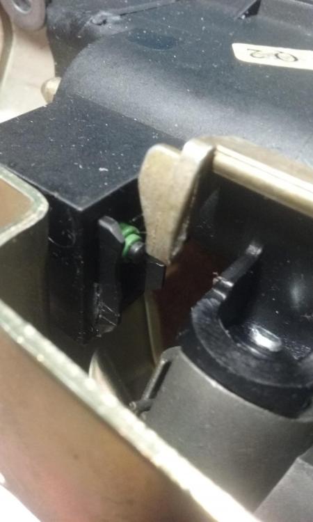

Ordered the brake light switch today off amazon for $15. Kind of a pain in the ass to get to but it came out.

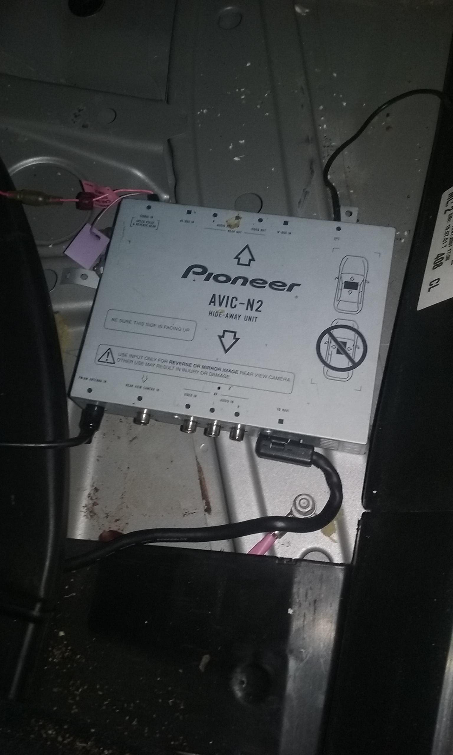

Decided to do some more removal of the interior and Im glad i did. Removed the center console. Then worked on the pass side floor board which revealed a few things. Some one left their Pioneer AVIC unit under there and I figured out why my radio reception was horrible. My factory antenna was hooked up to the dead Pioneer unit. Also the antenna plug that I was plugged into my radio was actually my power antenna that I didnt even know I had...or if it even belongs to my car lol. Shit was comical. They stuffed it in the pass side molding and pulling it out was like a rabbit in a hat trick.  No wonder my shit is so fucked up :)

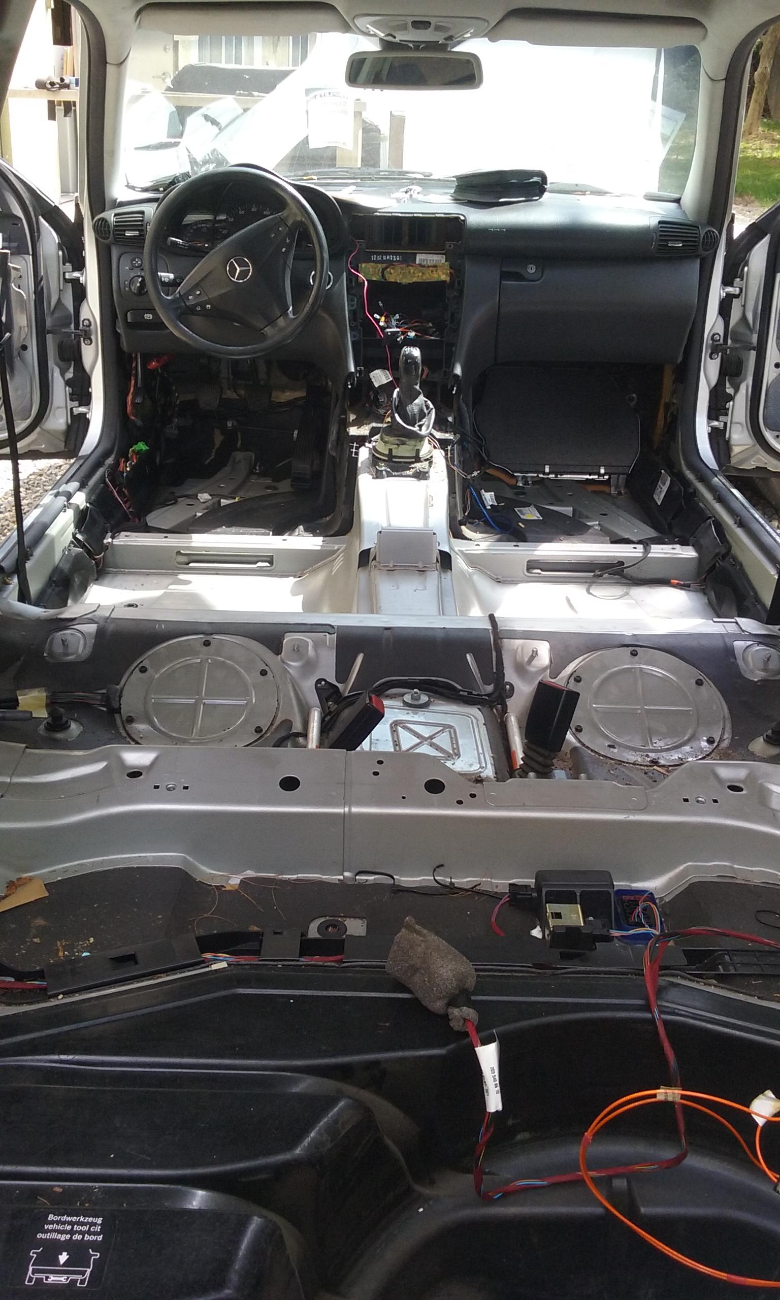

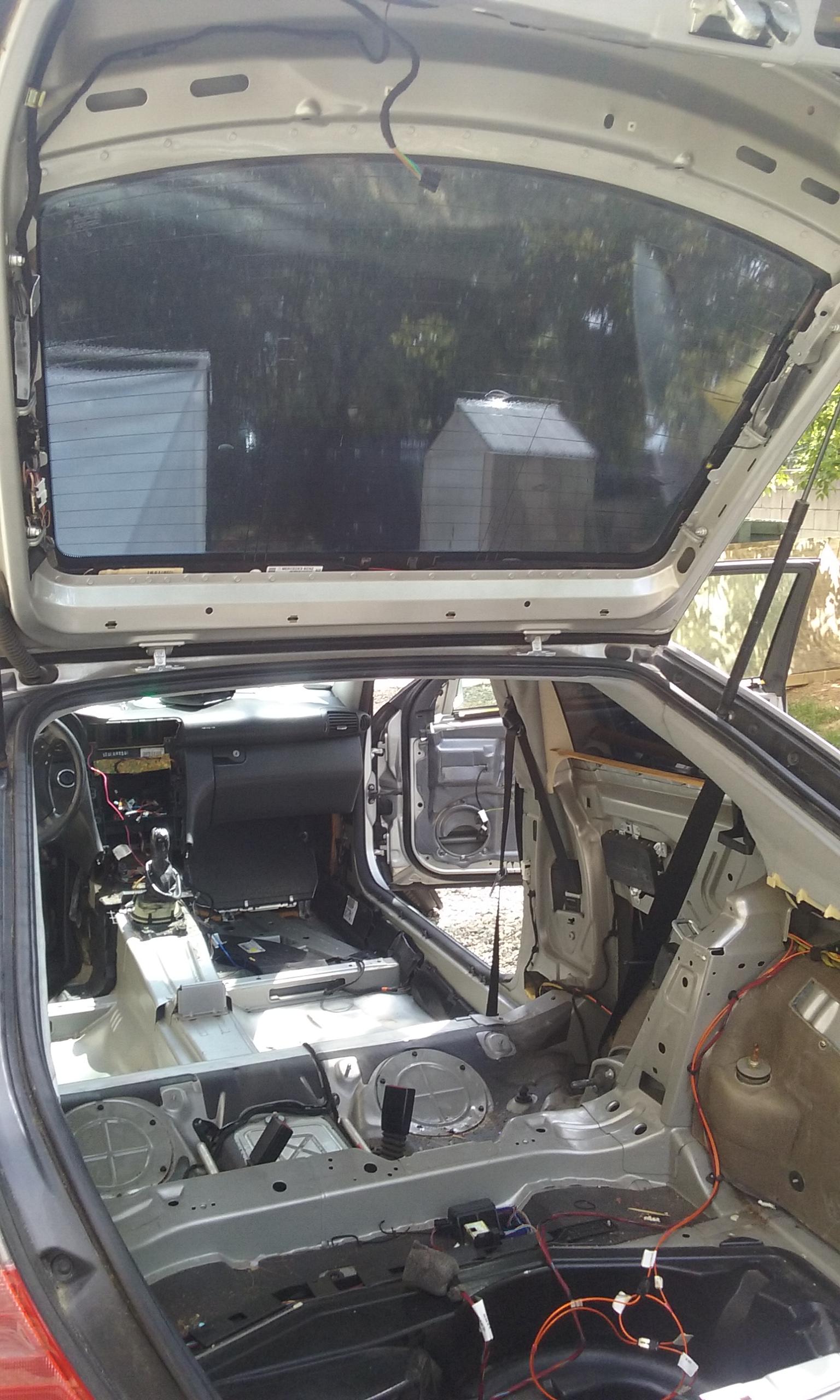

Ok...nowwwwwww were cookin!!! Everything but the main dash and the headliner have been removed. Fuck it. If you're gonna do it, do it right huh? :)

Thanks bro. I had to do it this way or I would have had stupid shit probs all the time. It's nice to see what's actually there. I know for sure Im gonna lay a shitload of mat and prob some of that spectrum sludge as well.

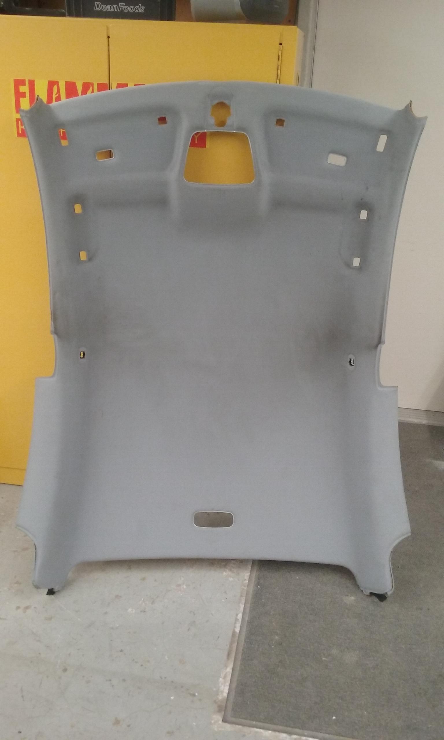

Got the headliner removed tonight so its completely ready for sound deadening.
I'm thinking of using CLD with CCF/MLV combo on the entire floor, doors, and side panels. Then use CLD  with a radiant heat barrier under the headliner and hatch. I'd also like to hit the bottom side of the floor pan with spectrum but that can wait.

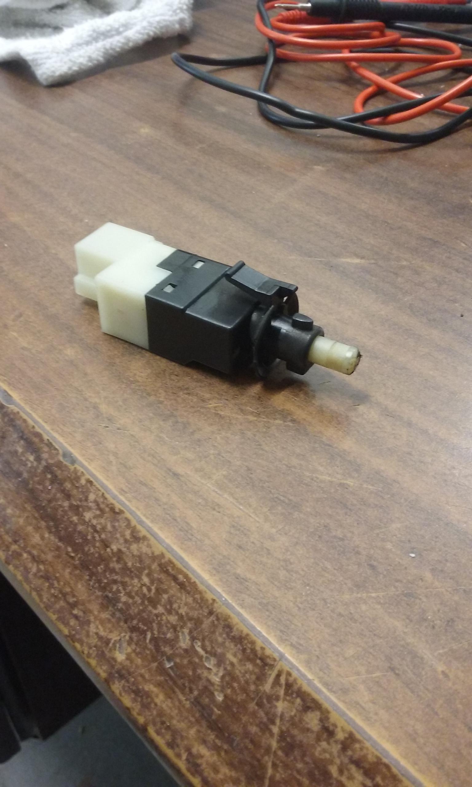

Got my brake light switch in and installed that today. Seems like the old one was definitely broken. There was a small peg that was supposed to spring back but it would get stuck. Havent tested it yet since the car is torn apart and the batt is disconnected. Went on to the trunk release latch prob and figured that out. Not sure how to fix it tho. Its the small button inside the green housing that is supposed to click when it is depressed by the metal arm that comes down. But when the arm comes down, it wont push the button in far enuf to make it click. I cant see how either the metal arm or that tiny plastic head have been worn away. The tip of the sensor looks normal and no wear pattern crossing down on it. I've heard of people gluing shit to the sensor tip but that sounds ghetto. Idk but i guess i buy another sensor and see what happens.
My horn works now!! That switch did something for sure. I haven't been able to drive it yet since its taken apart but I moved it the other day and accidentally hit the horn while pushing the car. Shit surprised me since i'd never heard it work before lol. Forgot to order a new switch for the trunk release but I did order a few things to keep me busy for awhile.

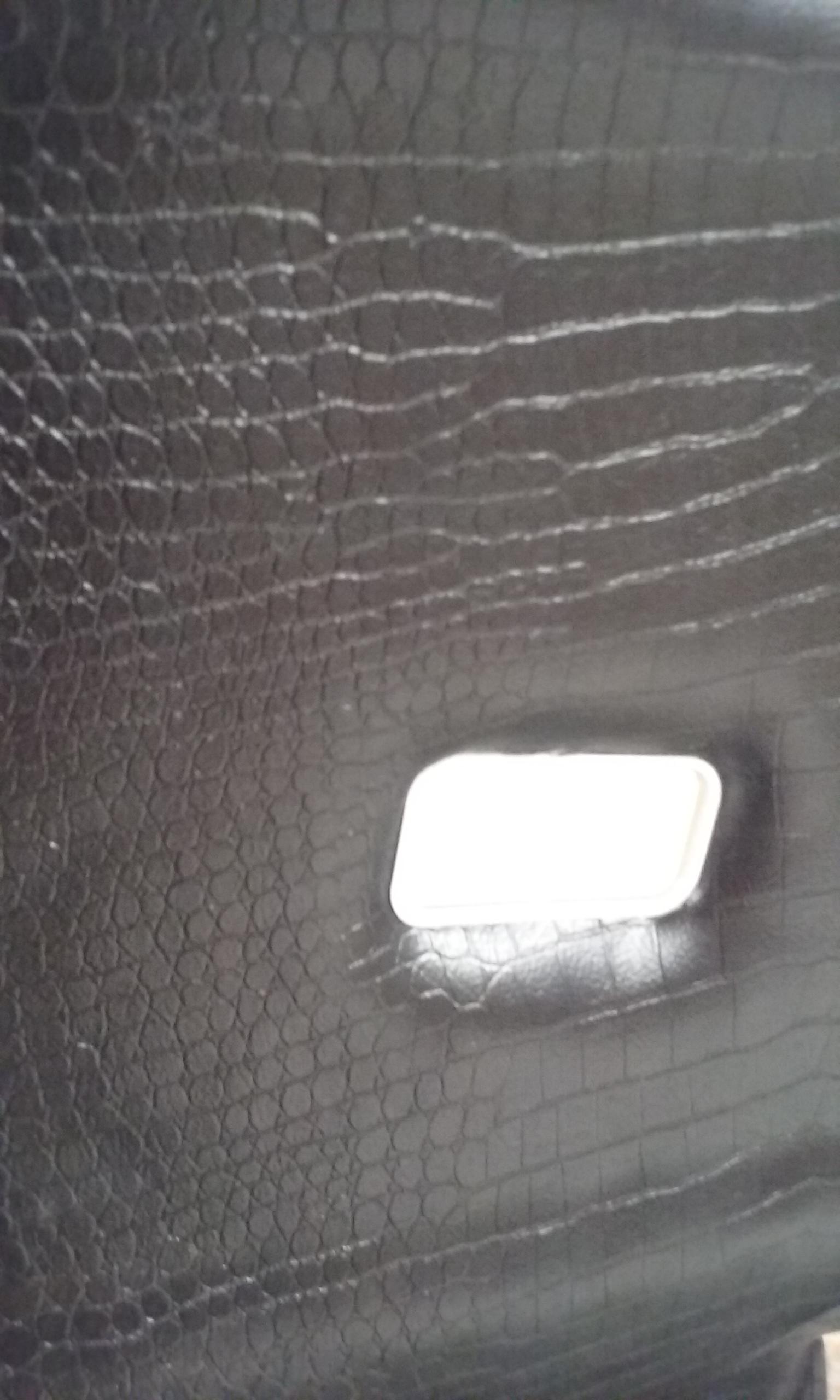

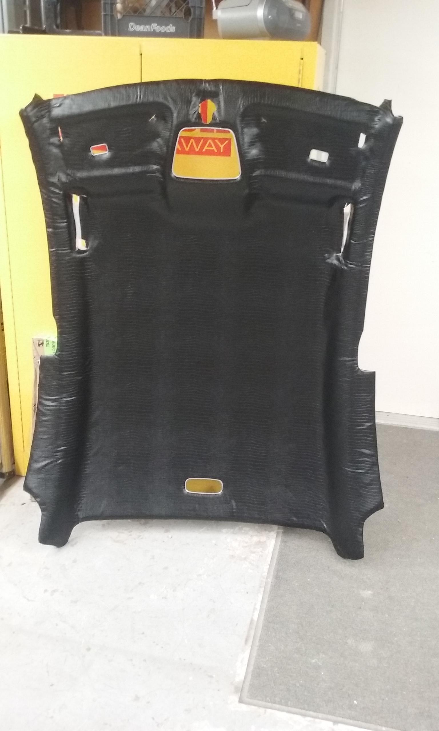

I recovered the headliner today. Made a few mistakes along the way but overall its not bad. Learned my lesson on a few things if I ever try this again. Wasn't too hard either. Two people would make this job much easier. If you try to remove it once you laid it down on the glue and have too thin of foam it will rip that shit right off and you are basically stuck at what point it has settled into. Get thick foam like at least 3/16" thick and if you get fabric w/o foam attached already, make sure you join those two layers together instead of trying to apply one at a time. I knew I should have done that but I took the advice of my uber crafty gf and didn't stick with my gut feelin lol.
