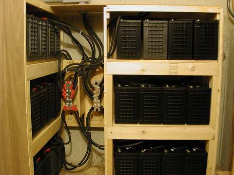

ok, i'm gonna try and break this down for car audio use so lets try and tackle this together...
4 amps.. they need to be fused.. alternator, will be fused right before batt bank.. and 6 batteries in the bank.
So, all 4 amps will run to it's own custom block, correct?
Each amp will have it's own fuse, so let's say 1 fuse per amp, 4 fuses.
these 4 fuses will run to a common custom block, correct?
From this custom common block, it must make contact with the battery bank...
So how do we go about it from here?
Looks like all the same series wiring...just differents spots to put main pos and neg. Same output...
This thread is to get equal distributed output to greatly prolong or get better voltage at the equipment.
Well the block you speak of could be a buss bar.
Or you could have multiple wires coming off of the batts instead of just one. going to each fuse holder then amp.
see that's the thing.. using multiple cables from the battery bank to go to each amp will result in non-distributed output.
unless i can get 8 of these batts in there which i highly doubt... i'm just gonna have to wire it like everything else.. tons of cables and tons of grounds everywhere.
or you know what, i'll contact XS power and talk to them about this wiring diagram and see if they think running ~2,400A to the same post will still work or not.

i love seeing the actual math and theory behind the real life results of things sometimes. the original link was great. somewhat difficult to apply to a massive set up, but i think i should be able to figure it out with my 6 batts and 1 big amp.
i guess my only thought is, i would have the alt charging on the same pole as the amp is drawing from. its all going to the same place at some point, but it seems logical to me to have whatever current you can get from the alt headed straight to the amp in order to get maximum potential out of that.
^^ I agree about the alternator str8 to the amp
