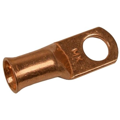

This is my guide for those of you that don't want to spend the 7-10$ a piece for ring terminals. IMHO the connectors I made are just as good, if not better then a lot of the ones Ive seen.
I hope this helps someone, Enjoy.
Here are the steps:
1) cut a piece of copper pipe into 2 inch lengths.
2) put the piece into a vice and squish half of the pipe flat.
3) use pliers to squish the open end back to its round shape (rather then oval)
4) place in vice again and drill a hole in the center of the flat area. (may need to use a center punch)
5) USING PLIERS AND SAFETY GLASSES. round off the flattened end and put a notch into the front of the rounded section.
6) put in your 0 Gauge and squish it in the vice.
7) using a torch (works best) heat it up and fill the hole with solder. let it cool.
8) using shrink wrap (if you can find some) or electrical tape, cover it up.
