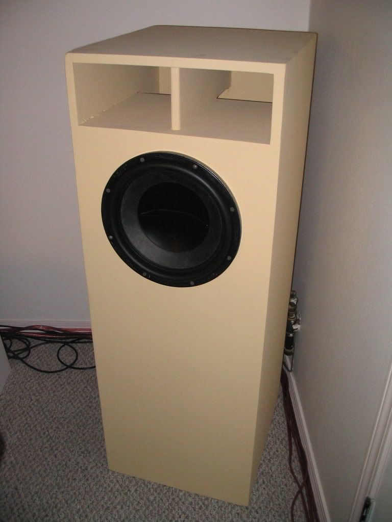

March 22, 200619 yr kent you know if you build this and it works out I am going to probably immitate it, since I had thought about doing this in the past and I am going to have to find a smaller lower power solution for Amanda<{POST_SNAPBACK}>i think a lot of us are waiting to find suitable plans to build such an enclosure<{POST_SNAPBACK}>I've got plans for a pair of 8's in a tline modeled after my ADS 3 series. They have a higher fs so the plans wouldn't work. I'd draw up some plans for a single RLP 8 if ya all want, prob something like the photos I posted already. I like the driver to fire out of the same side as the port. But as far as getting it underneath a seat with lots of curves and stuff that will be really hard to plan in advance. I think a fiberglass TL under a seat would be super sick. I've seen plans for 8 8's in a tl that fits into an extended cab truck! that would be sweet.

March 24, 200619 yr Author kent you know if you build this and it works out I am going to probably immitate it, since I had thought about doing this in the past and I am going to have to find a smaller lower power solution for Amandai think a lot of us are waiting to find suitable plans to build such an enclosureI've got plans for a pair of 8's in a tline modeled after my ADS 3 series. They have a higher fs so the plans wouldn't work. I'd draw up some plans for a single RLP 8 if ya all want, prob something like the photos I posted already. I like the driver to fire out of the same side as the port. But as far as getting it underneath a seat with lots of curves and stuff that will be really hard to plan in advance. I think a fiberglass TL under a seat would be super sick. I've seen plans for 8 8's in a tl that fits into an extended cab truck! that would be sweet.hook me up with the plans, please!! i'm extremely anxious to get this done...be it FG or mdf...i just need plans..lol...wheeeeeeeeeeeeeeeeeeeeeeeeeeeeeeeeeeeeeeeeeeeeee
