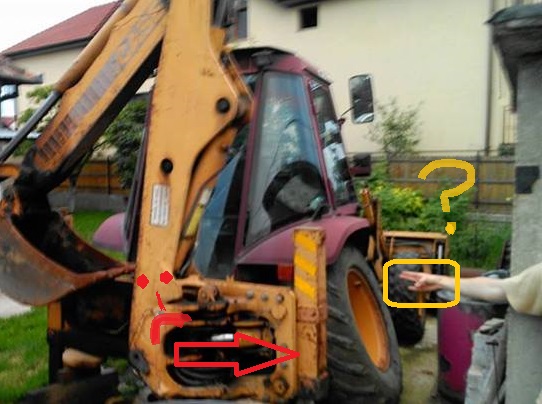

After some wrestling, cursing and struggling the backhoe rear axle is assembled. Hopefully 2 pesky o-rings were all it took to fix the brakes.
70 cent part holding up a 70k machine. Priceless
More like 2 $15 parts,holding up a 15k machine. One 10" o-ring and one 12" one.  Transmission was lowered on a jackstand, axle was removed (150+ lbs beast) and dragged out on wood blocks.
Repair manual calls for the entire transmission to be take out of the machine. Biggest issue is putting the axle back on, as the brake assembly (piston, pad and rotor) all want to drop out. And I first put the axle upside-down. Then I forgot I could lower the transmission even more to clear the frame. And I had to slide the axle in position on wood blocks and patiently lift it up by any means until I can use some old head bolts to align it.
I should get the wheel back on today and take pictures to put it up for sale. Pity I didn't have any jobs to do with it after I changed the windshield. All my latest experiences were with a scratched up plexiglass windshield :(
