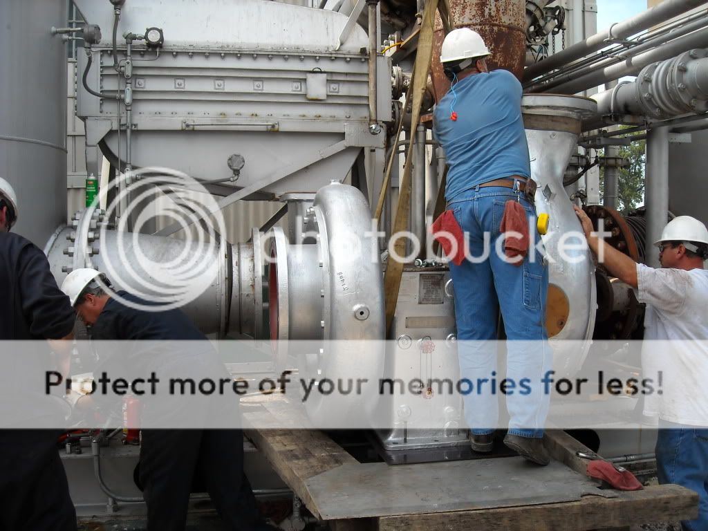

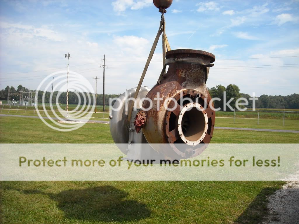

Here, use one of these turbos.

lol....
I would go with twin turbo's.lol
Pictures, videos?
Is that for a gassification plant?
Very close, it's for a Clark TLA-8 Integral engine/compressor for natural gas compression on the natural gas transmission pipeline that I work for. They're rated for 2700hp, have a 17" bore and 19" of stroke which puts them right around 35,000 cu. in. of displacement.  They're also a 2 stroke engine and run on the natural gas from the pipeline.  An integral engine like these is referred to as such due to the fact the compressor connecting rods are integrated with the power piston connecting rods.  They share journals on the same crank shaft.

No videos, but I do have a few pictures of several of the different engines we have on the pipeline.
