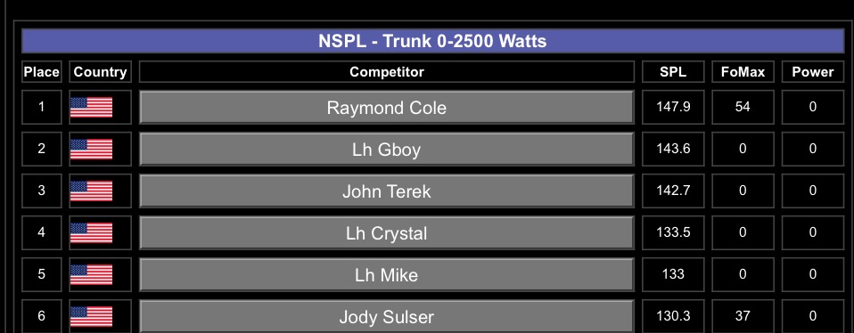

Finally got time to have fun! Box is 1.3c/f tuned to 50hz with a full length 6" PSP port.
Did a 147.7 @56hz outlaw, 144.5 @53hz sealed up.

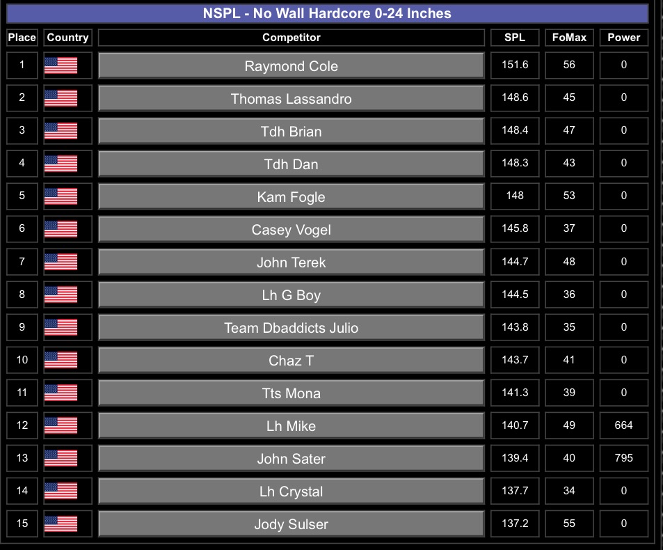

Hit up a show yesterday! Put in the old Tantrics back in for good measure ended up doing a 151.6 @56hz before the dust cap launched. No time for a retry.
