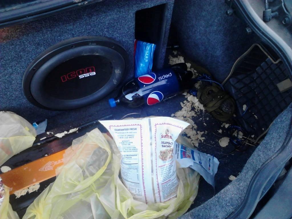

Posted December 4, 201312 yr So I had my system down for two days.One to upgrade my power wires and grounds.2had to get ruffles out of my speaker box the bag got pulled in an destroyed them chips every damn where lol.but anyway during this time I noticed the 6x9's sound like ass.like the cones were busted I haven't looked.just wondering if pressure in the trunk may be able to do this? Edited December 4, 201312 yr by garychurch84
December 4, 201312 yr It absolutely can and will. Trunks don't generally allow for great air transfer into the cabin, basically sealed. When you generate that kind of pressure in a trunk it's going to press on every surface and the weakest surface will flex more than the stronger ones. The cones and suspension on the 6x9's are considerably weaker than the steel of the trunk walls and anything else that happens to make up the construction of the trunk.
