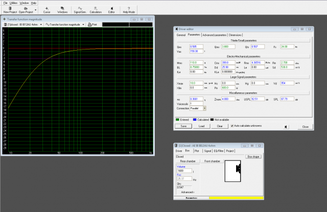

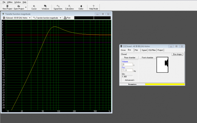

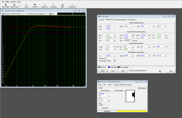

These are the AE IB12AU 4 ohm driver. The first is plotted as if you built a .75 cu ft pod. The second is plotted as if your door was 2.5 cu ft and truly sealed. The third is for a 5.5 cu ft box as that is the equal VAS of the driver. The forth is 3x the drivers VAS. The fifth is 10X the drivers VAS. The forth and fifth are closer to if they were truly IB as in open air with only a baffle and no dampening.

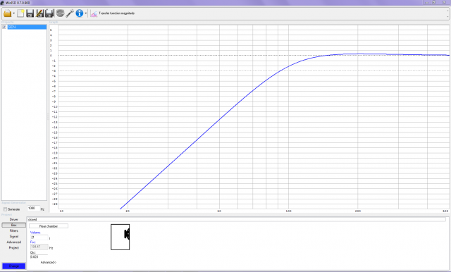

Now on to the DX. I got frustrated with the WinISD Alpha Pro so switched to the WinISD.7 Here is the TD12X graghed out for you.  http://www.aespeakers.com/drivers.php?driver_id=7
First is a .75 cu ft enclosure. This has a Qtc of .823.

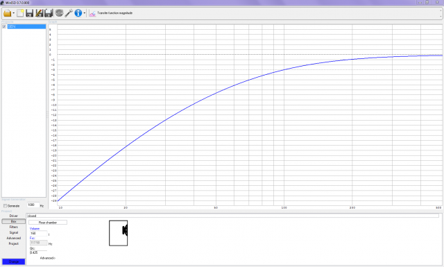

Again in a 5.65 cu ft enclosure (1xVAS) and has a Qtc of .425

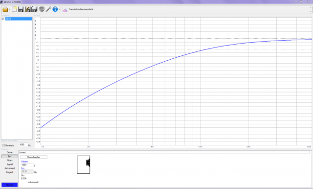

Again in a 17 cu ft enclosure (3xVAS) and has a Qtc of .345
Again in a 56.5 cu ft enclosure (10xVAS) and has a Qtc of .308
The formula Impious gave us will show where the driver starts to roll off on the top end. As the roll off is minor in regards to db loss I take this as just a reference also. Eventually the mechanical noise will become louder than the output though.
"A driver's inductance and resistance create a classic 1st order (6db/oct) lowpass crossover. You can determine the corner frequency with the formula."
Frequency = Re/(2*Pi*Le)
*Le in henries
Oddly going by inductance, the DX will start rolling off at 1433hz. And the IB not until over 2500hz. Hopefully Impious can explain how this formula translates into real time. As I have found this formula does NOT correlate with manufactures posted FR graphs. I understand that the coil is part of the circuit just like a coil in a xover. I even remember back in the day, ppl using store bought rolls of wire left on the spool for sub xovers. How acurate it was we will never know. lol
