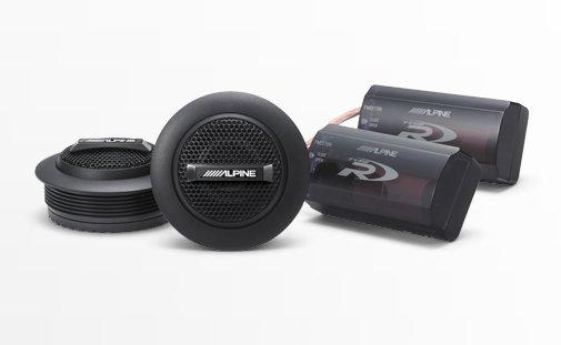

I'm sure all of us has heard the emphasized S sound. The high-hat that makes you blink every time you hear it. I have always heard that tweeters tend to be personal taste and vary person to person but man is it hard for me to listen to a blaring titanium or aluminum dome tweeter for a extended period of time.
I'm looking for some supplementary highs that are "smooth" so to speak. I have been very impressed with silk dome tweeters but i'm looking for other suggestions.
They can't be like 25 watts rms too. I need a reasonable power handling
Anyone care to share what they have in there ride?
http://www.sonicelectronix.com/item_46848_Alpine-SPR-10TW.html
^^ What im looking at
post-47774-0-06453200-1389851436_thumb.j
