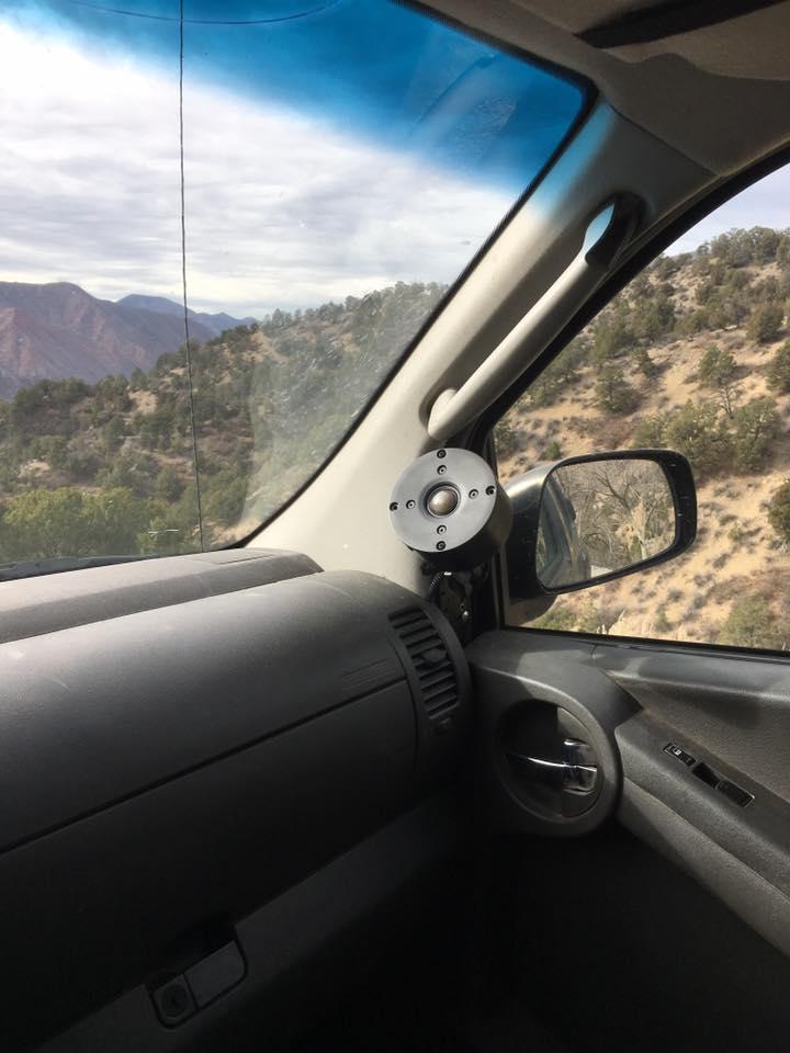

Hope you don't mind me posting pics in your build.
I did the PVC cups also. These are the adjustable Ram mounts I used. Excellent for fine tuning the aim! They are available in a ton of different sizes and lengths. Possibly worth checking out.

Those mounts look sweet. thanks for the suggestion!
I trolled eBay and got them on the cheap. Very stout and don’t move.
