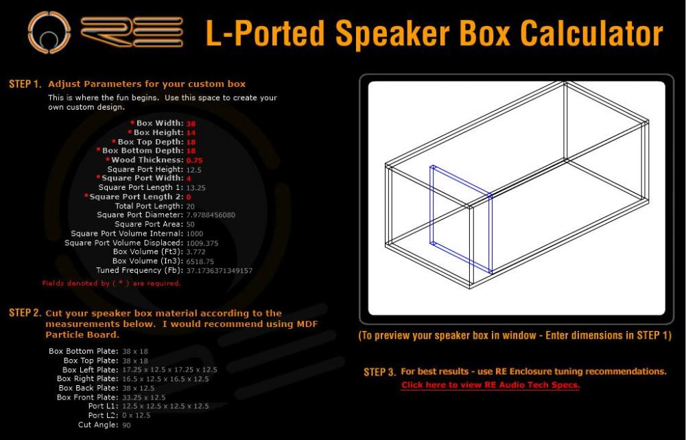

I am working with limited space, so I am trying to get the most bang for my buck. I am considering running 3 10" HDC3's at 1.3 ohm, on approx. 1.5k to 2k per sub. I worked this design up on the RE box calculator. Would this be a good enclosure for these subs? This is basically my max dimensions for the enclosure.
Download torres calculator. RE calculator is not good to use for starters.
